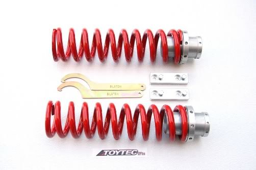

    how bout these

    This is what I got with the 5100s. I like the fact that they're adjustable. So if I put heavy ass bumper on, I can just crank it back up! :)
    With that said, I think the OMEs have methods for adjusting the height, just not like this...

    Yeah, you have to compress the springs to get them in. Don't get me wrong - for adjustables, I still like the ones I have... Just trying to point out that the OMEs "can" be adjusted.
    On a side note, have you ever tried to adjust the adjustable coilovers while they were installed on the truck? it's practically impossible! I had to adjust mine a couple of times and I had to take them off to do it. But didn't have to compress the springs though... :)

    I haven't, from what I've heard you just need to take the tire off, loosen the little nut that holds the collar in place and use the spanner wrench to adjust it.

    I think that's how it's supposed to work, but practically speaking, I couldn't make it budge AT ALL!
    Essentially, when you turn it, the shock spins with the collar. But when the shock is bolted to the lower control arm, it can't turn, making the collar infinitely harder to turn because of the immense amount or pressure from the springs.

    ToyTec's website says:
    Will not work with factory shocks on the 03-09 4-Runner or 05-09 Tacoma.
