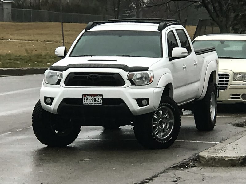

    So my current set up is Bilstein 5100 all around set at 2.5" up front on stock springs with 1.5" AAL in the rear. I'm happy with my lift but just need that little more, feel like it's not tall enough.
    Would TOYTEC or OME springs give me more than 3" of lift? I don't want to use a block in the rear, what are my other options for the rear? I know I'm going to need UCA's.
    Any input would be greatly appreciated!
