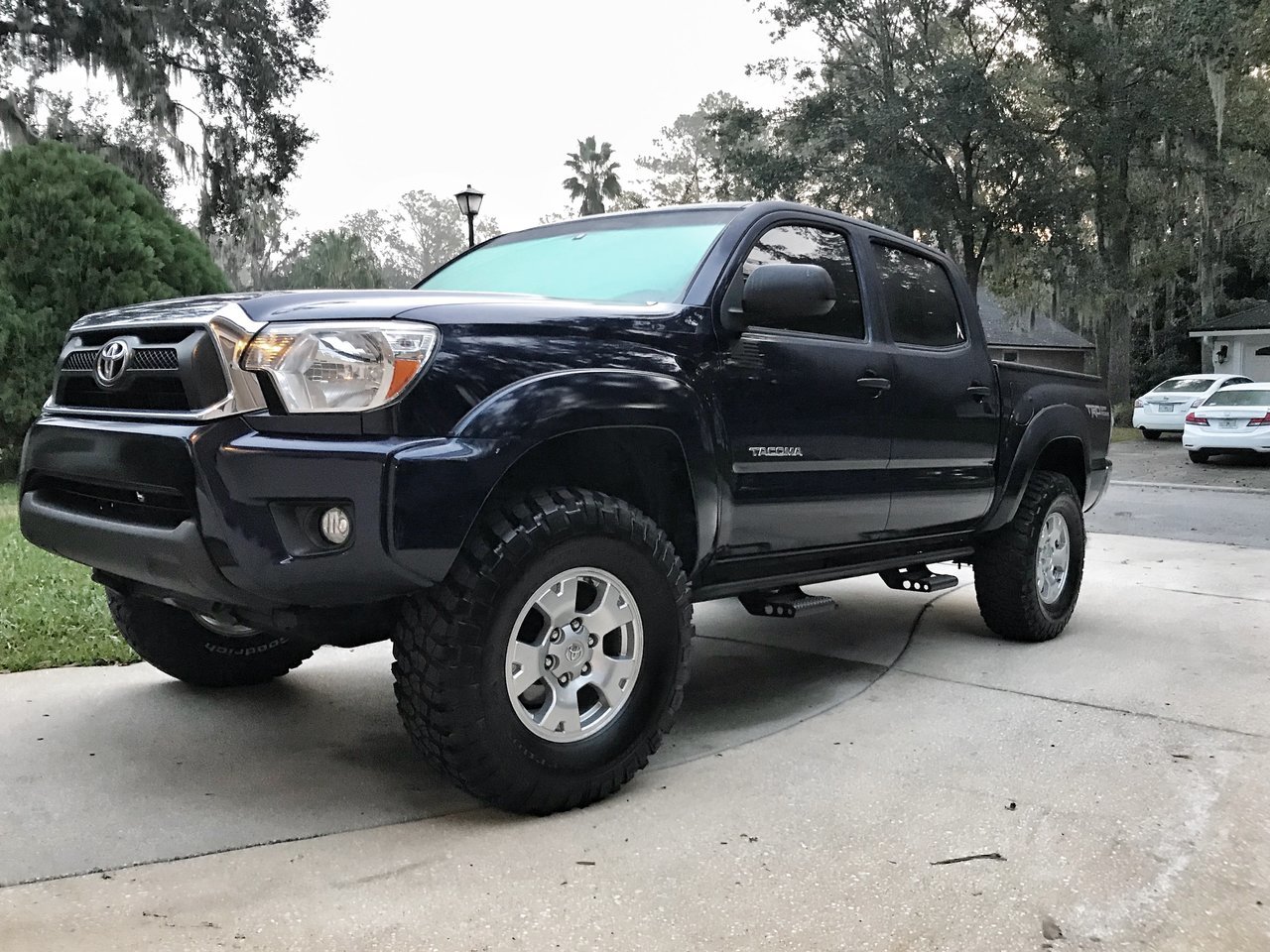

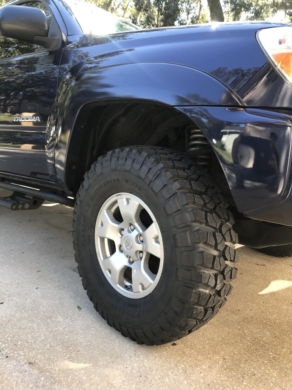

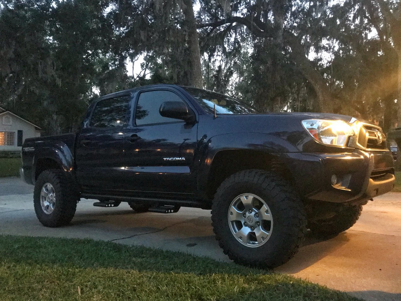

    What's up guys? I'm itching for more lift but am not sure if its possible to add on to my current lift or if I should buy a new setup all together, OR NEITHER. See below for my current lift setup with pictures and comment if you know of a way. Thanks!
    Truck: 2012 TRD Off-Road 4x4
    Tires: 285/75/16 BFG KM2
    Front: Bilstein 5100 set at middle setting & eibach coils
    Rear: 1.5' blocks

    I think the easiest way would be to go with ome 887 springs on front set bilstiens on 0 and put a 2 inch block in the rear or put in a new leaf pack.

    If I put the 887's on with 5100's at 0, what overall height would that give me up front?

    Get a drop bracket.

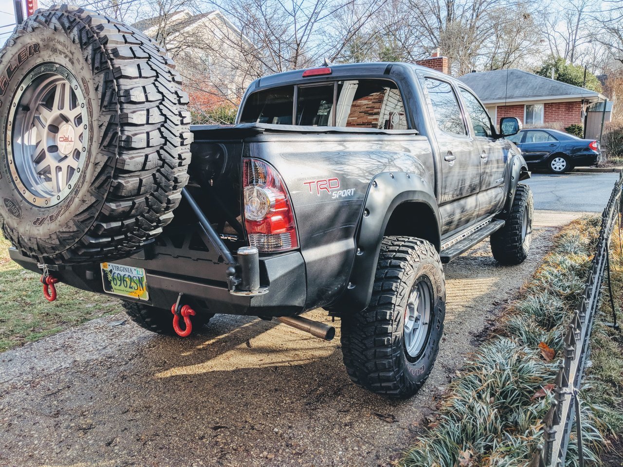

    Toss a 1-inch body lift and 35s! But be prepared for some carnage to make it fit.

    I went with Toytec and have been happy. A lot of folks really like 4crawler. Their website was too confusing for me, but they make a really safe product I hear.
    The install was easy-ish. It took a while (longer than coilovers and UCA's for me), but nothing about it was hard. I've been meaning to do a build thread forever to explain how it all went. If you go with Toytec, I would be happy to answer any questions you have.
    One downside to body lifts is they leave your bumper sitting a stock height since it's bolted to the frame. That wasn't a problem for me since I had bruteforcefab make my swing bumper to accommodate the body lift.

    I see that your 4x4 and you really can't go over 3 inch lift on suspension without a drop bracket lift. That cuts a cross member out so the front diff can come down to factory angles. @KTJO 4x4 has done it on her 3rd gen.
    The 887 springs may take you to about 3.5 inches.

    No. With a drop bracket, you can lift 6" on stock front suspension. You could do a 2-4" DB and add a mild suspension lift to get you where you want to be. Wide 33 or larger tires will still require a cab mount chop and maybe some other trimming.
