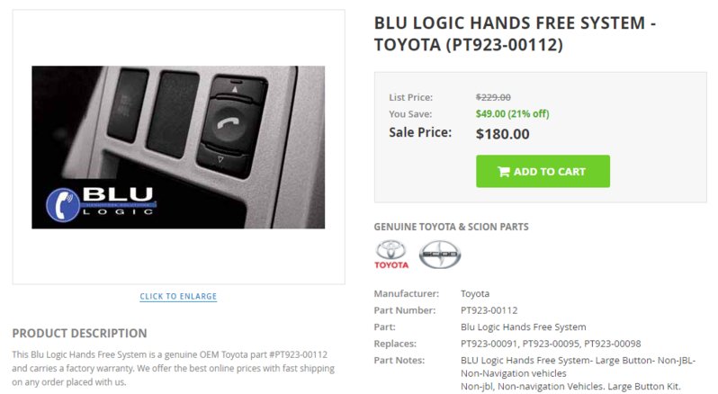

    There are two Toyota OEM solutions created by Blu Logic, both function the same way the only difference is the button size included. This plugs into a port in the back of the stock non-jbl radio. When a call comes in it will interrupt the radio. Caller's voice is played thru the speakers. Easy plug-n-play solution, I've been using Blu Logic now for 2.5 years with a few android phones/tablets and it's always worked flawlessly for calls and streaming media.
    PT923-00112 : This is the small button kit. If you had a TRD Offroad this would be the kit you'd wanna buy as the button is sized to fit under the radio, next to the cigarette lighter.
    PT923-00098 : This is the big button kit that replaces one of the blanks on the dash, left of the steering wheel (where the RSCA, Fog Lights, 400W Inverter, VSC, etc).
    If you can't find install instructions, let me know and I'll attach the pdf for ya. If you happen to want the small button but only come across the big button kits, shoot me a pm cause I'd be happy to trade my small button for a big button. The buttons are interchangeable.

    i would like to get the large button cause i like that it sits to the left of the driver but when i searched for PT923-00098. the part would come up but it would say that it was replaced by PT923-00112. which you said is the small button
    http://www.toyomotorparts.com/parts/toyota-pt923-00098_bluetooth-lg-button.html

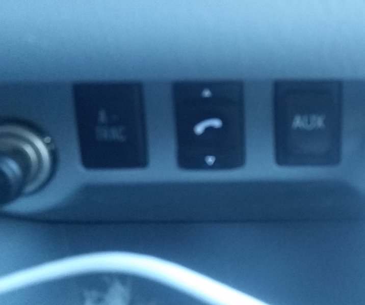

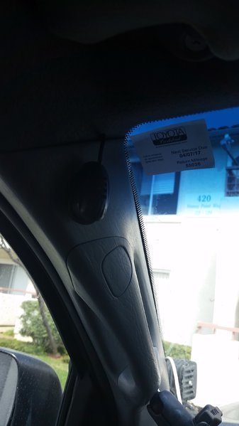

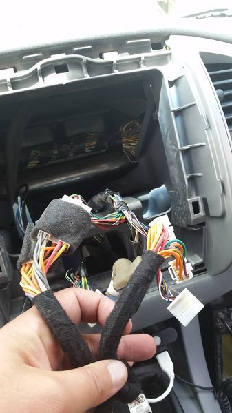

    Here are some images from my install (for reference) of what it all looks like. The mic is the only thing that sticks out on the pillar and there is plenty of cable to mount it some place else (like near the mirror if you want).

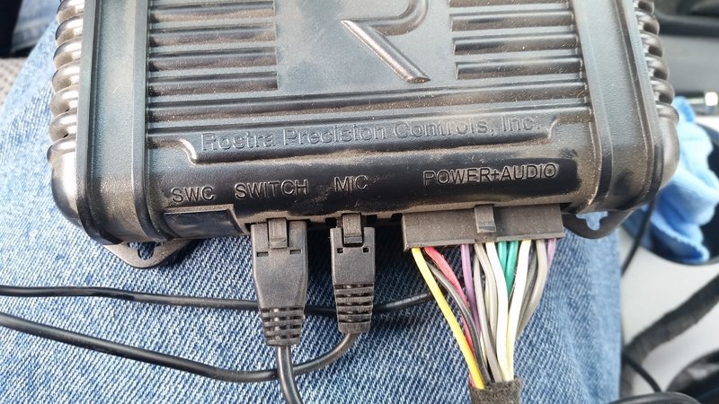

    Hey @sjwhitaker, can you take a photo of the mic connector wire plug ? I'm looking for a replacement and wondering if the Blu Logic and the Rostra I have are compatible.

    The blu logic has a 2 wire mic jack. The rostra needs a 4 wire jack for some reason. Went through this myself. I found a 4 wire mic on Amazon for 24$ last month

    Your question was already answered, but here's a pic. I'm Rostra's director of marketing if anyone has any questions.
