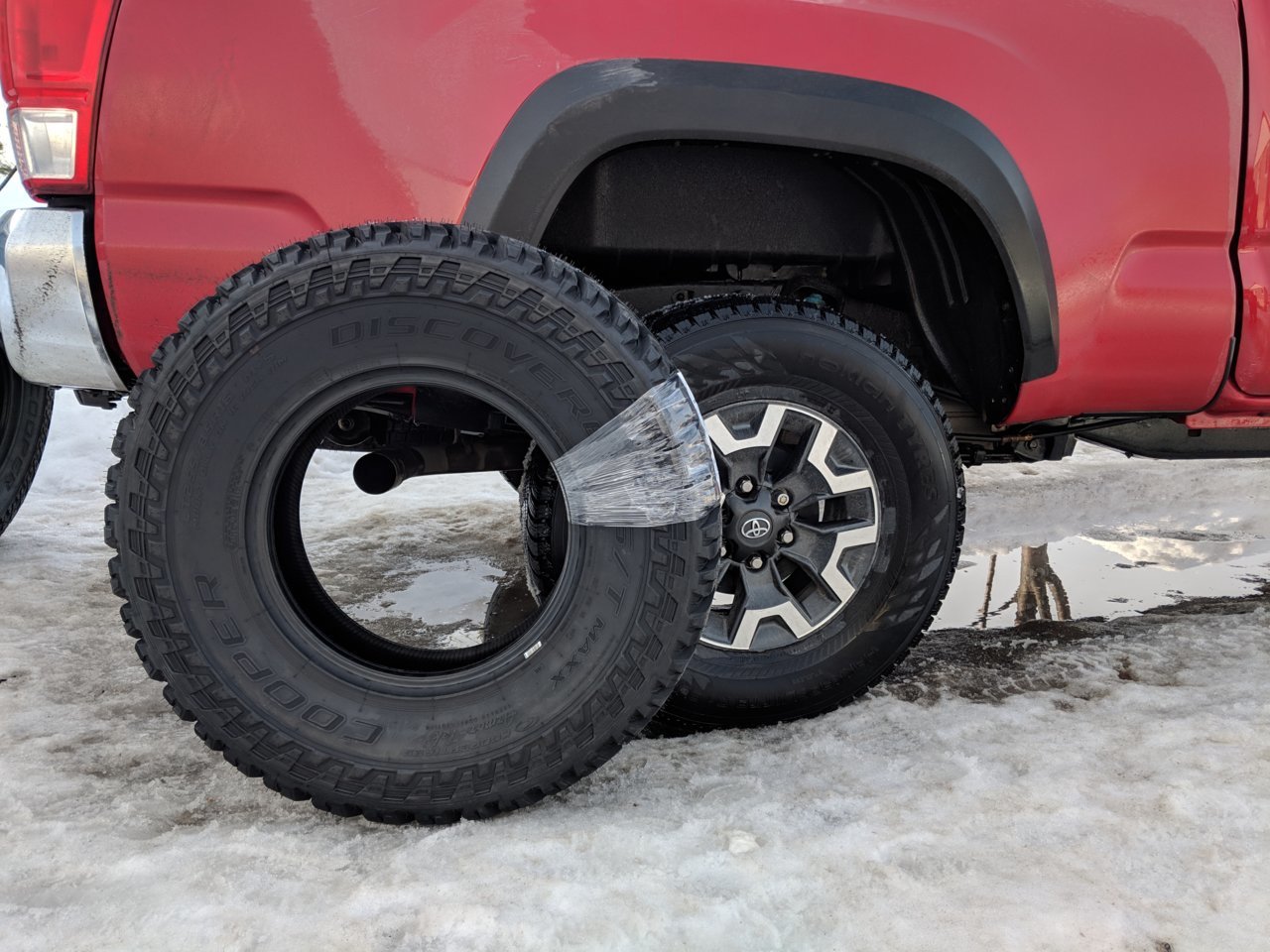

    I second this. I did this and I have no issues with clearance at any angle or compression with no lift and stock wheels. The only issue I could foresee having is a bit of fender liner rub if I went with a lower offset wheel. Plus they look great and isn't that all that truly matters? :rofl:
    The photo is pretty skewed now that I look at it, the ice was uneven in the driveway making the 255/85R16 look massive.

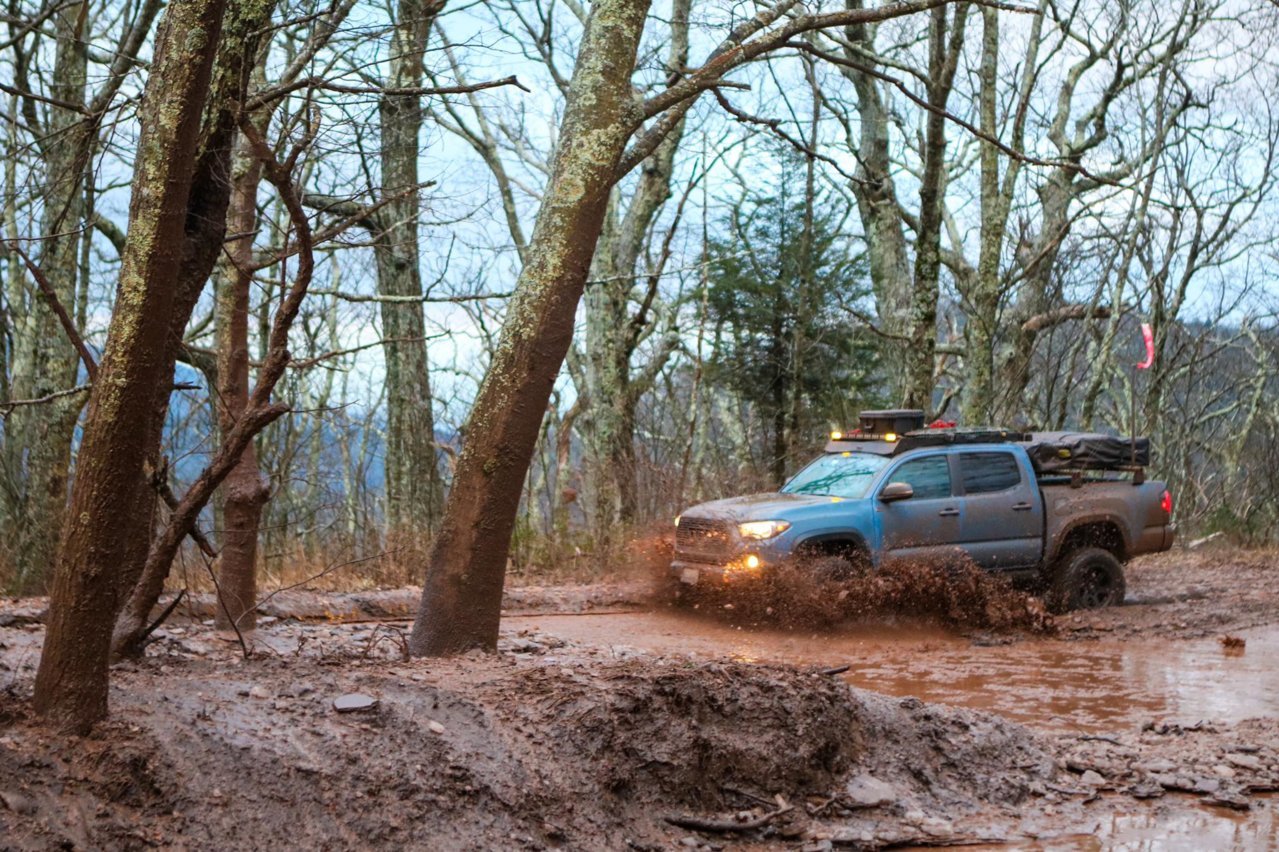

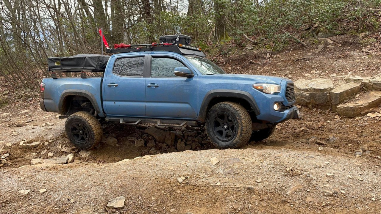

    I'm running 285/65r18 (33s) on an ICON stage 4, plus their RXT Leaf Pack at option 3 (highest). My rims are 18x9 with 0mm offset and 4.5in backspacing. I did a CMC in the front and VERY MINOR trimming of the plastic in tire well. No rubbing at all. I hope this helps. Feel free to as questions or message me.
    Rainman91[QUOTED][OP] likes this.
