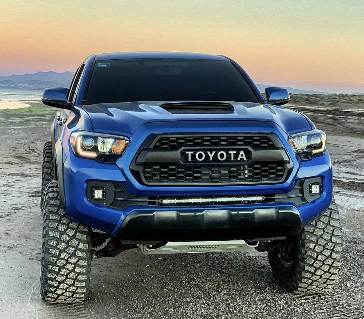

    This would be neat, but I think I would have to lift the truck too.

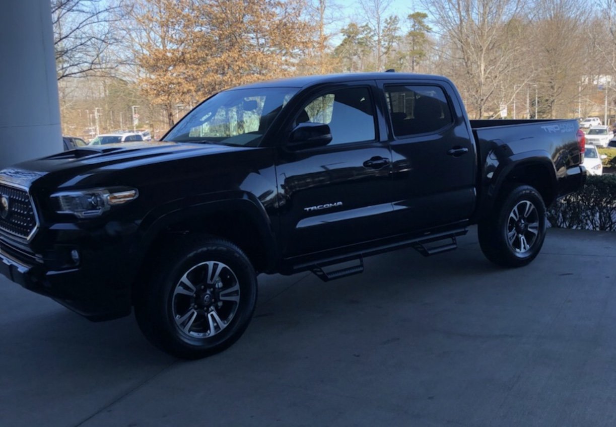

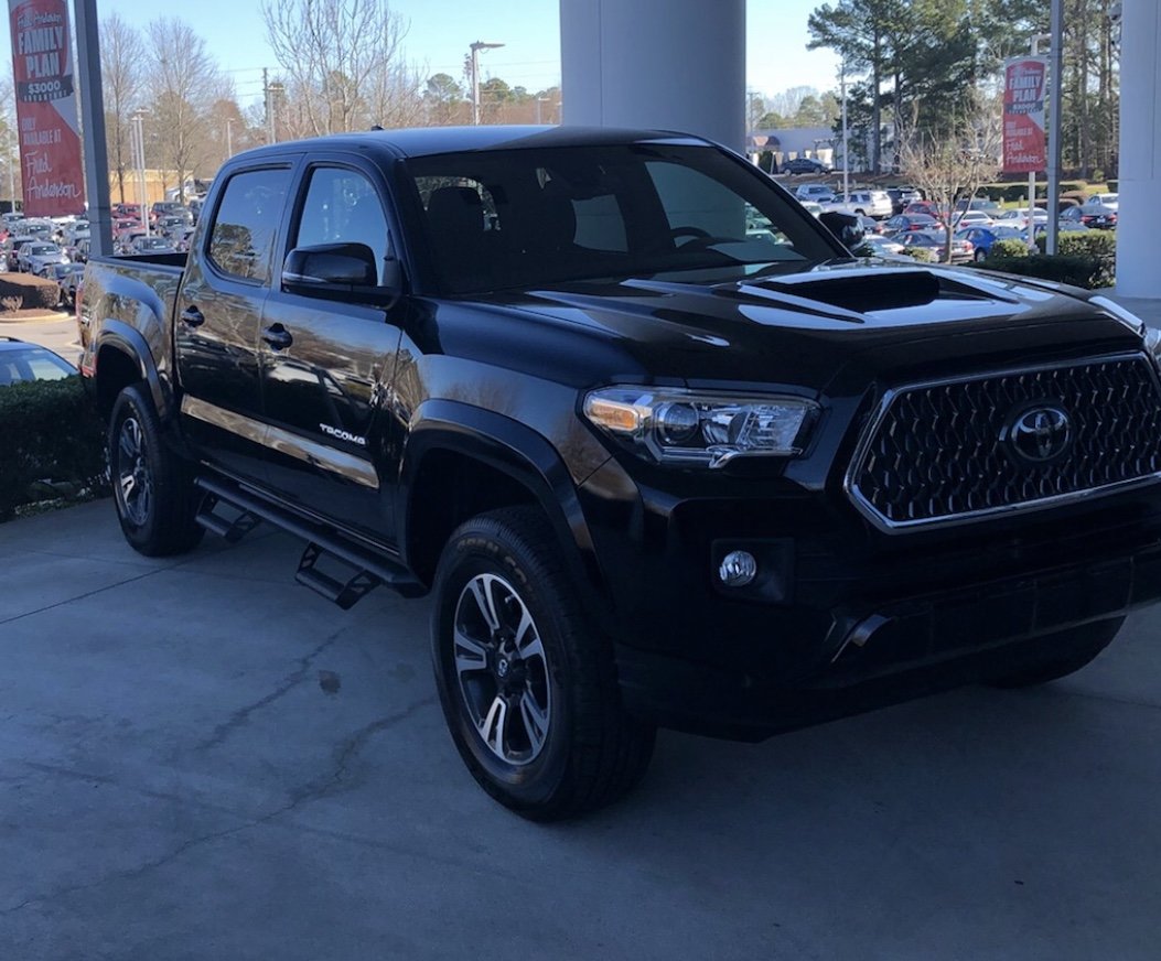

    My truck currently

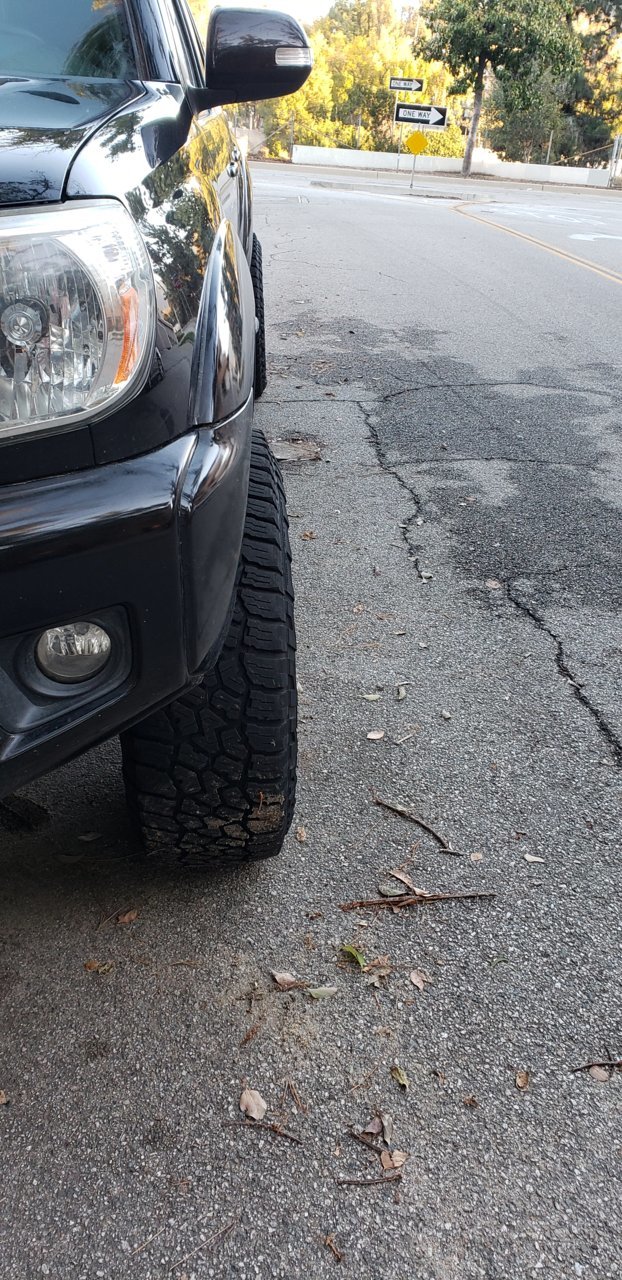

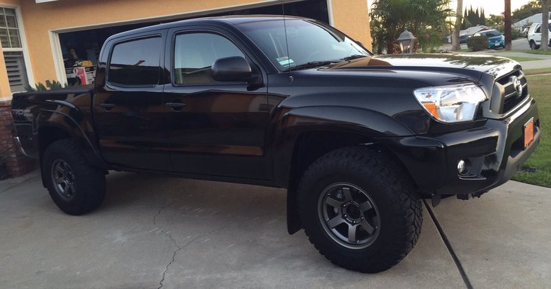

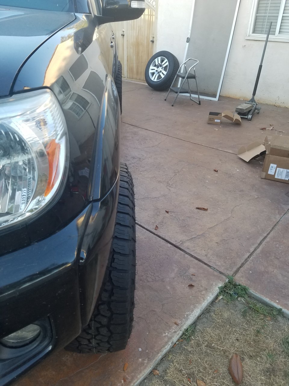

    These are with my rims that are 0 Offset.
    Here's with 1.25” Spidertrax:
    And with .75” Boras
    These spacers aren't "cheap," they're quality metal and machining, they're hub and wheel centric, so they won't cause any vibes.
    I meant cheapest, as in, they're way cheaper than buying a new set of rims.
    Nice truck btw. I think it would look pretty good with the stock wheels and 1.25" spacers, if you don't want to buy a new set of rims right now, but still want the wider stance.
    If/when you get new rims, that have a smaller offset, you can sell the spacers if you don't want them anymore.
