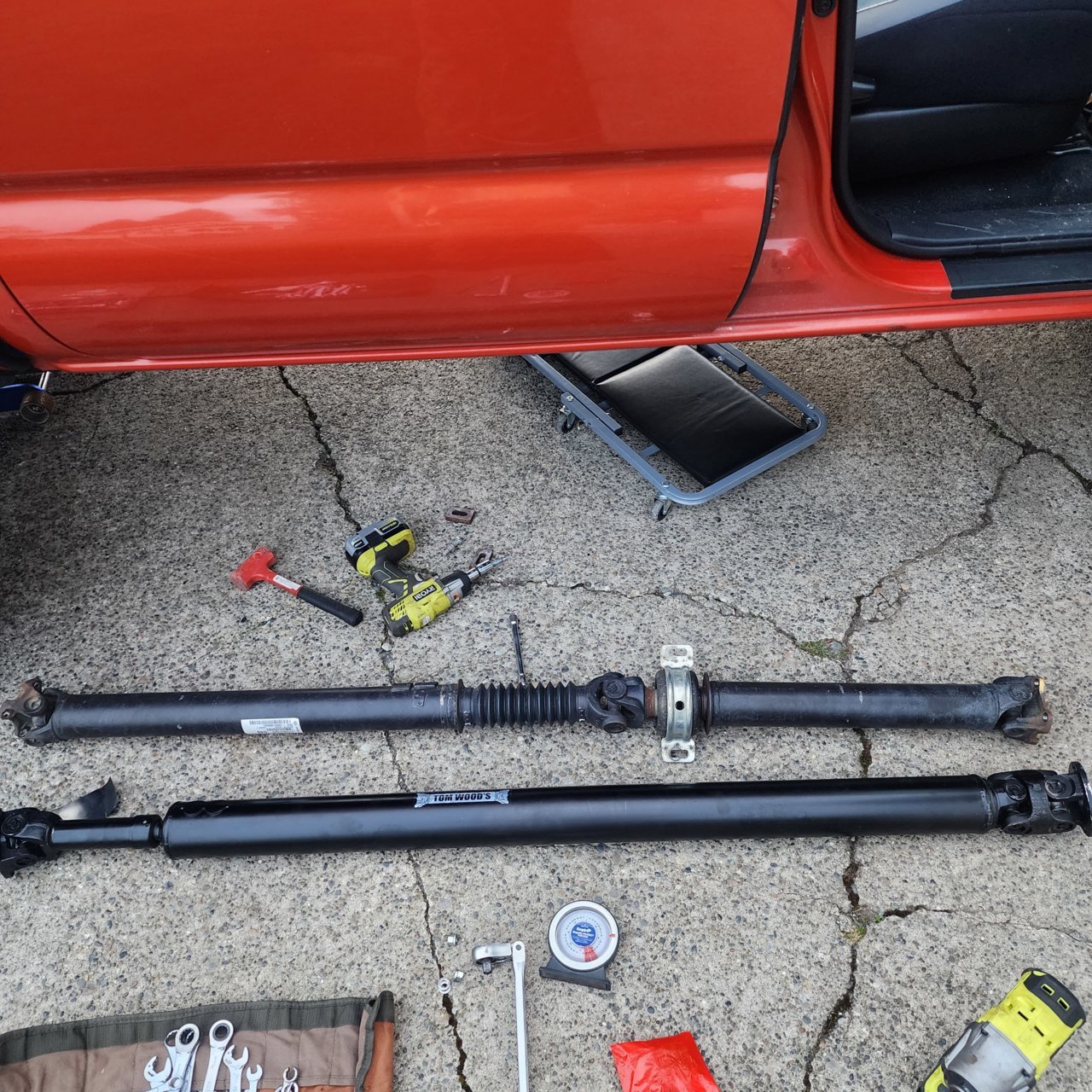

    Test drive done , OMG it's like the truck feels new and tight again. Crazy how sloppy 200k miles feel. What else I can feel is the axle wrap , for sheezy. The axle wrap isn't too bad but it's there . Now to get that RAS suspension system next week . That's the deal breaker for me .

    Double check your carrier bearing. Maybe even replace it.

    Wow...200K?
    I'm only at 41K...
    Just bolted it on; no pinion angle adjustment?

    Nah carrier bearing was fine worn but fine . The spline shaft was on its way out . You could feel the slop in the splines when feathering throttle in traffic .

    Well I took my magnetic angle finder and from back to front it's within 10°. I need to find what degree stock is so I can possibly shim the rear end . Probably need to get a shim kit . What is the stock degrees on shaft anyone know if not I can run to the dealership tomorrow and throw my angle finder on a new Tacoma and find out .

    No vibrations , just was feeling sloppy and harmonic vibration worn out . Blows me away my stock u-joints had no play in the u-joint caps . The needle bearings in the caps felt pretty good .

    When I had stock drive shaft out you could grab the yoke by the carrier bearing and grab the rear end side and there was play in the splines .
