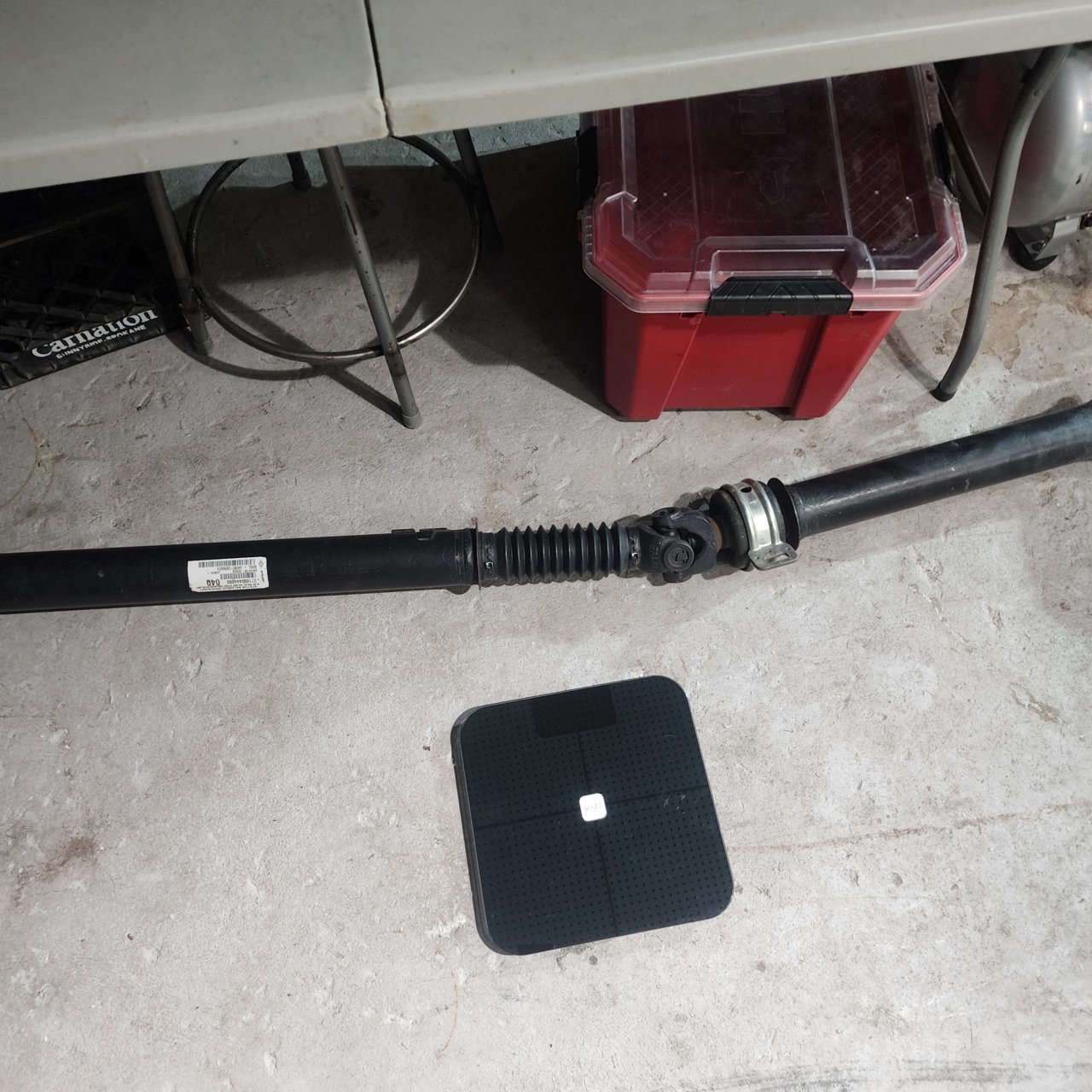

    2017 trd Tacoma offraod AT Inferno
    315/75/16, 6in modded RC lift,Anderson Engineering manifold spacer,K&N air intake, URD YPipe, stock exhaust ,16" method nv305 wheels, AFE throttle body spacer, vf Tune program, JTL 3.0 Oil catch can x2, rear cat delete
    I'm hoping ras suspension system will assist
    splitbolt[QUOTED] likes this.
  2. Mar 18, 2023 at 6:54 AM
    #62
    splitbolt

    I definitely like the way my rear end rides. Question if your leaf springs are worn out and the axle wrap that is now created, could it cause shock to blow out / leak ? Specifically the driver side shock

    So just fyi I have smooth operation from stop to 60 mph . It's when at constant power/ hwy speed I do feel little something going on. I need to measure pinion angle vs driveshaft angle see if they are within safe area . Then that way I cancel out bad pinion angle . Once that has been figured out , then I will know my next direction to go and FML figure out lol . This stuff is fun to me , I'm learning. Come on you walk/ drive in this case 200k mi and you tell me how lose or worn out you feel. Shit wears out . Beef it up lol

    #357811
    304
    does the toms DS weight more then the stock one? thanksp

    That's a curious question shipping was 38 lb on the woods custom driveshaft after pulling my stock two-piece drive shaft it felt like the stock was heavier than the Tom woods custom drive shaft. I have my stock drive shaft down in my basement I'm going to go grab my scale out of my bathroom and do some math I'll be right back.
  13. Mar 18, 2023 at 8:15 AM
    #73
    mushroom_man7
    mushroom_man7 Well-Known Member
    Mar 1, 2021
    #357811
    304
    th
    thanks im predicting the stock is a little heavier but we'll see

    Okay I weigh 160.5 lb, with stock two-piece drive shaft I weigh 200.9, so it comes to 40.4 lb on the stock two-piece drive shaft
  15. Mar 18, 2023 at 8:18 AM
    #75
    shotgunbilly420
    shotgunbilly420 [OP] OG Owner 249+ mi club/Tacoma enthusiast
    Jul 10, 2018
    #258947
    3,320
    Montesano, Washington elv. 66ft
    So yeah with the woods custom one piece drive shaft there is a weight reduction which I'm glad to figure that out.
