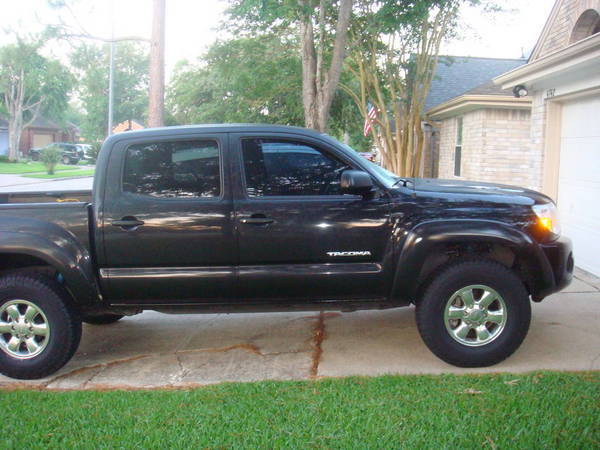

    do I need to do any extra step with these wheels, and do you think they will look good black?
