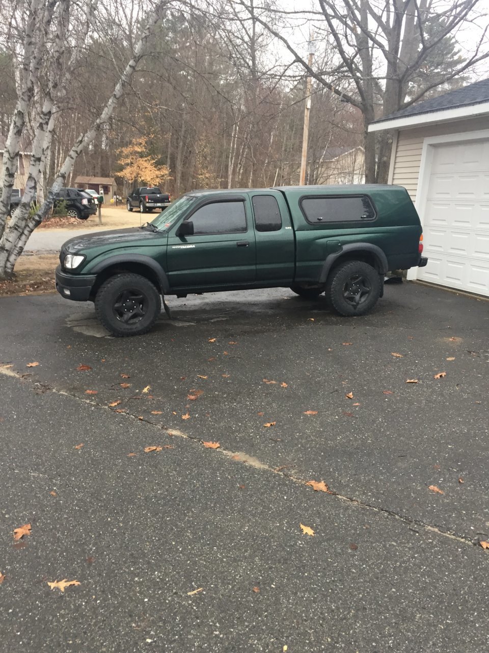

    what would be the most economical lift to be able to run 33’s on my 03 ext cab V6? It is my daily driver. Do plenty of off-roading here in Western Maine mountains. Thanks,
