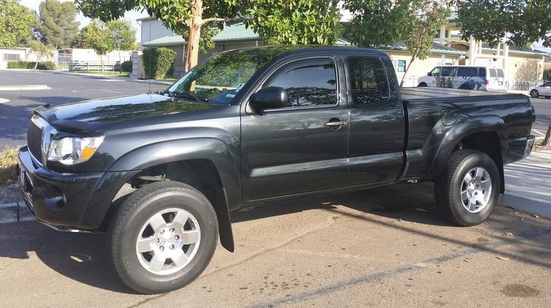

    Still trying to decide on my next tire size choice. It's between 265's or 275's. It's going to be Hankook Dynapro Atm's and I currently have Spidertraxx 1.25" wheel spacers and billies see at 2.5 height. I know for the 285's a wheel spacers is recommended to not rub but I believe if I choose to run the 275's, I will have to remove my Spidertraxx wheel spacers.
    This is my current setup with 265/70/17's on a highway tire with the Spidertraxx wheel spacers and my billies set at 2.5 height.

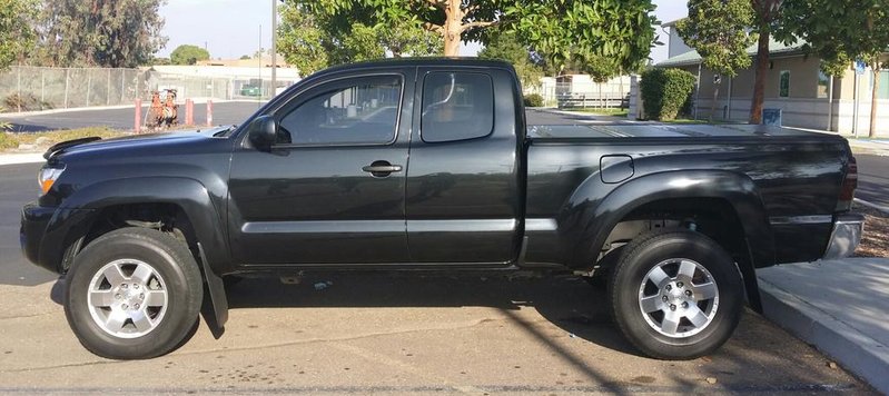

    So what size is better for street performance? I put a lot of performance parts on my truck and hardly take it off-roading. I like to think of it as a sleeper because I took off all my emblems. I have Spidertraxx 1.25 wheel spacers.
    Also, why is it to go 285 with a 2.5" lift, wheel spacers are required to not rub UCA or cab mount but to go with 275, it is recommended that I remove my wheel spacers?

    285's will hit the UCA without spacers , but do require trimming and possibly the cab mount chop
    275's don 't hit the UCA and adding spacers increases the risk of requiring trimming and possibly the cab mount chop
