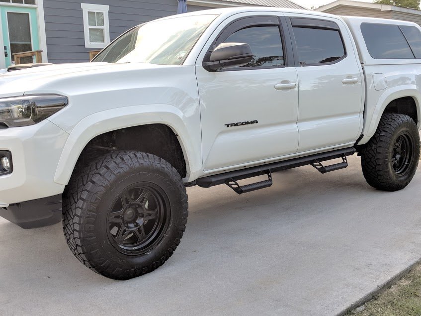

    Mine as it sits today. After switching to the 888 springs with the 1/4" top plate spacer and adding a 1" block to the rear with the Headstrong offroad progressive add a leaf. And switching from 275/70r17 BFG K02s to 285/70r17 Cooper Stt Pros. Eventually I will switch to a full leaf pack and a longer rear shock. Right now its good for as much off roading as I will take it.
