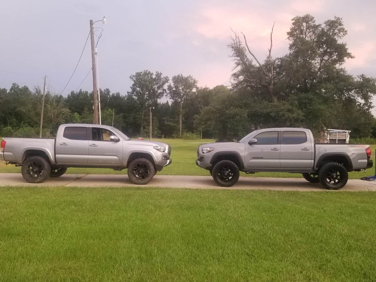

    2018 tacoma trd or
    1.5 spacer in front
    3" blocks on back
    20" fuel on nitto trail grappler with spacer
    Both trucks have same but different tires.

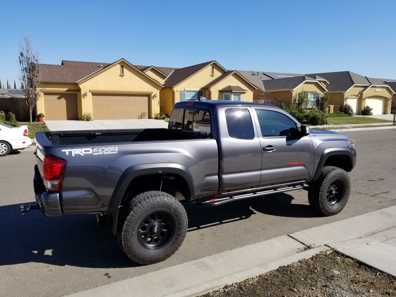

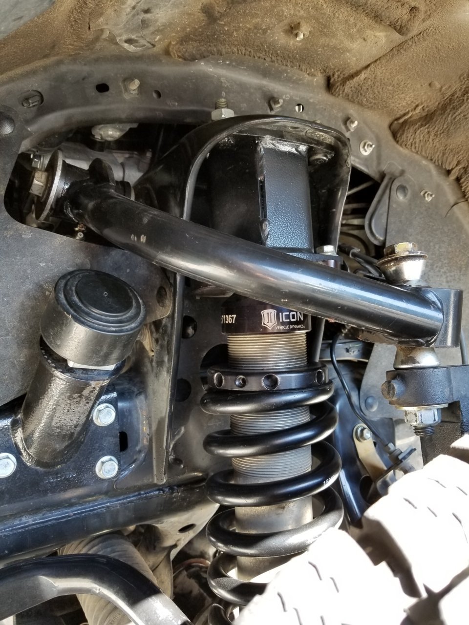

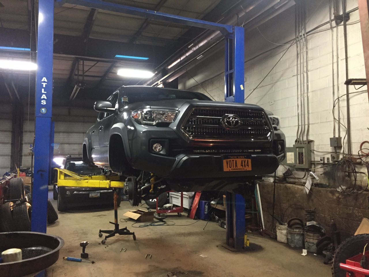

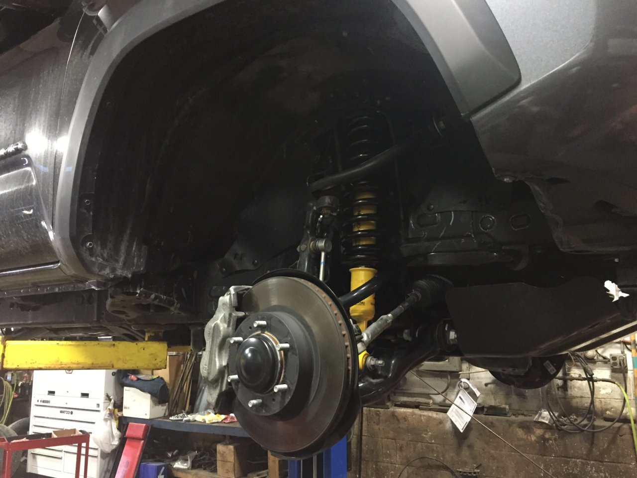

    6" rough country with a 4" front spacer and 2" rear block with one Dakar leafs.
    285/75r17 toyot open country at2
    Icon 2.5 front coil overs, icon 6" cdc remote reservoir rear shocks, though country uniball upper control arms.
    I did all the install and work myself, truck rides decent. Rear end is a little stiff due to the one leafs but the rear shocks help smooth it out on rough terrain.20180221_112431.jpg 20180221_112549.jpg

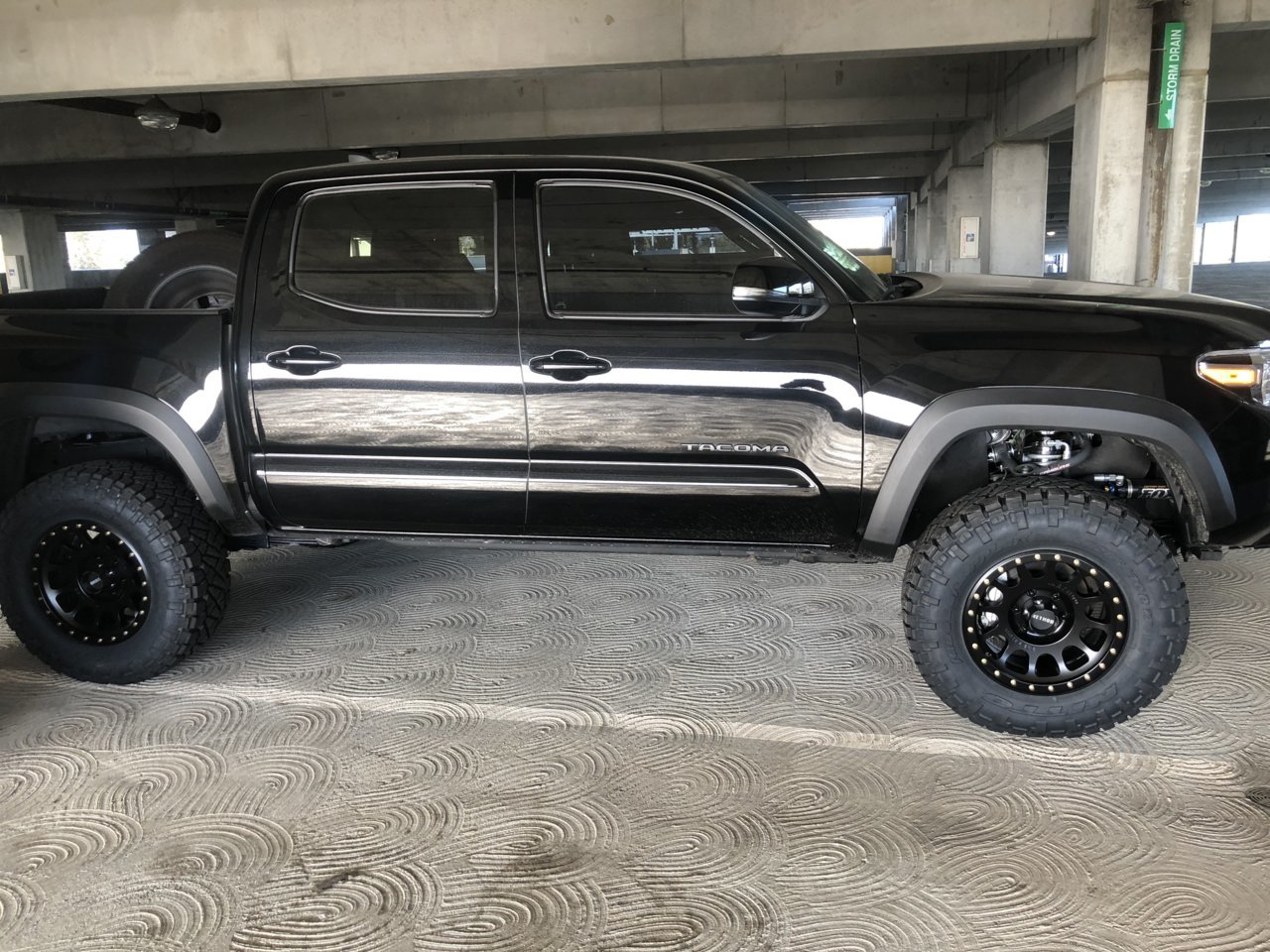

    Mine with Fox 2.0 Front and Rear. Medium Duty Dakar Leaf Pack

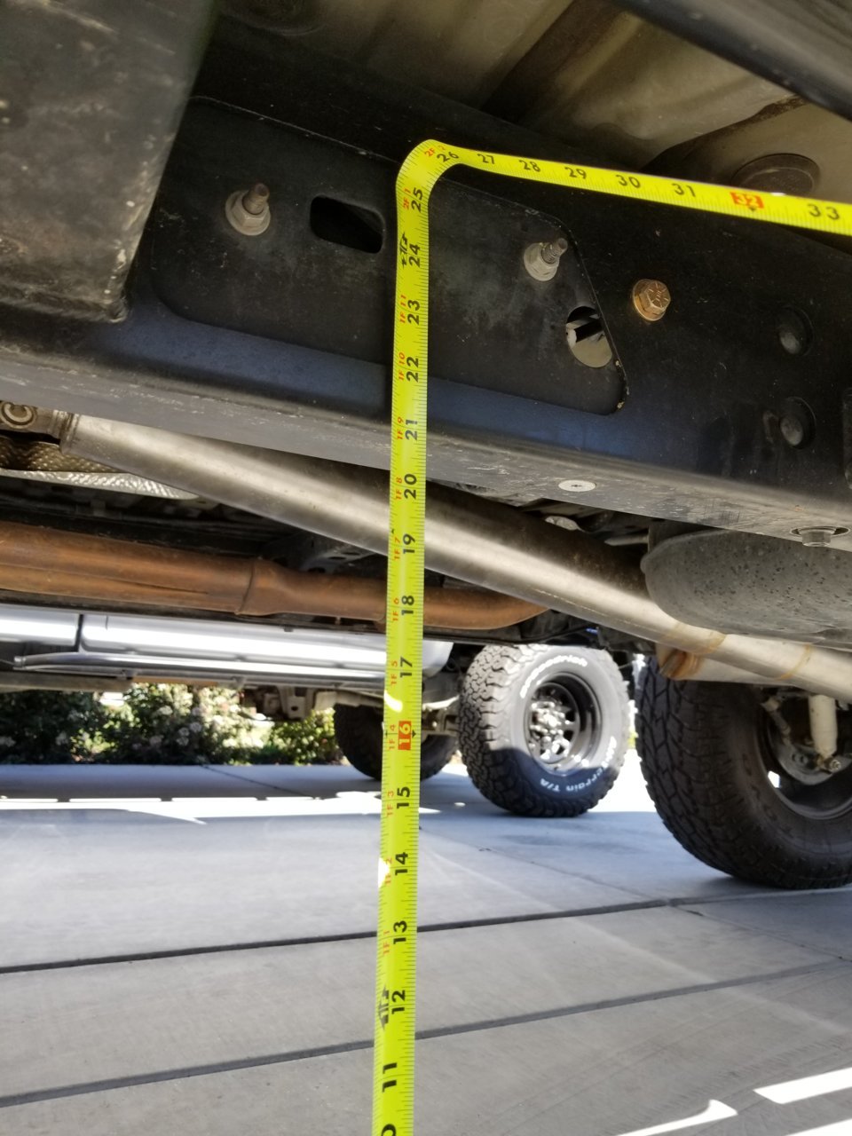

    That solid live axle and the differential are still going to be whatever height they are now, regardless of the lift. The only thing that increases the clearance under the rear differential is a taller tire. That's what I was getting at. :)

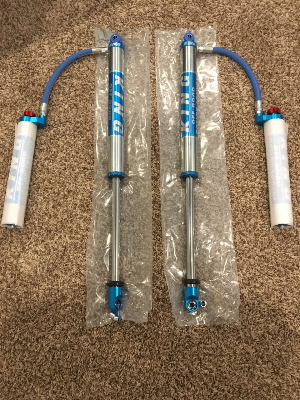

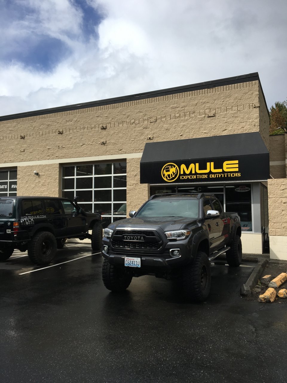

    I have a 6” lift and hate every bit of it. Nonetheless, heres a picture. If you really want a 6” a coilover setup and a leaf pack not a block IMO. Changing to long travel in the front mid travel in rear. Already have the rear setup. :thumbsup:
    2.0x12 custom kings ready for when i get my front.

    Do you truely hate every bit of it? you didn't even like how it looked? I fully understand LT will have just as badass of a look as a 6" but you didnt like the look?

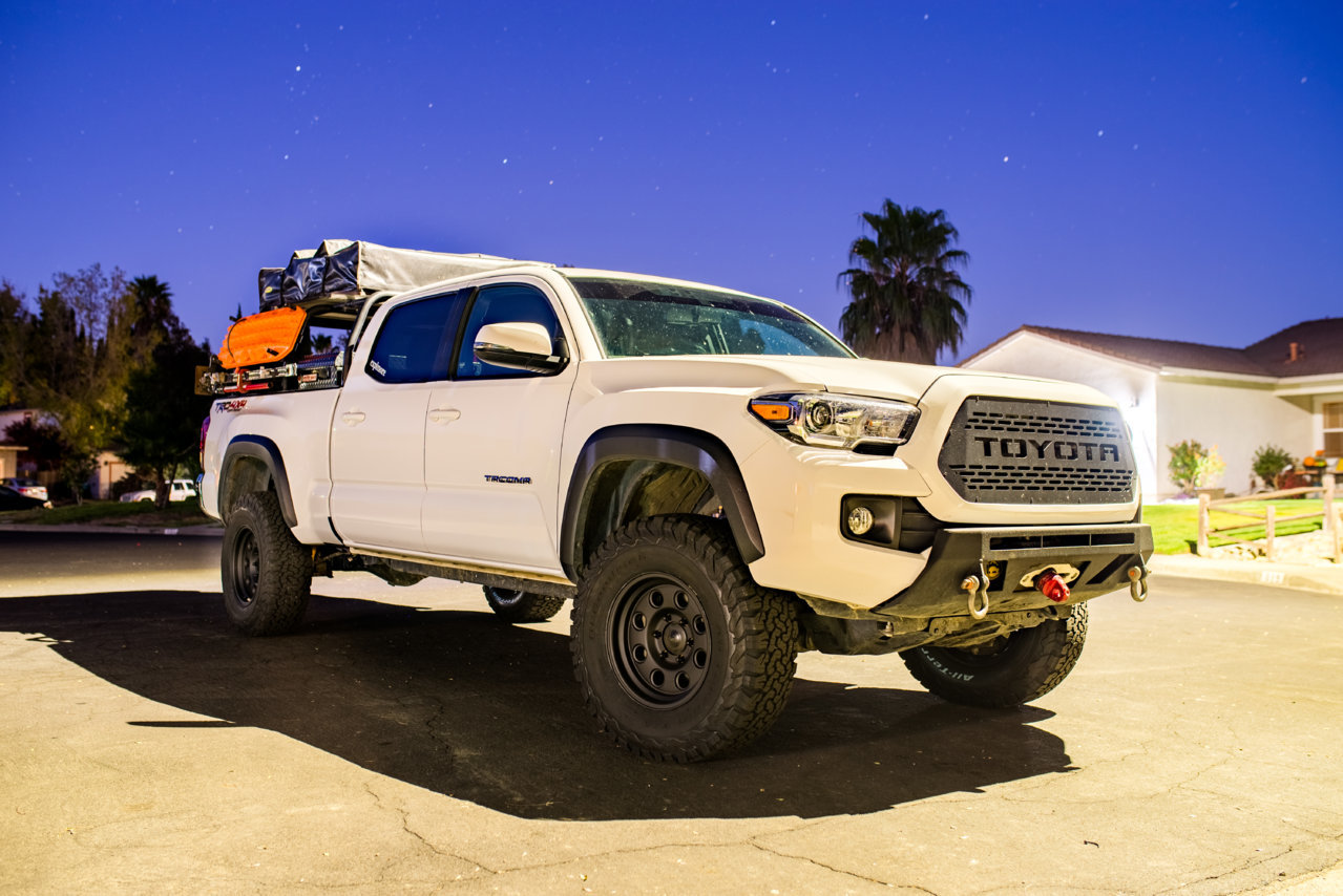

    2.5” OME / TC UCA’s / 265/75/16’s ... Sits level AF with a heavy camp load out and rides better than stock.

    My opinion is a lot different than many. I get compliments all the time. The look isn't to bad i guess, i prefer it a little lower it just makes my tires look smaller than they are and i run 35's. A lot of people love their 6" lift I'm just one of a few that regrets it. I take my truck offroading and it performs poorly especially with the huge turn stops Fabtech put in place to minimize rubbing. But every one has their own style/preference take what i say with a grain of salt.
