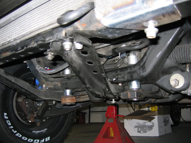

    My 07 Taco does not have those two loops; it don't have any loops. I added tow hooks at the corners where straps would hold down the truck during freight transport. Look underneath your truck and see how the front crossmember is connected to the frame. Chances are it's going to be connected like my 07. It's a rather light duty crossmember welded to the front ends of the frame and sits about four inches below the frame. The main crossmember is about three feet back and is connected to the lower control arms. The light duty brace has been known to bend or break off during hard towing. It's fine for light duty towing but I would not use a recovery strap to pull out anyone, or ask to be pulled out from the front end.
    This pic shows part of the that sub frame at the top of the pic. It's not my truck; it's a pic I found online. That hook with two bolts is one I replaced with a tow hook. That brace above it, with the big round hole, connects the crossmember to the frame.
    This pic has a tow hook like yours. The brace right below it connects the weak front crossmember to the sturdier crossmember. Pic is at an angle; I can't tell if it sits right above that brace. If it is, you might be okay towing heavier loads from that tow point.

    I have one of each type of bracket and have abused both of them. I trust the squarish shaped one far more than the round stock tie down point, but neither has moved pulling logs out of the woods or stuck vehicles from snow. Just my $.02

    I can definitely see the weak point on the tow hook, but if that whole sub frame is so weak, then what are the guys mounting the winches too?

    Winches are mounted on after market bumpers that connect to the frame at multiple points.
