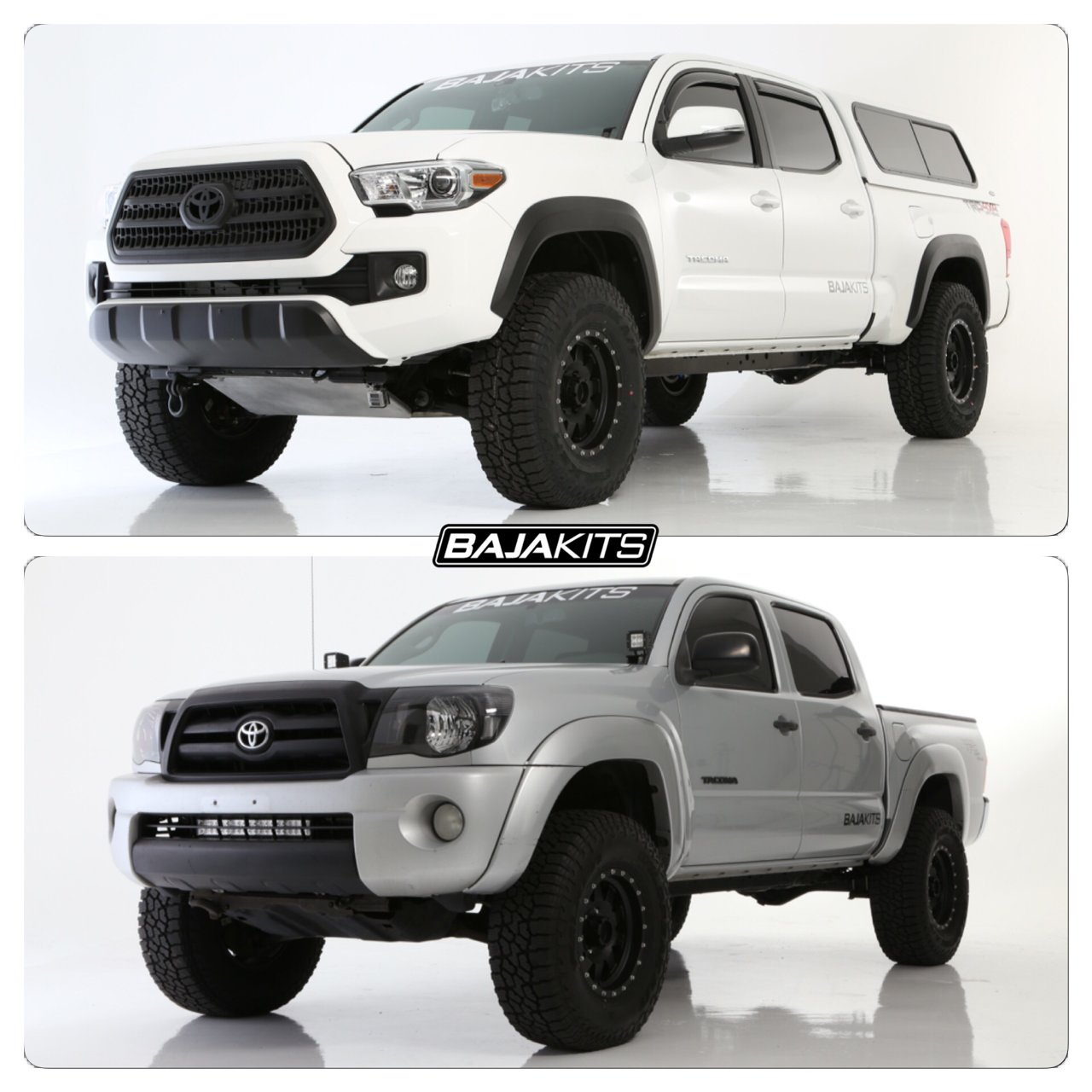

    We have our Chase kit available which includes our Boxed UCA, King 2.5 Coilovers and King 2.5 piggy backs in the rear. Great thing about this kit is that you can purchase the parts in stages.
