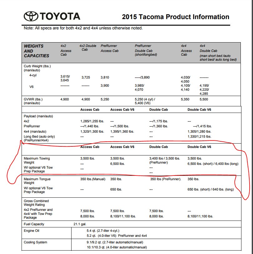

    I 've seen that spec sheet. BUT.... the torque is not there, I would love to see a v6 tacoma towing a 6k trailer on 8% grade.

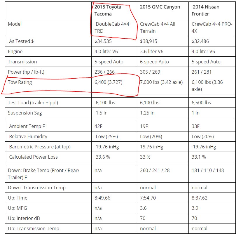

    I am not gonna get into a pissing match with you. I'd like to see that too.The spec sheet says what it says. No I haven't towed that I tow 3200.Lbs ... Although here is a test from TFL Truck.

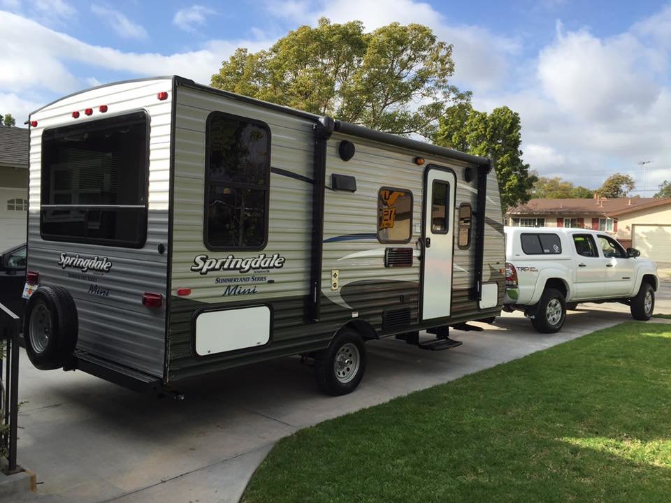

    I tow this and it feels like it is not even there:

    I tow this and I totally notice that it's there, especially on inclines.
