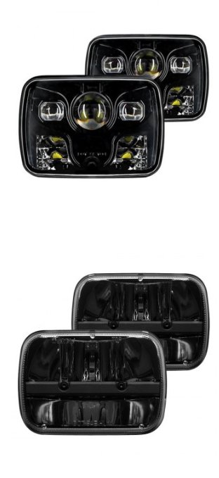

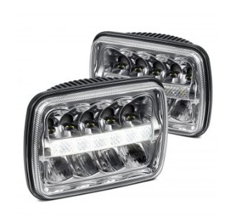

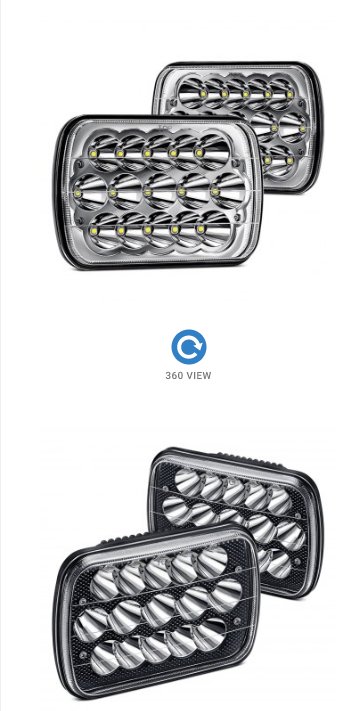

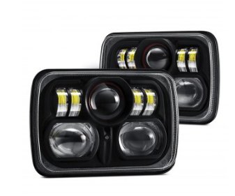

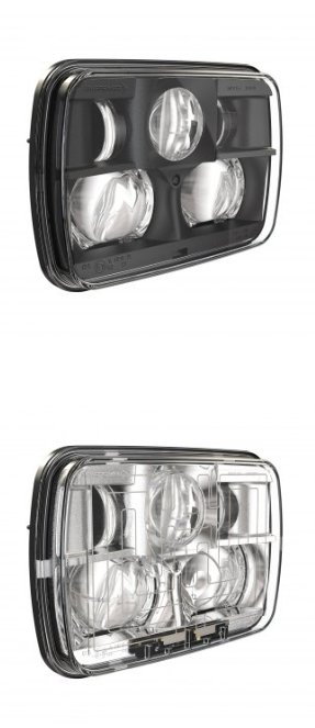

    the only ones I would try would probably be these:
    or
    or
    or
    but not these:
    or
    and probably none of the "normal" looking reflector housings that are marketed as LED.
