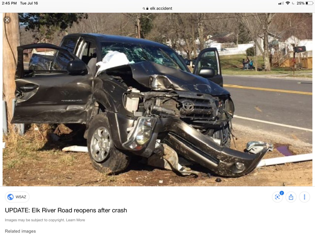

    As much driving as I do especially in the mountains with zero city lights and having deer running across the road all the time it’s important to be able to see as far as possible with in reason.
    Deer and elk auto accidents are a common thing and your truck will be totaled if that happens.

    Then you should know that hardly ever you run into standing deer - these suckers always jump int front of the car in the middle of the nowhere :). It does not matter how far you see down the road, you will be surprised by dear every time. In places where deer is often present I would not go fast anyway, unless I'm of suicidal/killing mission.
    What we want to distinguish between low beam use and high beam use. If you are the only one on the road by all means turn all your lights to see surrounding. When you are driving with cars in front of you or with opposing traffic you should be able to use lights from these cars to extend your vision range. At least this is what I'm doing when driving at night. Either way you don't need blinding low beams.

    IMO, super bright lights aren't going to help you there.
    I've hit a deer, and been hit BY a deer.
    First time was in highschool, driving an 86 Accord at night. Mountain road. This mountain road, not unlike most mountain roads, was very curvy. I saw a bunch of deer run across at the upcoming curve (in other words, my crap ass lights were sufficient to see at least to the next curve), I slowed way down. Got to the corner, decided I had seen the last one and started to accelerate. That's when bambi ran across and slammed into my hood. Minimal damage since I had already slowed way down, but the deer was dead and I had a nice bambi shaped fur imprint on my hood. Girlfriend was not appreciative, lol...
    Then, a year or so ago, was driving on a slightly less curvy mountain road, cruising along at 45 or so and this suicidal deer rammed into the side of me, right at my driver's door, smeared down the side towards the back, and still somehow managed to slide off the road into the ditch. My headlights never illuminated it, but my interior lights did, lol. I literally just saw deer face in my side window.
    In both of these situations, I could have had desert race truck lights, and it wouldn't have helped. The only time I've ever really seen an animal just sitting in the road (rather than trying to dart across it) is the bison in Yellowstone. Those guys couldn't give two shits about you, lol. You just wait.
