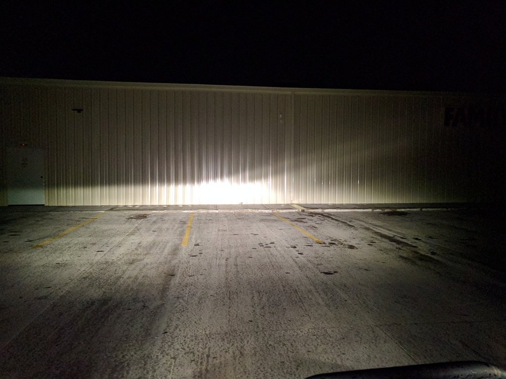

    I've never owned the ECE version of the Hella e-codes but I did have the DOT version or Vision Plus (Ordering mistake on my part) which was an easy improvement over stock and the quality was top notch compared to the Autopal version on Ebay. The ECE version has even better cutoff from what I've seen. I just didn't like that they would glare everyone to my right while driving so I got rid of them and did a retrofit build instead. It might not have been as bad as I thought but it did bother me. This is what the Hella e-code DOT versions looked like with GE Nighthawks. I also upgraded to a relay harness.
