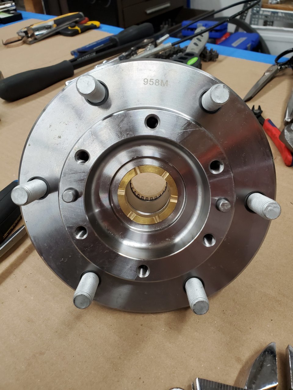

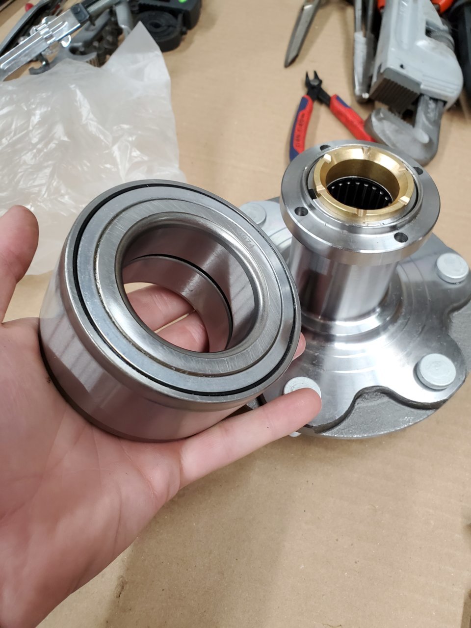

    I have aftermarket manual wheel hubs and bearings I'd sell ya! Brand new never installed. Planned on doing the swap but went a different route20200812_102156.jpg 20200812_102351.jpg

    Who manufactured these parts? How much are you asking?

    The seller should sell to whoever gets cash in his hands first :thumbsup:. My truck as ABS, and I want to keep this. I'm not sure these hubs have room for the bearings and ABS rotor.

    Regretfully I cannot answer that question. I don't have nor want ABS so it wasn't a concern to me. They give no cross reference to what Toyota part number they replace

    U can press those on with ABS spindles

    All will fit even with abs all share the same bearing in the spindles. I have abs just had to swap hubs from non abs to abs spindles. I have it on mine

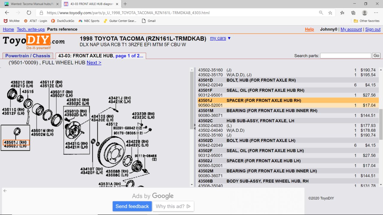

  12. Sep 4, 2020 at 1:37 AM
    Johnny0
    Johnny0 [OP] Well-Known Member
    Oct 23, 2011
    #65706
    83
    Los Angeles
    1989 4Runner. 2000 4Runner. 2018 Ford F-150
    bone stock
    Not sure what part you are calling spindle. I did research part numbers for this comparing the tacoma to T4R
    Many of the parts on the ADD and Non ADD hub are the same. The spacer and skid control rotor seem to be interchangeable on the same hub
    3rd Gen T4R Manual Hub Conversion
    1998 Tacoma RZN161L-TRMDKAB
    STEERING KNUCKLE RH 43201-35080 SAME AS T4R W/ADD
    LH 43202-35070 SAME AS T4R W/ADD
    FRONT HUB ASSEMBLY (MANUAL LOCKING HUBS)
    RH 43502-04030 (DIFFERENT T4R W/ADD)
    LH 43502-04030 (DIFFERENT T4R W/ADD)
    GASKET BETWEEN HUB AND FREE WHEEL
    R & L 43422-60060
    GASKET BETWEEN FREE WHELL AND COVER
    R & L 43531-60010
    SNAP RING FRONT DRIVESHAFT
    R & L 90520-27023
    SPACER FRONT DRIVE SHAFT
    R & L 90560-27005
    OIL SEAL FRONT AXLE HUB
    R & L 90312-95001 (SAME NUMBER ON T4R)
    RING, HOLE SNAP FRONT AXLE HUB
    R & L 90521-99114 (SAME NUMBER ON T4R)
    BEARING FRONT AXLE HUB
    R & L 90080-35071 (DIFFERENT T4R W/ADD)
    ABS ROTOR (SKID CONTROL
    R & L 43515-35010 (SAME NUMBER ON T4R)
    SPACER ON NON-ABS (IN PLACE OF ABS ROTOR)
    R & L 90560-52001
    NUT, FRONT WHEEL ADJUSTING
    R & L 43521-35010 (N/A ON T4R)
    SEAL OIL FRONT AXLE HUB OUTER
    R & L 90316-69001 (N/A ON T4R)
    FRONT DIFFERENTIAL NON-ADD AXLE TUBE
    ONE SIDE 41320-35030
    TACOMA/T4R W/ADD SHARE SAME PART NUMBER 41320-35040
    FRONT AXLE SHAFT
    NON-ADD 41337-35010
    TACOMA/T4R W/ADD SHARE SAME PART NUMBER 41337-35020
    AXLE SHAFT BEARING
    ONE SIDE 90903-63008 (SAME ON T4R W/ADD)
    OUTTER SNAP RING 90520-75002 (SAME ON T4R W/ADD)
    INNER SNAP RING 90520-39023 (SAME ON T4R W/ADD)
    OIL SEAL DIFF SIDE SHAFT
    RH 90311-47010 (SAME ON T4R W/ADD)
    LH 90311-47011 (SAME ON T4R W/ADD)
    2000 4RUNNER VZN185;-GKMGKA
    LH 43202-35070
    FRONT HUB ASSEMBLY (ADD LOCKING HUBS)
    RH 43502-35170
    LH 43502-35170
    RH 90369-54001
    LF 90369-54001
