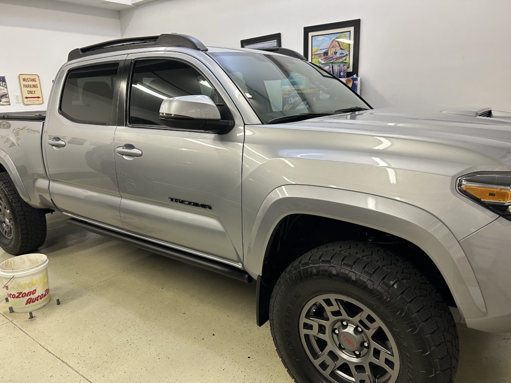

    285/7017s Toyo open country AT3s SL rated. They are I think the lightest and one of the best rated all terrain tires. I have them on the TRD SEMA wheelsIMG_2538.jpg

    The BFGs in an E rated weigh in at about 60 pounds and the Toyo at3 is Sl weighs 46 pounds.

    Thanks man. 285/70 SL rated sounds like a nice option that you 17" owners have at 46lbs.
