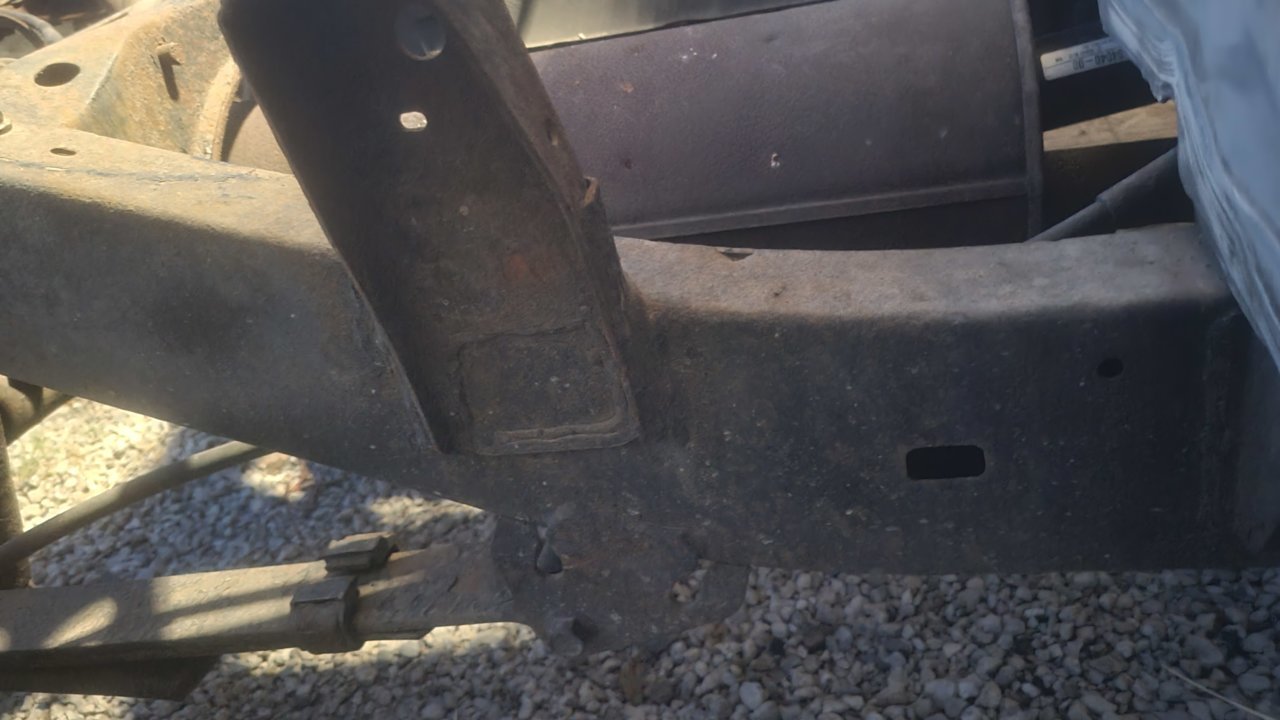

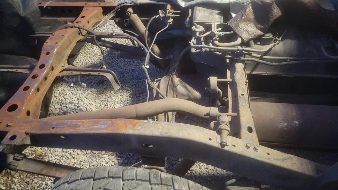

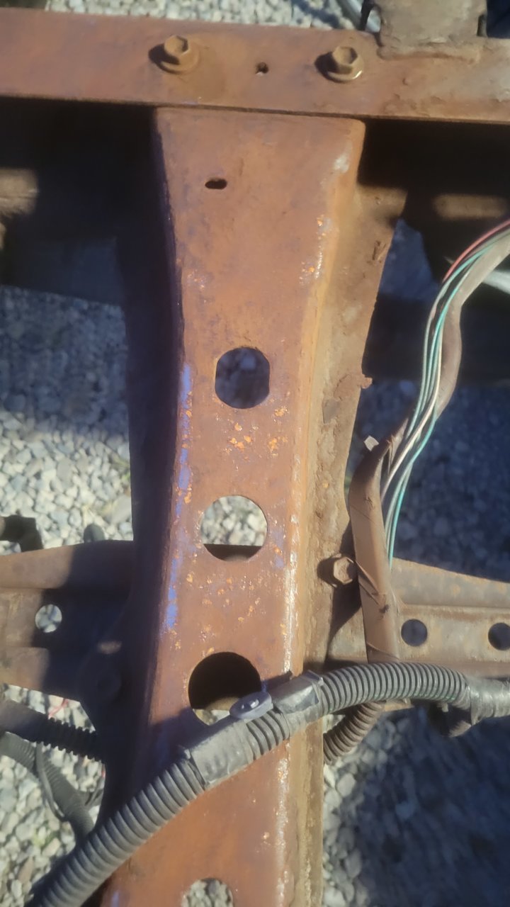

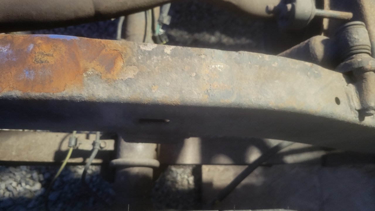

    So i got My bed off and here is what I see I started into it a Lil before I thought to create this thread and ask your guys opinions.20230617_211730.jpg 20230617_211714.jpg 20230617_211719.jpg 20230617_211744.jpg 20230617_211744.jpg 20230617_211714.jpg 20230617_211714.jpg 20230617_211719.jpg 20230617_211744.jpg 20230617_211730.jpg

    If the worst you have is shown in photos, you got no immediate worries. It's all surface rust.
    A through inspection on inside of rails, leaf hangers, etc. is a good idea. Pay close attention to areas under the cab, and where it transitions to the forward boxed portion, and inside the boxed part.
    Since bed is off, its a prime opportunity to wire-wheel it and give it a coat of paint.

    Looks surface and easily fixed
    Inspect the nooks and crannies as well.

    Looks way better than mine. I've been brushing on POR-15 after the wire wheeling I have done, so far it works well.
    https://por15.com/
    Oh and a needle scaler from Harbor freight works great for irregular areas and corners.

    Knock all the loose rust off, lay the POR-15 to it! Be sure to read up B4 using:)

    I'm not sure what years it applies to, but Toyota had a recall for rusted frames. My 06 had the recall. Might be worth a check. Otherwise, POR-15.

    To me That is in Excellent Condition.
    I am guessing not living in a cold winter weather state.

    That’s amazing condition man, surface rust and easily “fixed”. Just cosmetic
    you lucked out!
