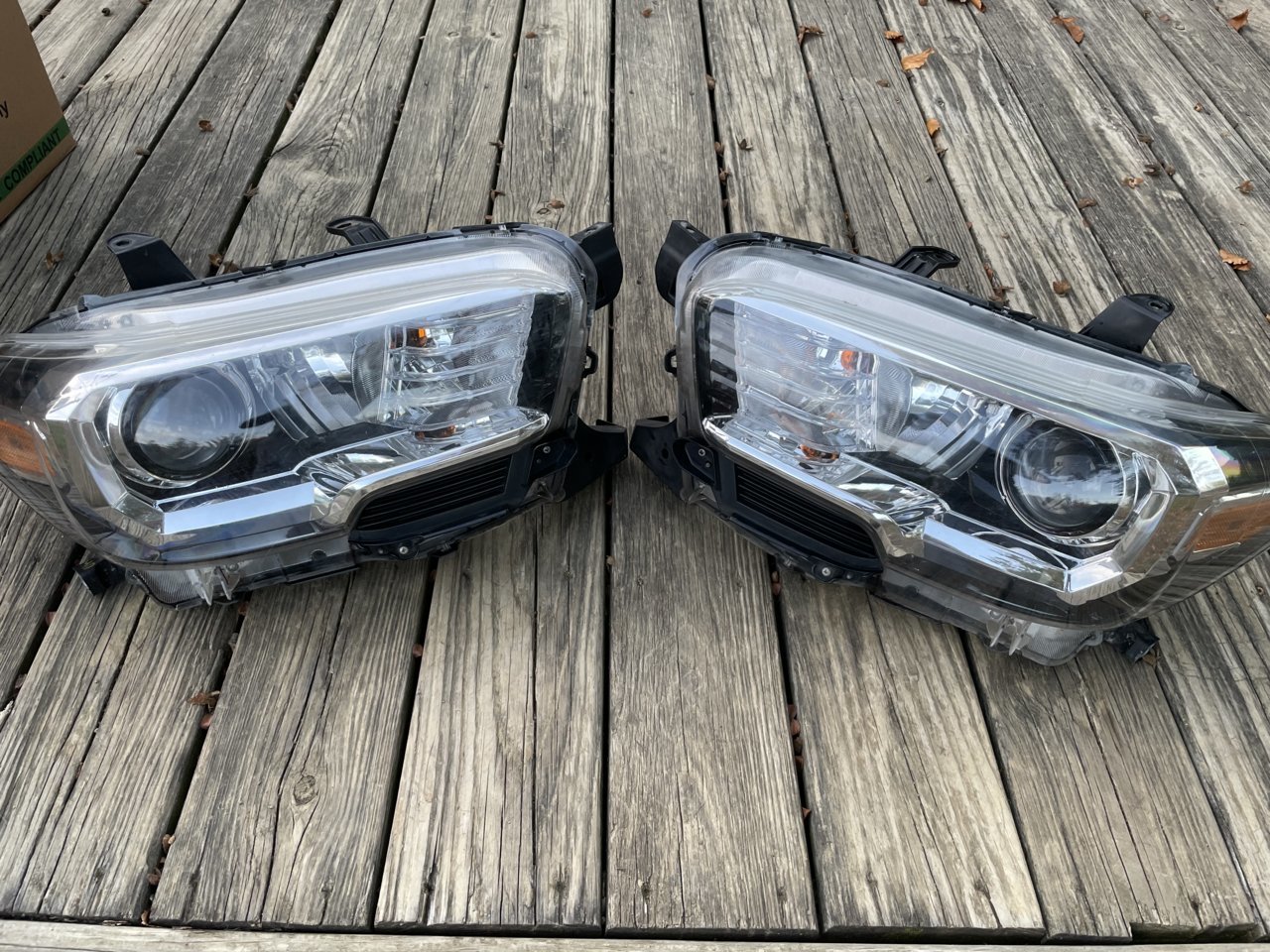

    The blacked out DEPO TRD led strip style ones have a harness for SR5 models as well. I have attached the pictures.

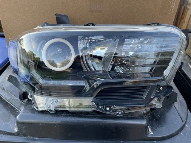

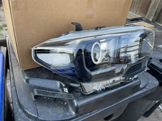

    @daveeasa (and @mustainefan since part of this is relevant to what you want to do) the amperage draw I wouldn’t be too concerned with, except for the ground. I don’t have to tell you this obviously (I’ve seen your stockpile of harnesses :p) but the LED lights use a single ground. That would be my biggest concern.
    Harnesses for this can be built, and if you are going back to the TRD halogen (with the “L” shaped DRL) it is pretty straight forward. I would advise using an additional ground though that you can take straight to chassis. There is a factory ground point by each headlight, so that’s really easy to do. I have built a set of these before, and that is the way I did it. I’m kind of surprised to see this come up again, not a lot of requests for it.
    And since I have to throw my hat in the ring: OP, if you wanted to go to a Blacked out set of Halogens that have some… unconventional mods, let me know. I can always sweeten the deal by making you harnesses and making the Blacked out ones do what you want. They have the switchback DRL (white/amber), switchback halos, and where these get a little different (and I think unique? At least I have never seen it done) is the side marker is set up with 3 - 3” switchback strips (think of Meso sidemarkers, but all contained behind a white reflector). My original intent was for these to be on my truck, but I ended up going LED myself. But if you’d be interested, let me know. They are in great shape. Hell, I even have fog lights with switchback halos to match :D I don’t need LEDs, but a guy I work with would love them. I’ll even volunteer to have him cover all the shipping :rofl:
    BC363E2E-AB80-4E1D-9835-91969B686F45.jpg C6CD2FD0-EE65-4CE6-A94A-7582F6FF5094.jpg 4B2ADD5C-23C6-40B1-92FA-60C14FB6383B.jpg also, @no vtec 4me did the Blackening, so you not have to worry about me doing a crappy job. I am much better at wiring than fabrication and painting
    Oh, last edit hopefully. The black on these is a gloss black. I did that so they would match the Pro taillights. Just FYI.
