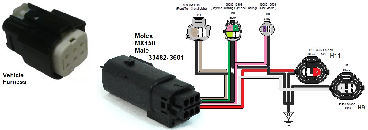

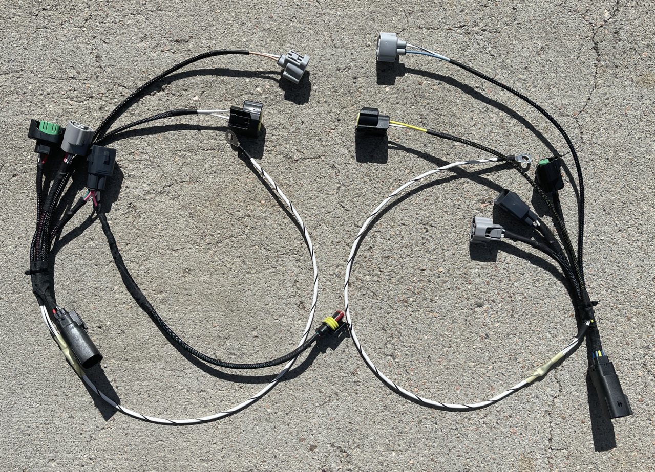

    @mustainefan @daveeasa @caribe makaira
    There are people that like to correct others and point out that Frankenstein was the doctor, not the monster. And then there are those who understand that the doctor WAS the monster….
    Anyway, these are all done :rofl:
    The turn signal utilized the OEM plug ground. The high/low beam each have an 18 gauge ground as well an 18 gauge shared from side marker and DRL. Those three 18 gauges go to a 12 gauge that will need grounded to the chassis. The one on the left also has an added tap for grille lights (or SSC3 backlights which are becoming a popular choice), but that was just me throwing it in because I wanted to.
  12. Jul 4, 2022 at 3:42 PM

  13. Jul 4, 2022 at 3:46 PM
    #73
    Puppypunter
    Puppypunter Well-Known Member
    Jan 4, 2020
    #315086
    2,746
    Johnny
    2019 Black SR
    You could run the three 18’s to the chassis. I made the 12 gauge 18” long, which is probably a foot longer than it need to be. Or you could run the three to a 6 position Metripack 280 and use a buss bar in it, but that seems like way overkill. Honestly, with grounds, I think the heatshrink on the butt connector is overkill as it is :)
  14. Jul 4, 2022 at 7:19 PM
    #74
    mustainefan
    mustainefan [OP] Well-Known Member
    Jan 1, 2013
    #94194
    202
    Portland, OR
    2022 Tacoma TRD Off Road
    Icon Stage 2, 2015 TRD Pro Wheels, BFG KO2 285/75r16
    Those look great! You’re the man. Can’t wait to test these out!!

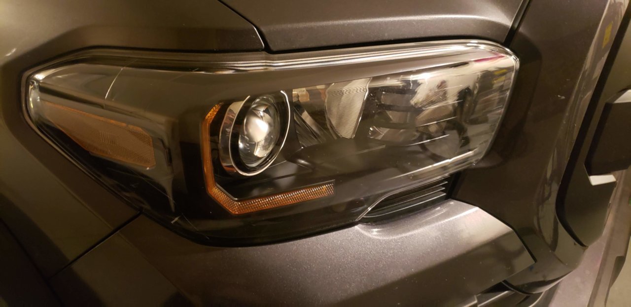

  15. Jul 15, 2022 at 8:05 AM
    #75
    mustainefan
    Jan 1, 2013
    #94194
    202
    Portland, OR
    LED Downgrade complete. Huge thanks to @Puppypunter for the custom wiring harness, and big shoutout to @no vtec 4me (Kevin) for the great BHLM. The setup works flawlessly (once we reversed the polarity on the high beam connection). I am loving the look!!

  20. Jul 16, 2022 at 6:15 AM
    #80
    slowlane
    slowlane Well-Known Member
    May 7, 2014
    #129313
    3,543
    AZ
    16 double cab MGM
    Looks good!
    So glad you went this route and not those junk depo lights the one dude wanted to offload. No offense to that guy, but that would have been a downgrade to a "downgrade".
    Talking purely aesthetics, I also don't care for the look of the led headlights, that led strip really kills it for me. Performance aside, I will take the led halogens every day of the week.
    I did my bhlm similar to yours, just not as fancy. Blacked out housing, amber leds, and amber painted led housing.
