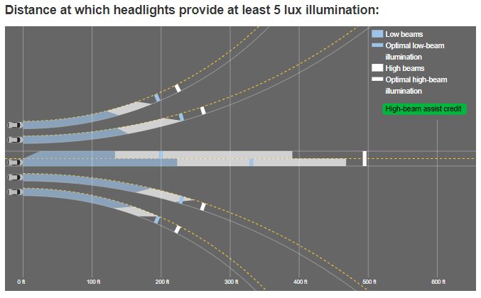

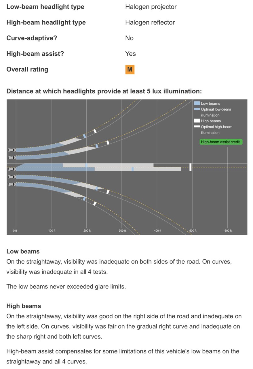

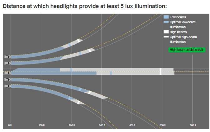

    The 3rd gen *halogen* Tacoma headlights are poor performing in general and particularly poor when compared to the OEM LED option as well as the impressive performance of OEM 2nd gen Tacoma halogen reflectors. They earned a P in 2016 and only earn an M today, I believe due to the auto headlight option and how IIHS rates for tech.
    All of this is well documented in @crashnburn80's independent independent testing where he compares stock halogen bulbs, various bulb upgrades, and the OEM LED headlight side-by-side.
    Many of us would prefer a 5000k or even better, 4000k option. Many of us run halogen headlights in other vehicles. In this instance, it seems pretty clear which headlight choice is the best performing option. Cost is significant, though, so I fully understand anyone deciding that it's not an important upgrade to justify the expense. But the downgrade, going from LED to Halogen, it looks like this:
    https://www.iihs.org/ratings/vehicle/toyota/tacoma-crew-cab-pickup/2023#headlights
    LED:
    Halogen:
    So, that's a significant and noticeable tradeoff for different cosmetics.

    crashnburn80
    crashnburn80 Vehicle Design Engineer
    Jun 6, 2015
    #156893
    14,751
    Kirkland, WA
    2003 DCSB TRD OR
    Correct on the Poor to Marginal test improvement. Last line notes that the auto high beam compensates for the inadequate low beam.

    where did you find this chart?

    IIHS:
