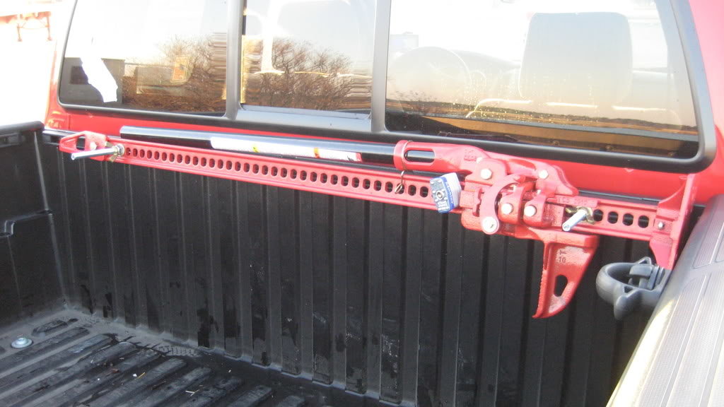

    I'm looking to mount my hi-lift to the front bed rail, but I can't use any of the many brackets that hang down, like Allpro or Relentless. If I do it'll mess with my storage solution. So the hi-lift needs to be mounted higher up.
    I'm looking to do basically what this guy did:
    (the member hasn't been on in months)
    Can anybody give me advice as to what hardware to use?
    I was thinking I could just throw some t-slot nuts into the rail, and then just bolt into those nuts. But that sounds like a pain in the ass trying to hold the hi-lift up there while bolting into it.
    Do they make something like a t-slot nut, but with a bolt instead? I'm trying to figure out how that guy got bolts coming out like that. If they're super solid, that would be ideal.

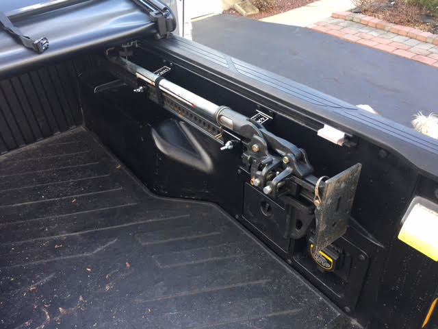

    This may not help. But in case it does..this is what I did.
