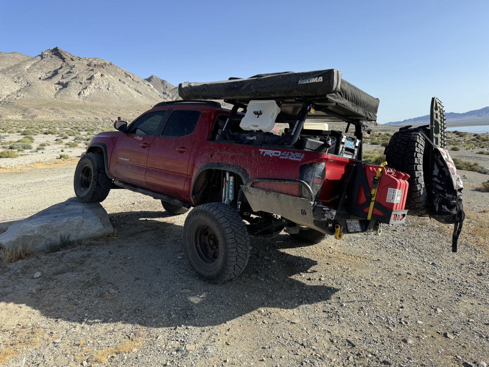

    Just wanted to add my personal experience here. My Taco is on +2 LT (unrelated) running 35s with -38mm wheel offset. I did C4 CMR, 5.29 regear and also the OTT tune. Can't be any happier.
    Btw techbro here too so please don't judge me ;)
    If you want to go down the CMR, re-gearing or tune, highly recommend Shaffer's Offroad in Union City for re-gearing and CMR and J.C for OTT tuning (he goes by central_coast_tuning on IG). Feel free to DM me if you need the contacts.
    Edit: Looks like you already talked to Shaffer's. I did my re-gearing about 2/3 years ago so I can't comment on the quote for that. But as someone who goes to Shaffer's a lot I honestly recommend them a lot. Mike and Alex has worked on my rig since the beginning. Unlike a lot of other shops that are nothing more than installers, Mike and his team actually goes out wheeling to Rubicon and Baja so they know very well what can go wrong and hence what to do right the first time around.
