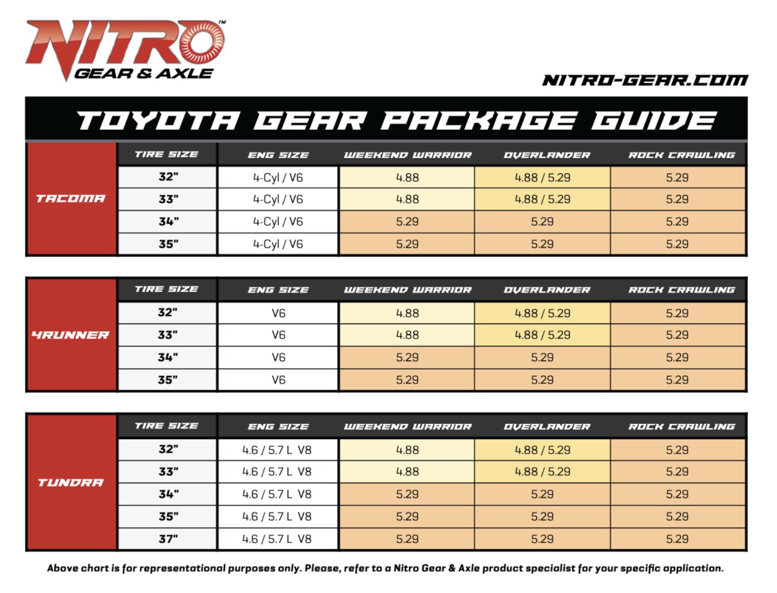

    "IF" you do plan to go down the re-gear route, this might be a good rule of thumb. Disclaimer though, I am no re-gearing specialist. All I know is that I am running 5.29 with 35s and a whole bunch of dead weight on the bed and it seems to be fine in my case.
    TacoTorakku[OP] and 71tattooguy like this.
