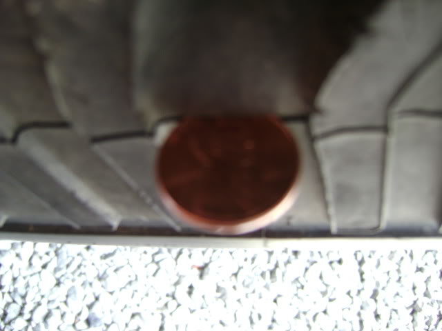

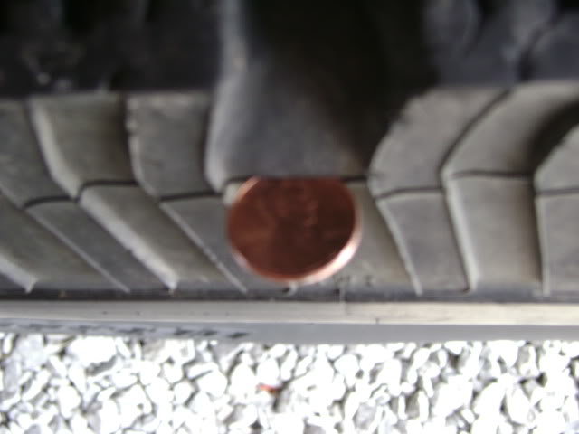

    Now keep in mind this cut has been on the truck for a while i'd guess around a year. I honestly don't feel that it is a threat with basic vehicle use. You won't see me crawling with these tires again or any serious wheeling. I have tried to find how think the side wall on this tire is but haven't had any luck yet. I just started to look for thickness when I made the original post, I've been on the BFG website and I also stayed on hold for 10 minutes but gave up and will try the call again tomorrow.
    Glad to see that there are others that think like I do.

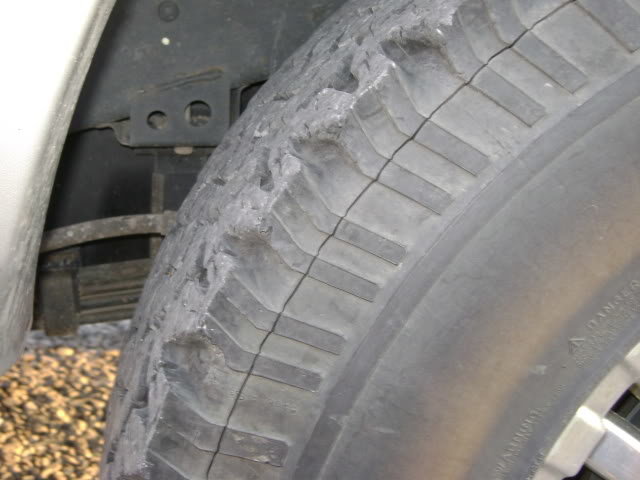

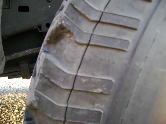

    Notice that the cut never goes into the actual side wall, it remains in the treaded part. This is the reason why I have kept on riding a tire with such a cut. Might be misplaced confidence though. Which is why I am getting others opinions.
    This is as deep as a penny will go
    No to his forehead about half

    At first I thought you meant the lil chunk of missing tread, but your talking about the cut right? that circles the ENTIRE tire? Also, is that cut on the inside of the tire as well? If I had to guess, it almost looks like you got a re-treaded tire that is starting to become seperated...
    Did you buy those? Buy them New? Used?

    Brand new tires. The cut is only about 1/2 way around this tire and stays in that upper section where the tread is. No cuts on the inside of the tire. This cut was caused by rocks in Arkansas while wheeling. Its not coming apart. The cut is also about 1/8" deep.

    Well, if I was tire shop working, I'd say it's a sidewall cut and to junk it so you would buy a new tire or set of tires. But it looks close enough to the outside tread that i'd say you probably missed all the wires.
    and I mean Probably, with your load rating those tires are normally aired up around 40ish PSI correct? which means if even 1 wire is broken, your tire could "Zipper". Meaning, 1 wire breaks, then 1 more, then 2 more, then 3 then boom. It's not fun, I've been near 100 psi semi tires that zippered.
    You have two choices, poor mans is: flash light up close examine every little section of the cut, use a dull flat head screw driver to spread the rubber at the cut a little bit at each part. if you even see an exposed wire, then shes a blow waiting to happen. If you don't see any wires, keep er below 55-60 so if it ever does blow (say you hit a pothole) then you can recover easier below those speeds.
    But If you've got the coin, replace it. and replace its pair like the previous guy said

    That cut can progress very quickly the minute tire pressure drops a bit (say, on a cold day) and the sidewall flexes a little more. When it fails the tread will probably separate, like those Ford Explorers. Even if you maintain control, the flailing tread can tear up the wheelwell.
