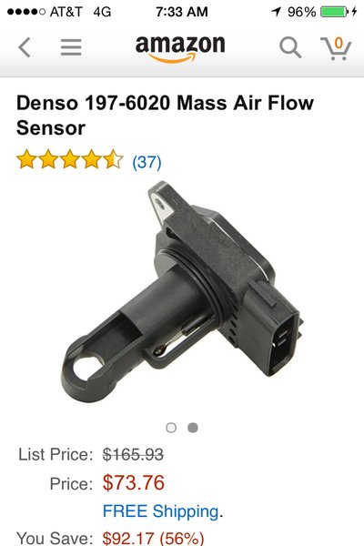

    Okay, got the MAF cleaner located and went to look for replacement sensors and.... Wow. These MAF sensors are freaking EXPENSIVE. I'm finding that some listings on these that say they'll work on either the 2.4L and the 2.7L engines. Does this sound right to you guys?

    I got mine for my 2004 3.4V6 on Amazon for half the price of Vato Zone or O'reilly's

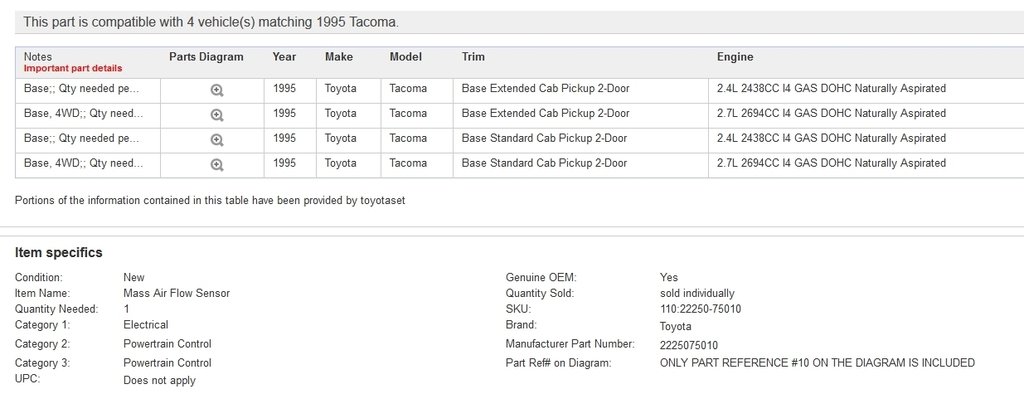

    I'm a huge fan of Amazon and ebay. Online shopping is no prob. But what I'm really looking for right now is confirmation that a sensor that works for the 2.7L can work for the 2.4L...??

    Okay, if you were me, would you take this most helpful ebay compatible chart for a MAF sensor (referred to as a MAF 'meter' in the parts manual), and interpret it to mean that it would work on both the 2.4L AND the 2.7L? It sure looks that way to me:
    It even has a helpful manufacturer part number (it lists that part as a "meter assy" too), which matches the number that I found on the toyodiy.com site where it listed his truck as a 1997... at least it listed the engine as the right size, even if the trans was not, so I figured that's an even better proof. What do you guys think?
