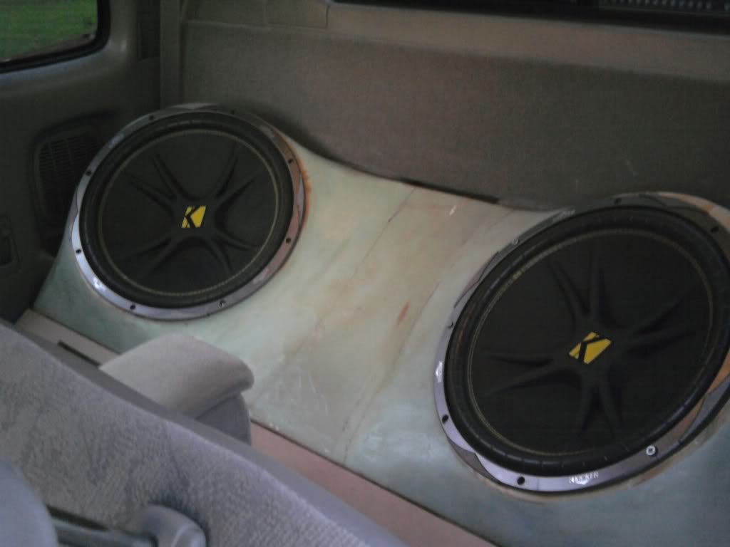

    ill play!! here is the old setup with my fiberglass box. 2 15" kicker comps.

    Great God... 15's wtf you thinkin man? Being deaf sucks lol.

    yea i agree 15s?? lol way too much for a small truck. My two tens beat the shit outa it if i want. And i personally don't like the response of 15s..

    Yea thats why i only have one now.

    Yea it was a ton of bass but it was really cool! And my licker comps always sounded good and very clead just depends on your setup and how its tuned.

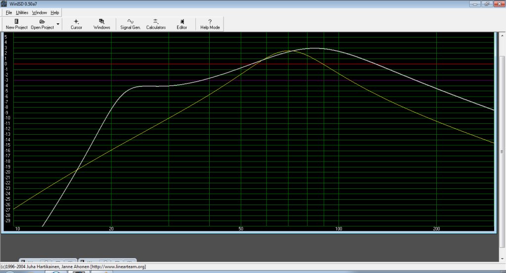

    Haven't installed the CB yet because I don't have an antenna or coax cable for it but I'm designing a sub box that will hold a single 8" Kicker L7 it will be a slot ported box at 1 cubic feet tuned for 25 hertz I'm mainly doing this because my friend bought a Prelude and is using it as a racing car and sold the sub to me for $10 it works and sounds great he just doesn't want it so I'm taking this opportunity to play around a little and get some low end in my music. Vented is in white sealed in yellow.
