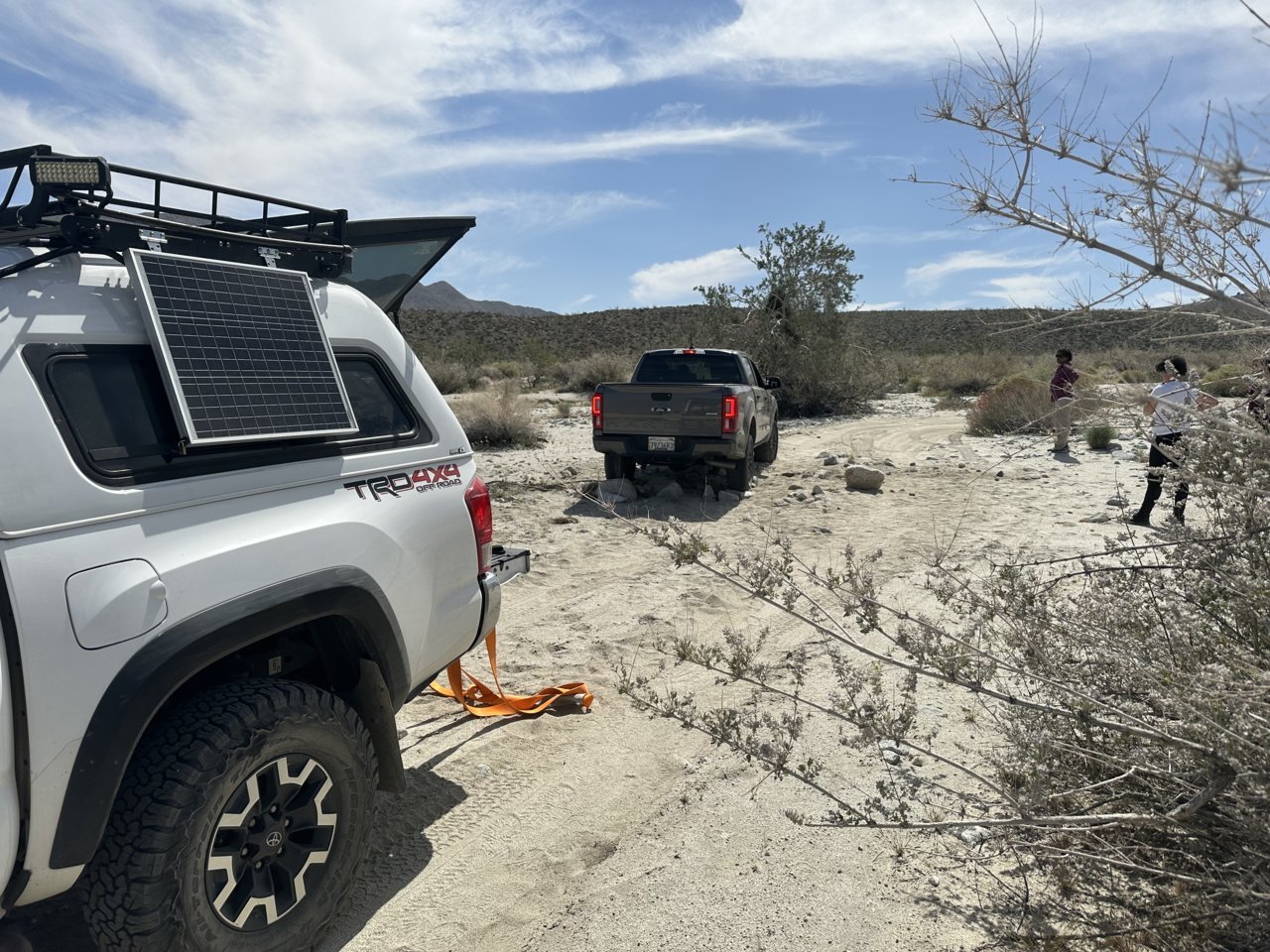

    I ended up selling my Evo and bought a 4-ton Griphoist and Pull-Pal anchor (no anchor trees in the desert!). Slow and requires muscle, but it’s portable and not tied to the truck when needed. ive been able to walk down a trail with it and move boulders off of it sideways just using the hoist and pull-pal anchor alone, and I can pull from any angle off my truck if needed. For basic recovery of people stuck in sand- a long tow strap works just fine also…
    Just saying that needing a winch is different from wanting one…
