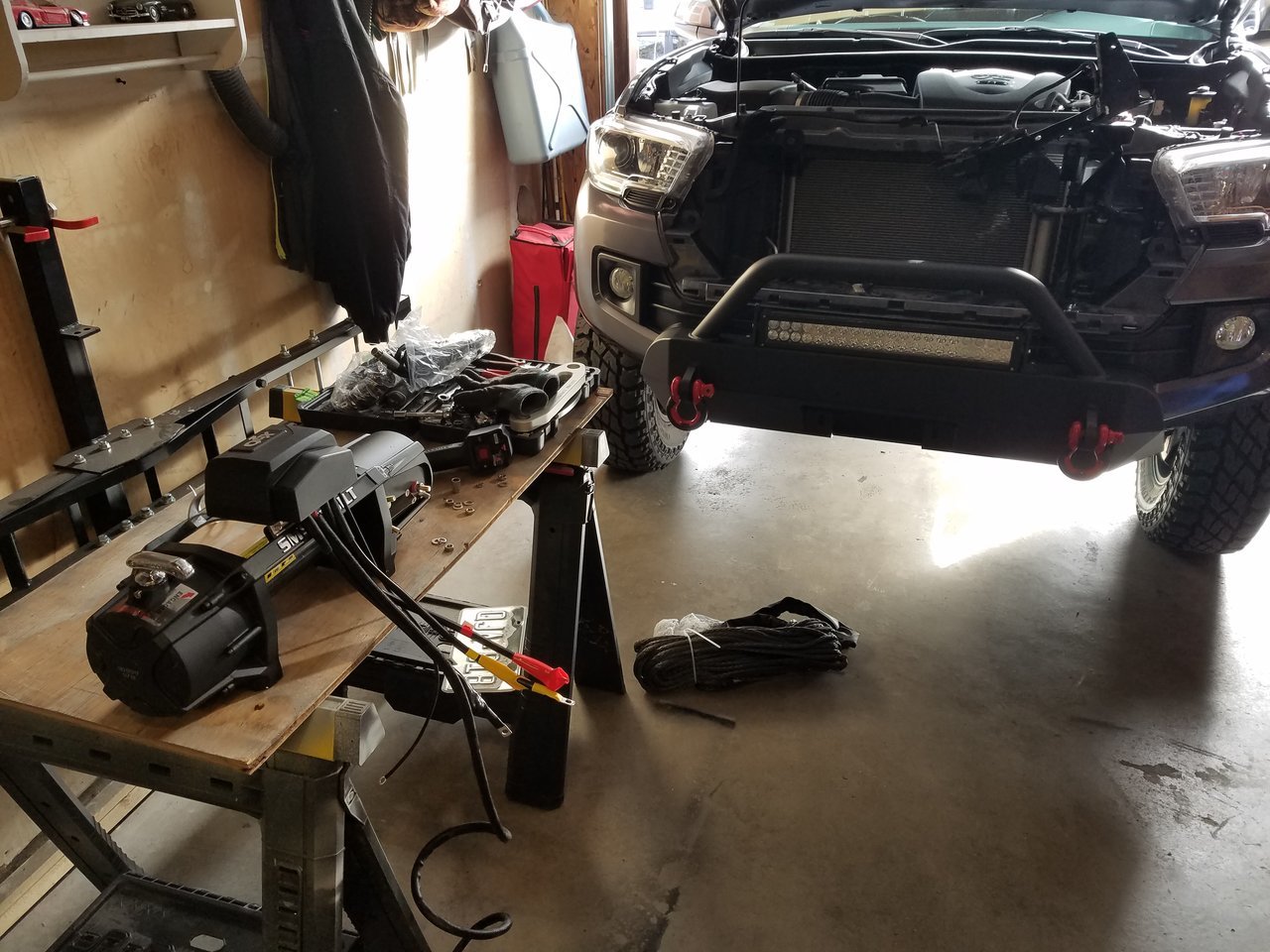

    I’d like to know the distance between the bottom of the hoop and the top of the bumper itself, I’d like to mount a few BD Squadrons there.
  18. Feb 23, 2018 at 7:12 PM
    #198
    Hstone556
    Hstone556 Ain’ters gonna ain’t
    Dec 3, 2017
    #237527
    2,814
    Hunter
    Austin
    2019 Ram 2500 Laramie
    Raceline 17" Gauge's 37x12.50 Toyo's RT, Carli King 2.5s
    On your first pic you can see the stock bumper kind of “warped” or hanging down behind the winch mount... is that going to have to stay like that due to not having the black “chin piece” now? Is there a way to fix this like tie it up or secure it somehow?

    Can anyone confirm if this bumper interferes with the radar system in the 2018?

    There is a clip that goes through that peice and clips into the bumper to pull that tight.
