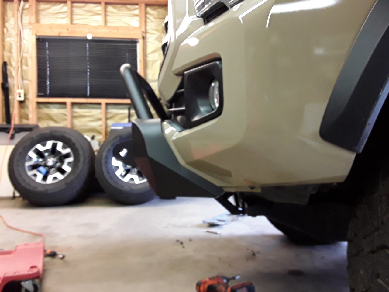

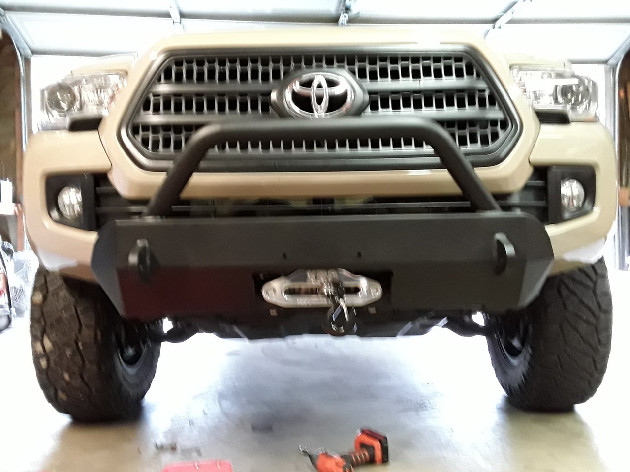

    Did my install today with a Smittybuilt 9000/ synthetic rope. The bumper went in easily. Winch and bumper took 3 hours with 2 people. I'll try to answer some of the questions.
    Does it contact the stock plastic bumper? Yes... on both sides. Nothing moves though, so not a concern for me.
    Does it stick out? Just enough for the hoop to fit.
    Does it hang low? No
    Did the suspension sag? Not that I can tell. I have 6110s.
    Did I have to cut any thing? To put on the under support brackets, I had to dremmel a rectangle in the underside of each side of the plastic bumper. Its way under so not really visible. The clip that holds up the bottom center plastic holds it up in the center. I do not like how that looks. I'm going to cut the center piece under the bumper out. Its pretty insignificant.
    How bad is the winch to get in? Piece of cake.

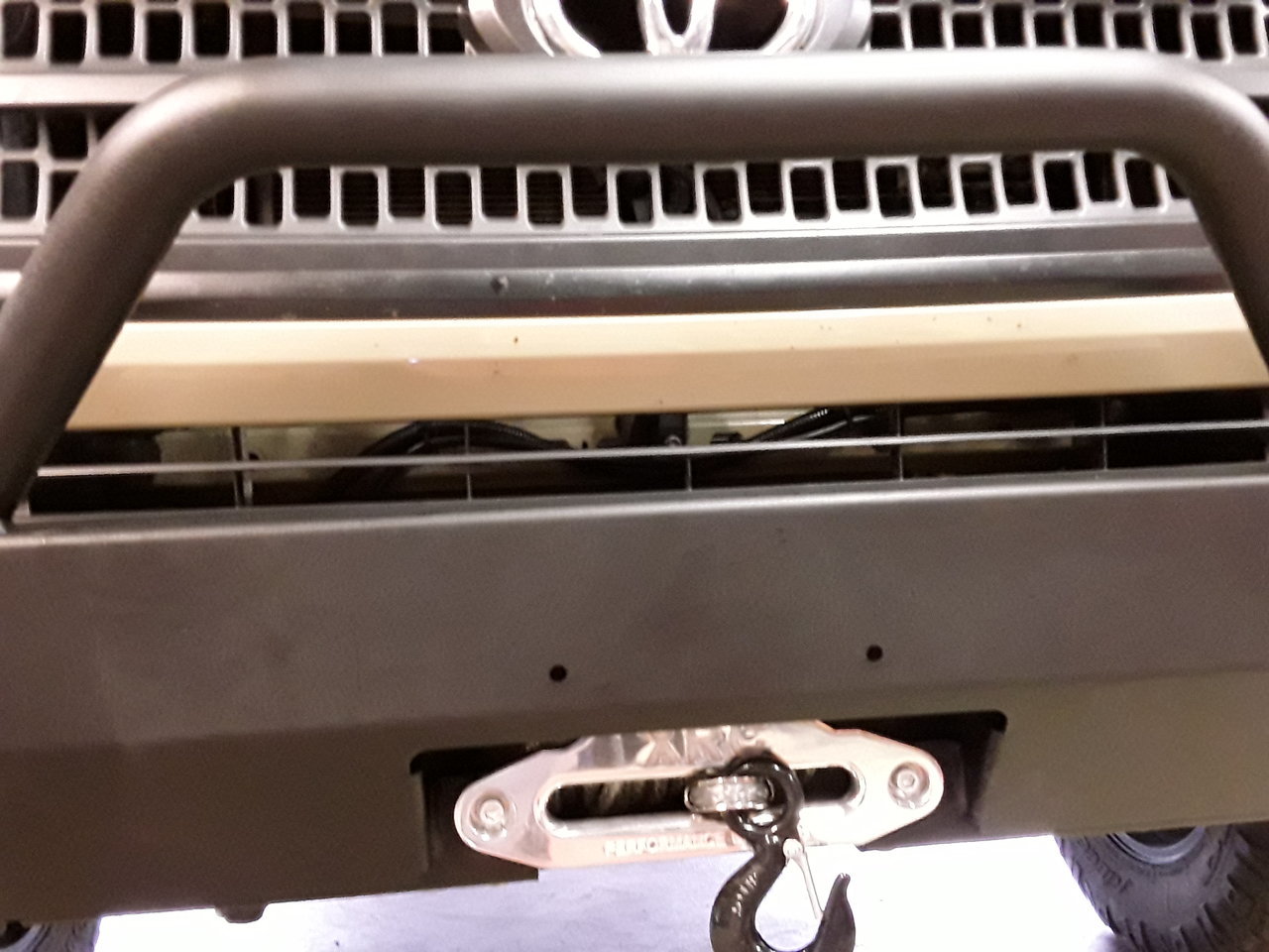

    How do you operate the winch? I set it up to reach in under the hood behind the grill. There is plenty of room. I put the control pack on the winch motor laying down. I also think it would fit on top of the center part of the winch laying down. There is plenty of cable to reach the battery.
    I will get plenty of good pics tomorrow. I have 1 on my phone I will post in a sec.

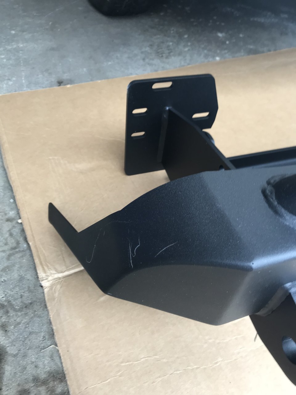

    Mine came today. Kinda bummed it was packed not so well and got a bunch of scratches from rubbing on the boxes staples. Looks good other than that.

    I think I'm also going to cut and bend some thin sheet aluminum that screws into the tag holes and bends to smoothly cover the whole winch fair lead and opening.

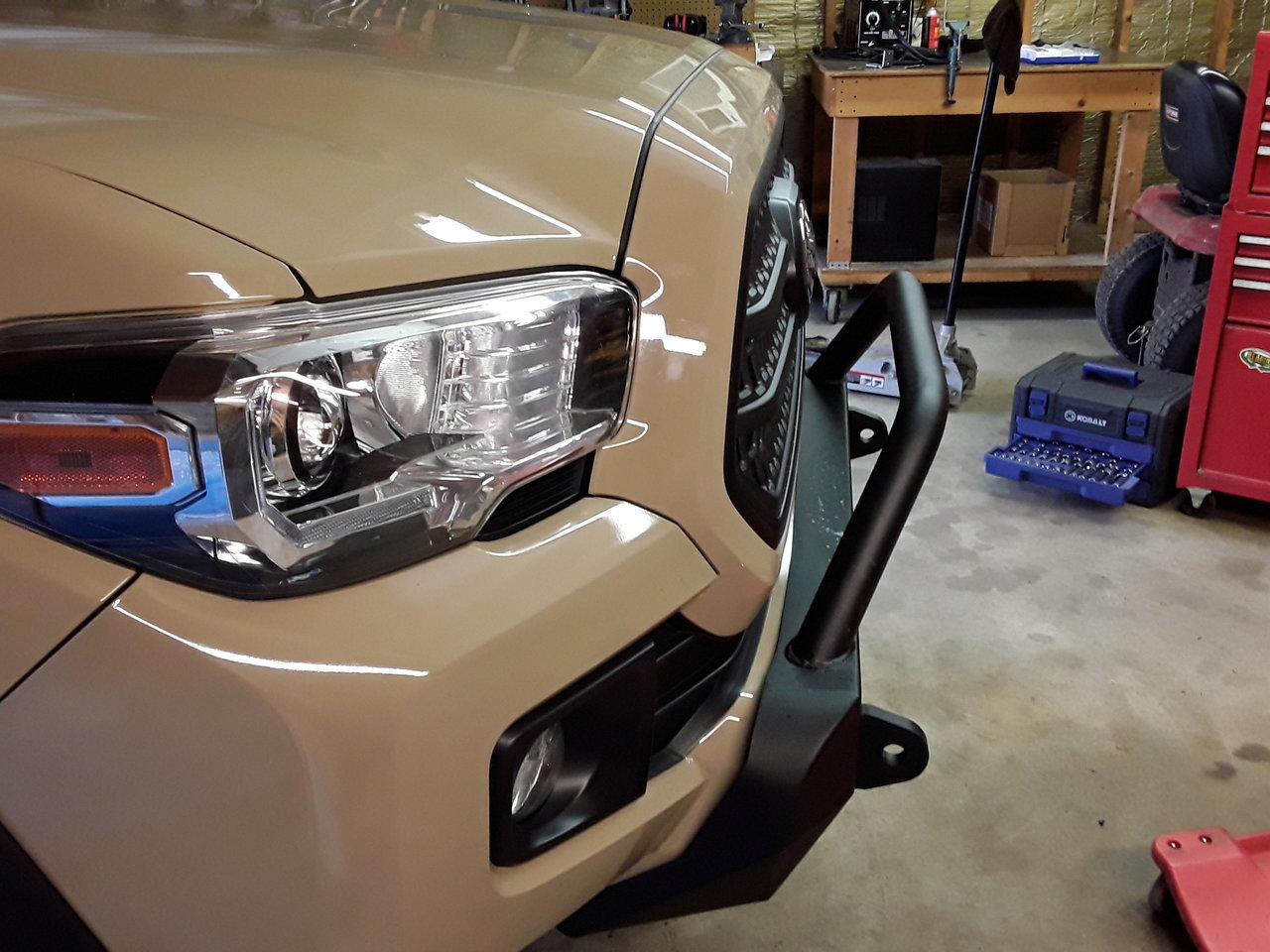

    Am I the only one not digging the high hoop?

    After sitting over night and driving some today, it has settled in some up front. I have 6112s set at 5/6 and I do notice more rake than it had before the winch and bumper install .

    Better answers to some questions.
    Room for light bar inside. Depends on the winch. With the Smittybuilt... yes.
    Does it stick out much? Just enough for some light mounting.
    Does it decrease ground clearance? No lower than the chin was.
    I mentioned a few posts ago that it settled the front suspension. To be clear, it is only VERY slightly.
    I did cut off the plastic that was curving under the bumper. I like it much better this way. Blurry tablet pic.... sorry
