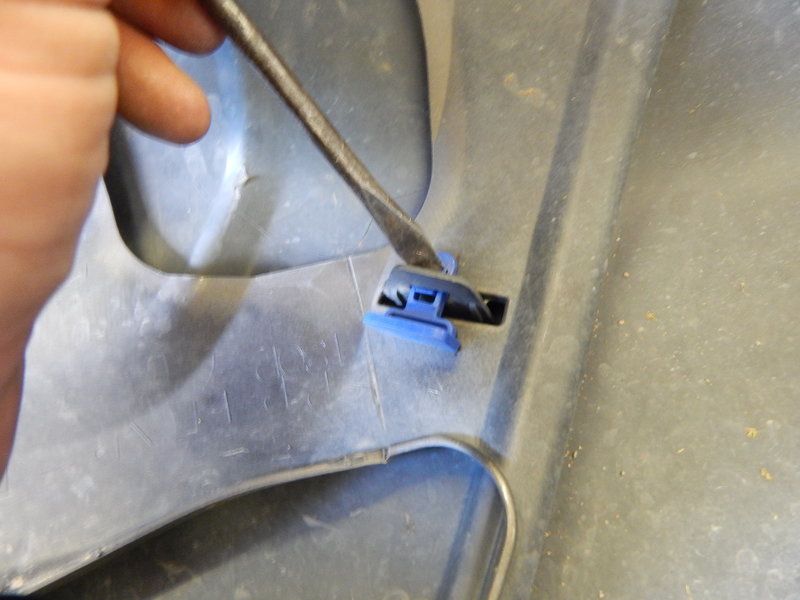

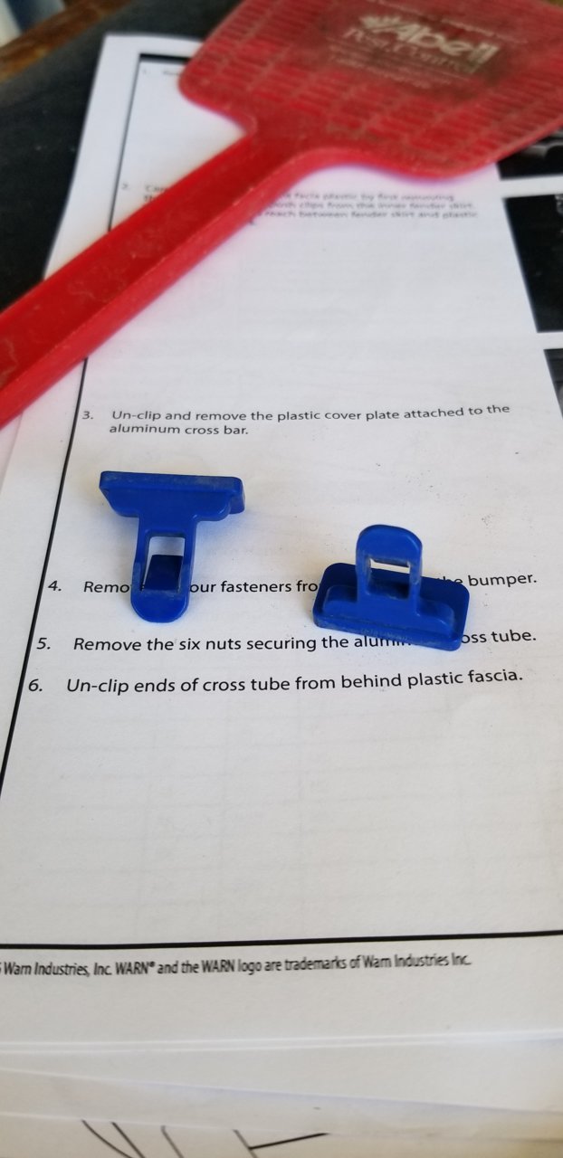

    these fell out trying to remove aluminum bar anyone know where they go:annoyed:
  8. Apr 21, 2018 at 11:14 AM
    #308
    Blazingbluesport
    Blazingbluesport Well-Known Member
    Dec 1, 2015
    #171181
    1,426
    The OC!
    2016 TRD Sport 4x4 double cab.
    No idea. Weird.
  9. Apr 21, 2018 at 5:26 PM
    #309
    sagexp
    sagexp Well-Known Member
    Feb 6, 2017
    #209799
    512
    Back home, AZ
    2002 Tacoma DC 4X4 2017 Tacoma DC 4X4
    As I recall those are for the bottom front of the inner flare (one each side).

    There you go, his look brand new, maybe they got away from an installer at the factory.

    thx a lot I had no idea
