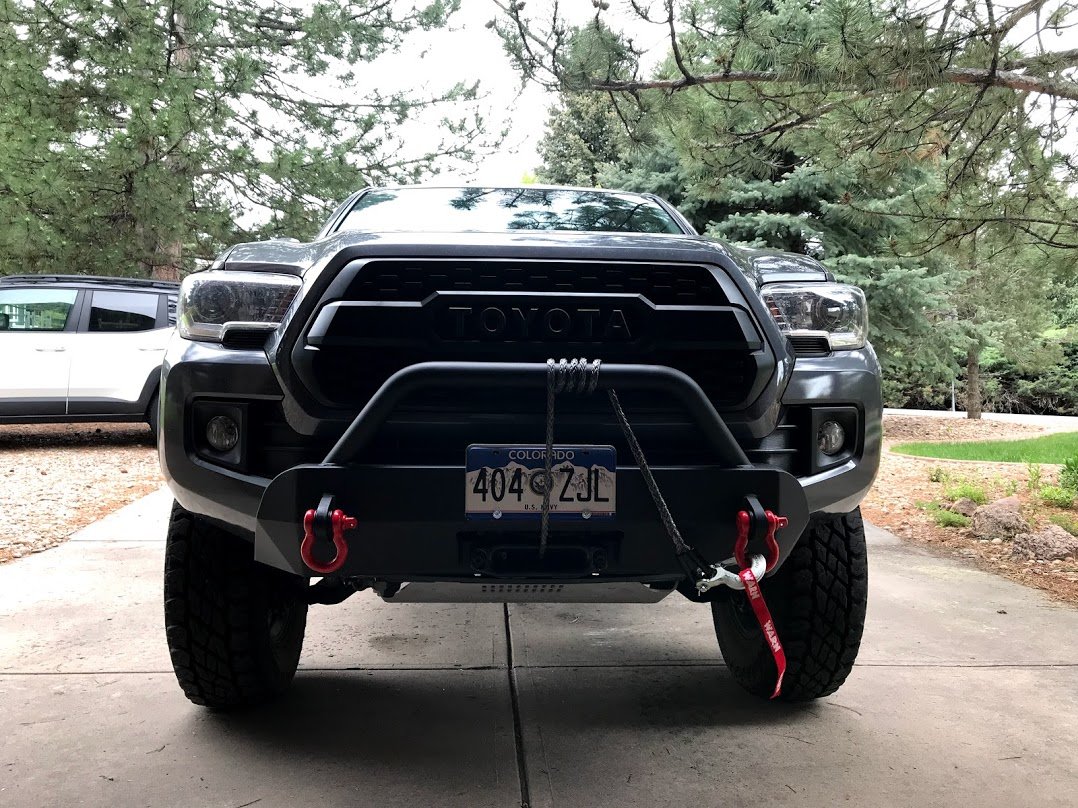

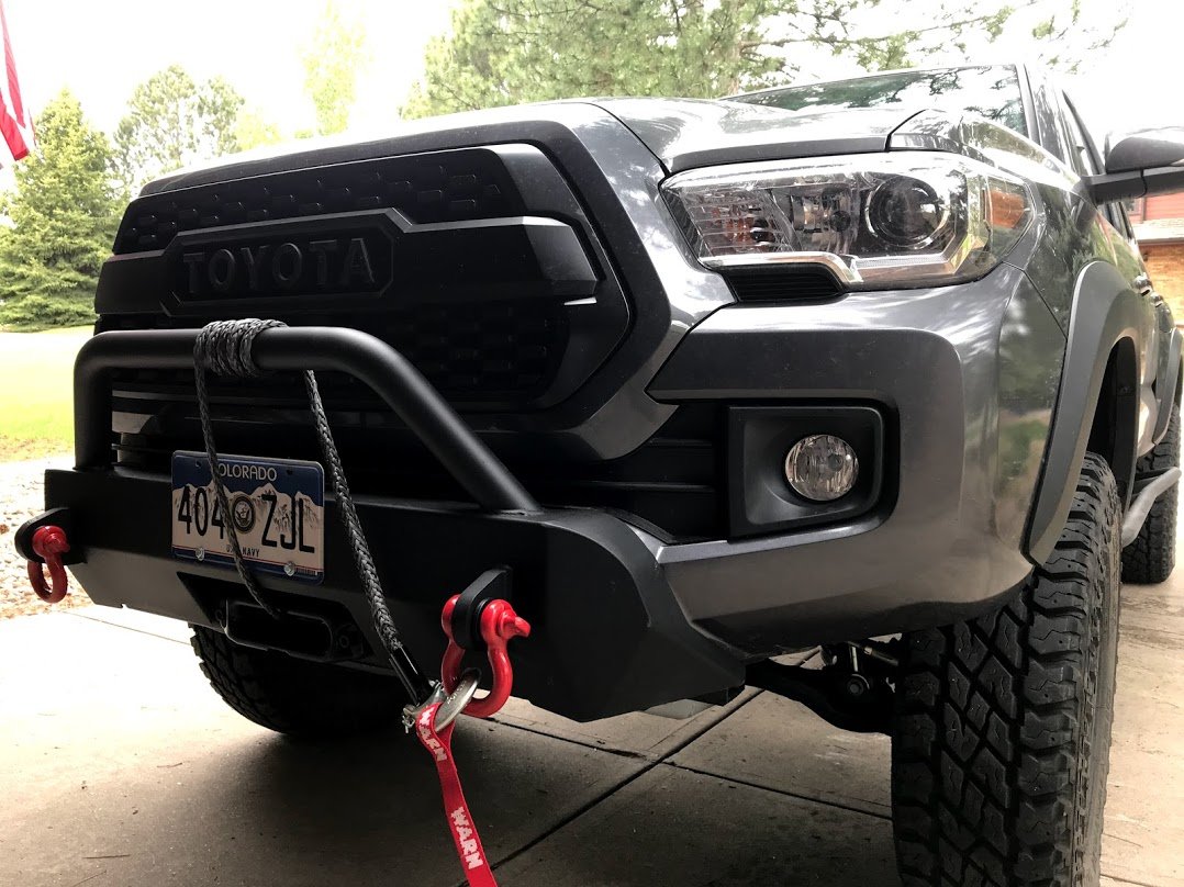

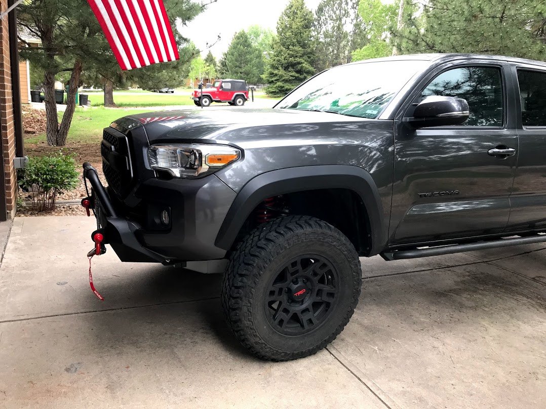

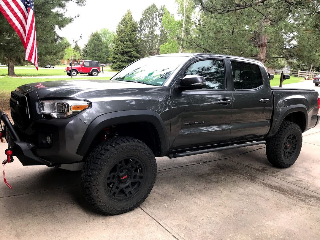

    I've read this whole thread more than once, and have yet to see anyone authoritatively answer this question:
    Does this bumper interfere with 2018+ TSS sensor? Yes and No. How's that for authoritative?
    I did my install yesterday with a Warn VR10S.
    I have the TRD Pro grille, and for me, yes it interfered. It would be fine for a few miles, but on each of four test drives (winch rope wound up, license plate removed, etc.) I would get the "pre-collision disabled" light.
    Because I love the bumper so much, there was no way it was coming off. So, with a little inspiration from our Tundra brothers, I successfully relocated my radar sensor to the driver's side of the "A" in the grille. This is the forum thread that got me going: https://www.tundras.com/threads/2018-tundra-tss-successfully-relocated-to-trd-pro-grille.19726/. In our Tacomas, it was a little easier, because I was able to just take the silver square-back nuts and super glue them to the inside of the grille, instead of cutting off legs and JB Welding them into the new location. Once that cured, my sensor screwed right in, and I've put over 100 miles on it today without issue.
    Having said that, if you have a grille where the radar mounts behind the Pillsbury Dough Boy signaling a touchdown emblem, it is high enough that you should be good to go. I debated putting that grille back on mine, but I just couldn't drive around like that!
    If the Tundra thread isn't self-explanatory enough, I'm happy to answer any questions.

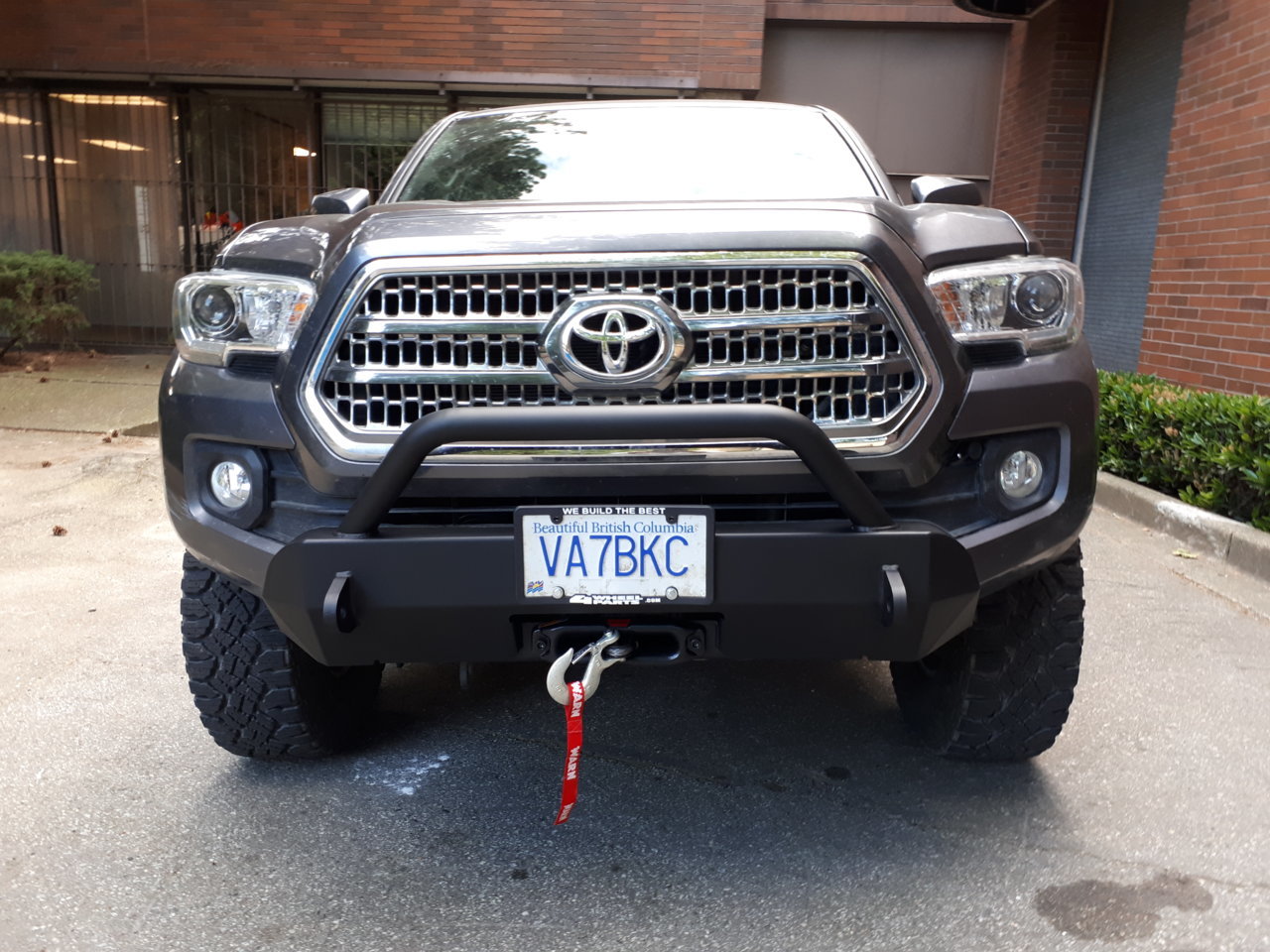

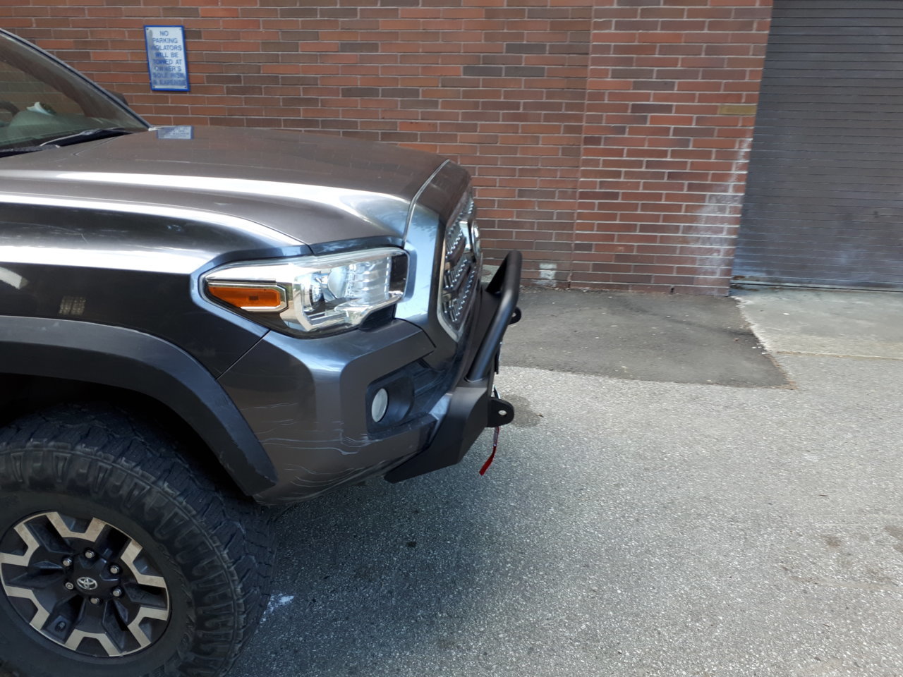

    Got mine today...
