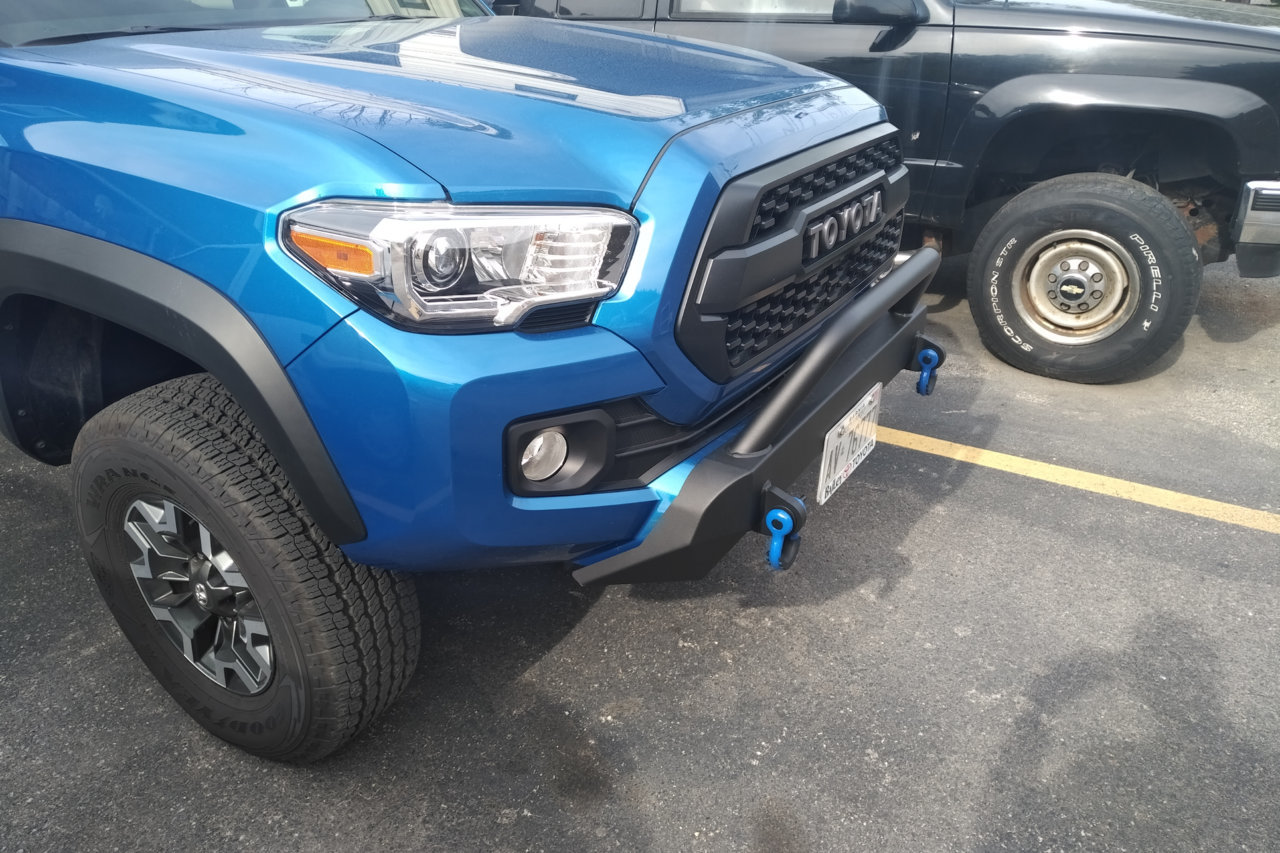

    So I finally got mine installed and couldn't be happier!
    I have one question though that hopefully people here can help with. In Ontario we require front plates as do quite a few states and other provinces.
    What have you all used, and how did you mount them?
    I found this write up with a lot of options listed but was hoping to get some opinions on them.
    https://www.roundforge.com/articles/winch-license-plate-mounts/

    Yes, that is how I have it now without a winch, but it is blocking proper access once a winch is installed, and using the bottom plate holes causes rattle.
    I'm simply looking at other options right now for when I get a winch.

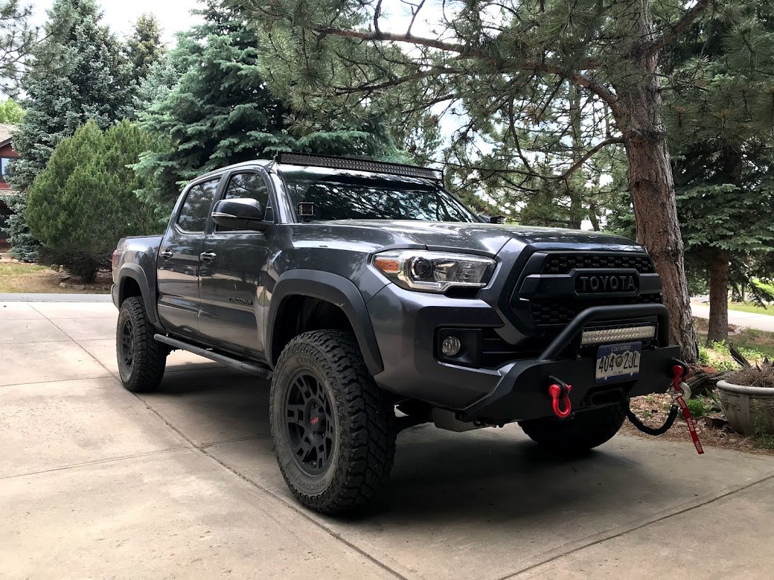

    BOSS 3"/2" with SPC UCAs, 33" Cooper ST Maxx on TRD Alloys with Bora 1" Spacers, Warn Bumper & Winch, RCI Sliders, Truxedo Pro X15, Sway Bar Delete, TRD Intake, MBRP Exhaust, TRD Skids, TRD Grille.

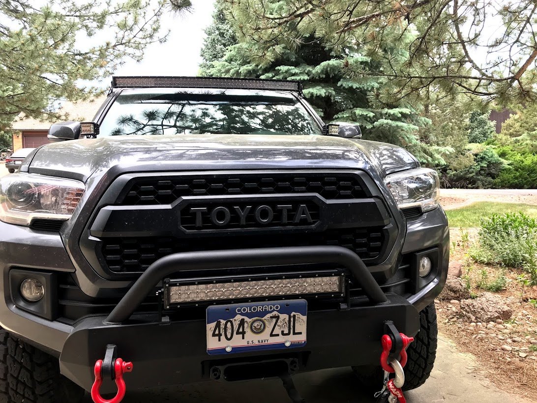

    Actually, you have the bolts running through the TOP holes in the license plate. If you run the bolts through the BOTTOM holes in the plate, it raises the plate well out of the way of the winch.
    Case in point:

    I tried that for a few days but I got a lot of rattle. Our Ontario plates are metal.
    I contacted Cascadia 4x4 about their Flipster V2, and they suggested mounting it upside down, so that it flips down when using the winch.

    Weird. My plate is metal too, and I've never heard a peep from it, and it's bolted on solid as a rock. Did you use lock washers? If not, it's bound to rattle loose. Perhaps a strip of silicon to insulate would help?

    I used lock washers and also 1/4" rubber washers, hence why exploring other options.
