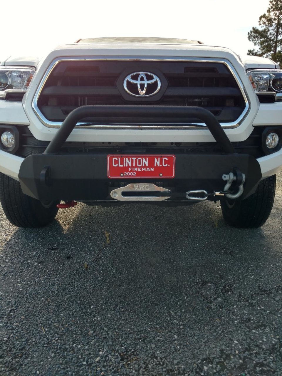

    Has anyone mounted this Warn Hidden Winch Bumper on a truck with the TSS on the lower part of the grill like. Pro ?
    I wonder if you could get it without the hoop ?

    I'm really interested in the question too. From the pictures, I'm pretty sure the TSS is going to be blocked. I've considered calling Warn to see if they are going to make a modified version now that all the forthcoming Tacomas are going to have a problem. I think TSS is mandatory on all the new ones.

    Called Warn. They do not have one without the hoop. And don't do a special order that deletes the hoop. Too bad. I like the no cut design. So it's off to SOS. C4 . Or others. Maybe

    I saw a post somewhere in TW of a guy that just cut off the hoop. He was able to rig a small bar light mount where he did the cut that gave it a finished look. A bar light wouldn’t go up as high since it’s flat so it wouldn’t block the TSS. I guess the option is cut off the hoop or go with another brand and cut up the truck.

    Back a bit, @Intrepid posted the following about the Warn mounted on his '18 (I believe it is) with the TSS and is appears as though it doesn't interfere with the functionality of it at all.
    Perhaps an update after a few more months @Intrepid?

    Yea I thought about that . Just cut off the hoop. Weld on a couple of tabs where you made the cuts and bolt on a light bar. Just don't want or need the light bar.

    I don't think Intrepid has a Pro Grill. That hoop is gonna be a problem if you do. Guess Warn won't sell as many if they don't do a no hoop option.

    @warn, are you listening? Make a lower hoop version and there’s multiples here that'll buy!
    Problem is: even though all tacos now will come with TSS, they mount in different locations and the Pro grill is a minority.
    Solution: three options... High hoop, low hoop, no hoop. Only the low hoop is really any work at all. No hoop is easy.

    FWIW, I talked with Warn about 30 minutes ago. The agent I talked with was unaware of the issue with the hoop and the Tacoma Pro grille. He indicated that they had already redesigned the hoop once to accommodate Toyota enlarging the emblem (probably to manage the TSS install). But he wasn't aware that the TSS was in a different location on the Pro grilles. I suggested that a hoop-less, or very low hoop would still sell well.

    We lowered the hoop down to clear the radar. I have heard however if the truck is one of the TRD Pro models they moved the sensor down from the emblem which puts it right behind the bar which would interfere.

    Looks like OR models are GTG with the Warn Bumper, but not so much the Pro or others with the TSS sensor mounted in similar locations. I noticed that there was no mention fix in works for the Pro.
