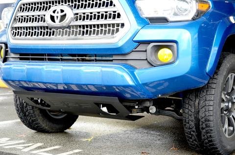

    Do any of you that are running this have a front skid, or more specifically the BPF skid?

    Yeah.
    I have the stock TRD Pro skid.

    17x9 FUEL Nitro 6 wheels with G2 285/70 R17 tires Dobinson struts and coils with Deaver AAL JBA UCAs Warn Semi-Hidden winch mount Smittybilt XRC9.5 RockyHill sliders SprintBooster Pace Edwards Tonneau With Yakima bars and bike carriers TRD Pro grill UpTOP Bravo rack SP-9100 Meso mirror lights and interior mods
    I’m running with the RCI skid with this bumper.

    After looking at pictures I think the BPF goes up too high and I'm going to have to cut a couple inches off the front. Not the end of the world really

    I don’t have a picture of the underside but I didn’t have to trim anything but plastic notches on my install with skid.

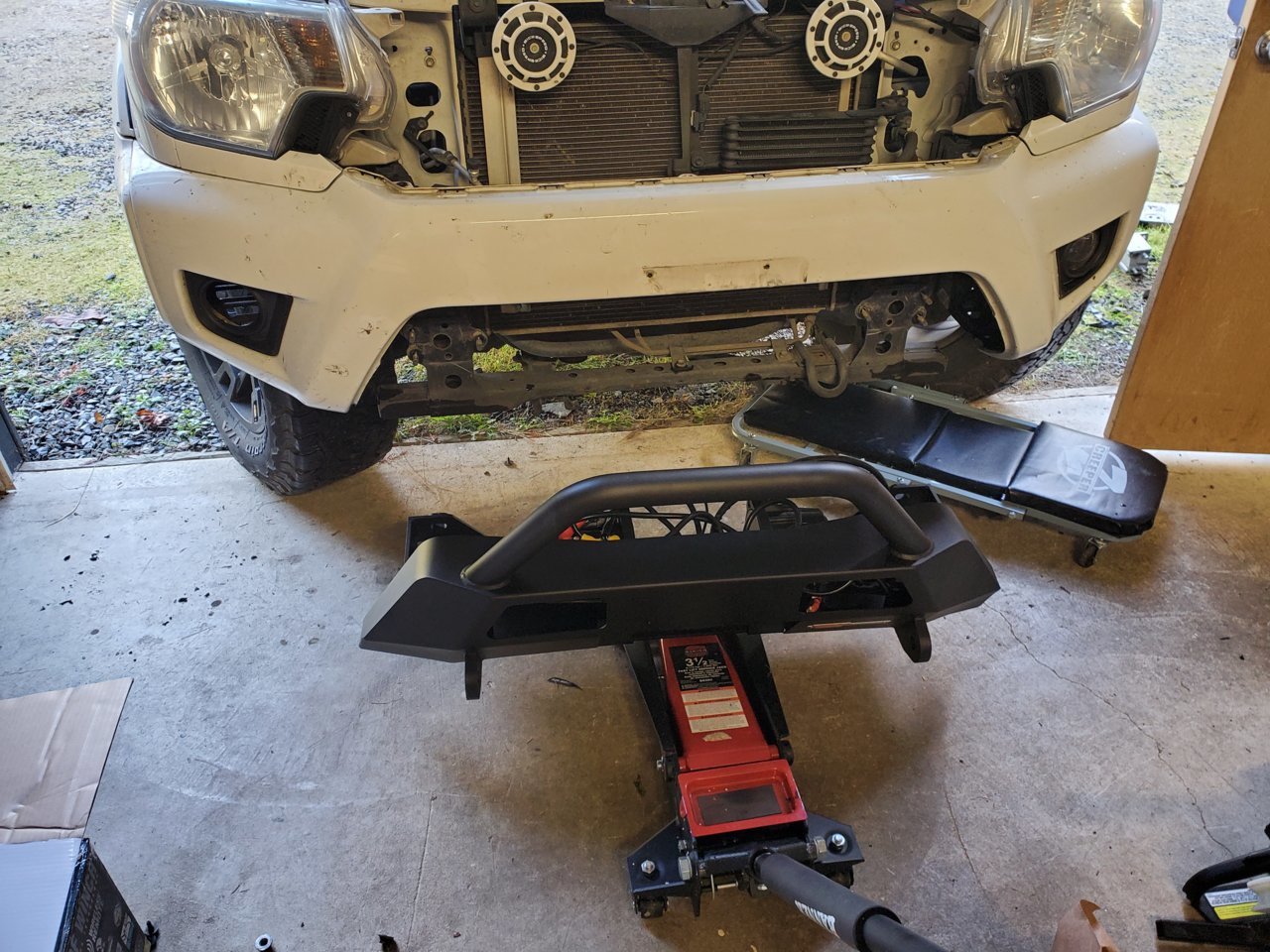

    For those that have installed this, did you put the winch in first? Or after it was mounted?

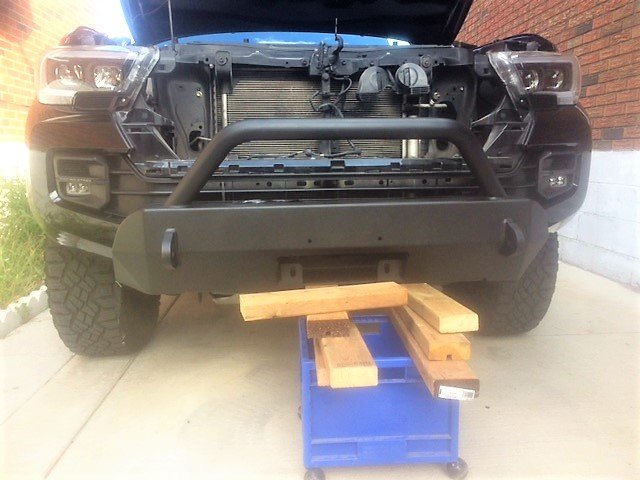

    I remote mounted my controller and installed the winch in the bumper first. Didn't have to move anything else that way.

    I ended up just setting it in and using a floor jack to lift the whole thing up. Then securing it afterwards. Was pretty painless that way

    Same idea for me,
    but I used a rolling milk crate and a couple 2x4's,
    balanced the bumper on the 2x4's so I could tilt it easy during the install to clear the facia and the right height to slide on the studs.
    Made it very easy.

    I had it right there next to me. I was just gonna muscle it up, then the dumb dumb (me) realized there was an easier way
