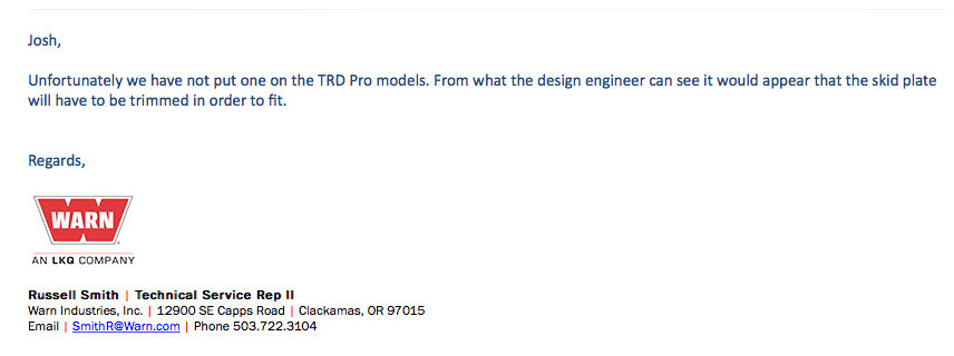

    FYI for Pro owners interested in the WARN bumper... I messaged them this "Hey, I have a 2017 Toyota Tacoma TRD Pro. I'm interested in purchasing the Warn 100044 - Warn Winch Mount. I've read online that there may be trouble installing this product due to the factory skid plate on the Tacoma Pro. Before I purchase, I would like to confirm that this won't be an issue. Thank you"
    This was the response I got:

    I have seen photos of the SSO with the Pro skid.
    However, given that the Pro skid retails for nearly $400, you could always take a chance, buy this bumper and if it doesn't work, resell your skid for $250-300 and then have half your bumper cost repaid.
    I'd love to see how they work together as I'd like both myself.

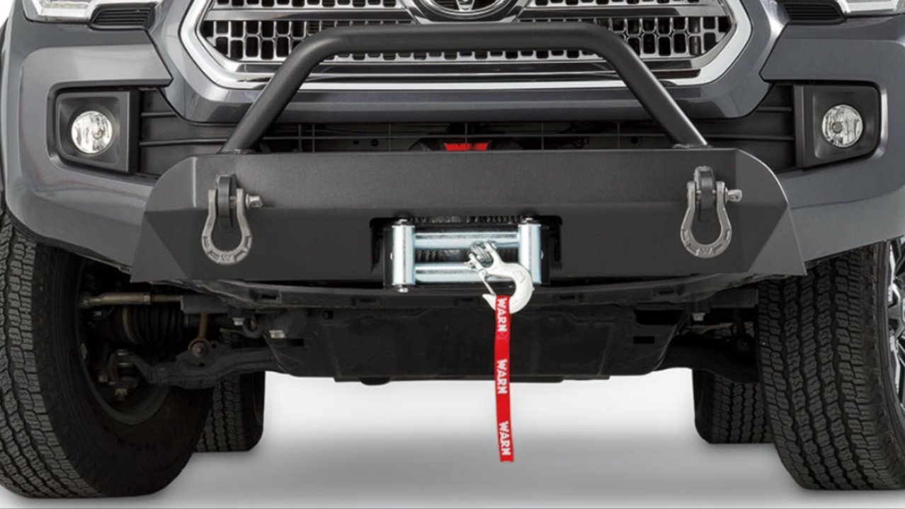

    EDIT:
    Found a photo of the Warn shown down low. Unless this is weirdly photoshopped you can actually see the OEM cover ever so slightly under the Warn piece.

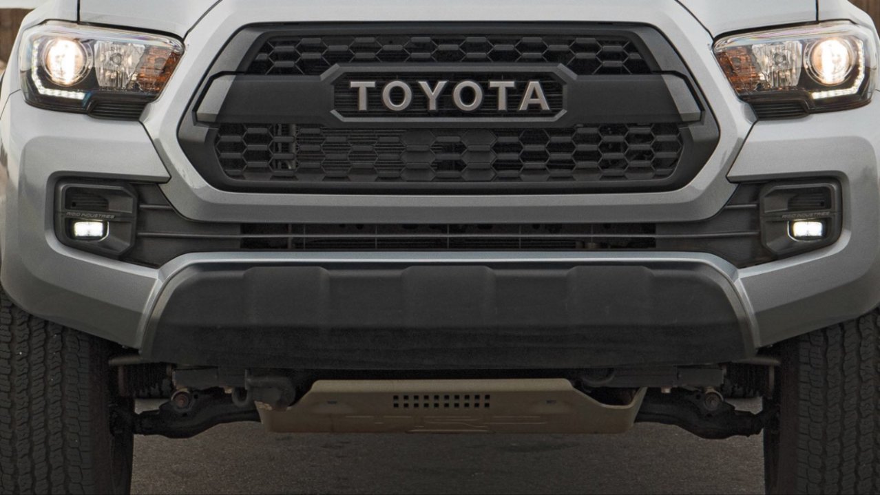

    If you look at the Pro skid it sits considerably under the OEM bumper. There's no way they hit.

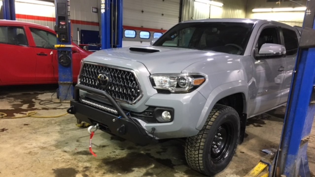

    I can't believe the dealer installed the bumper on a '18. The millimeter radar sensor is partially blocked by the hoop on the bumper. Could open themselves up to a liability.

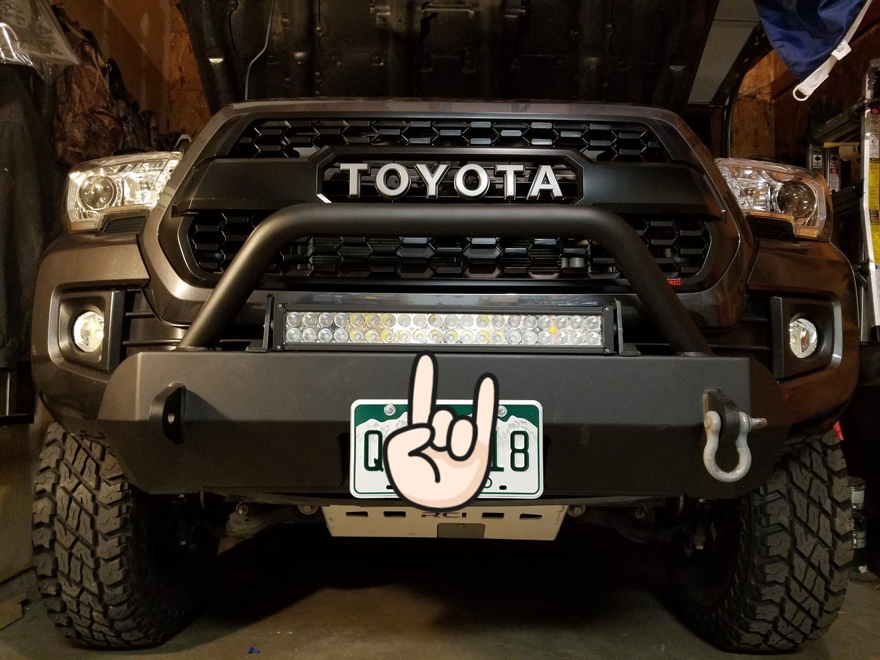

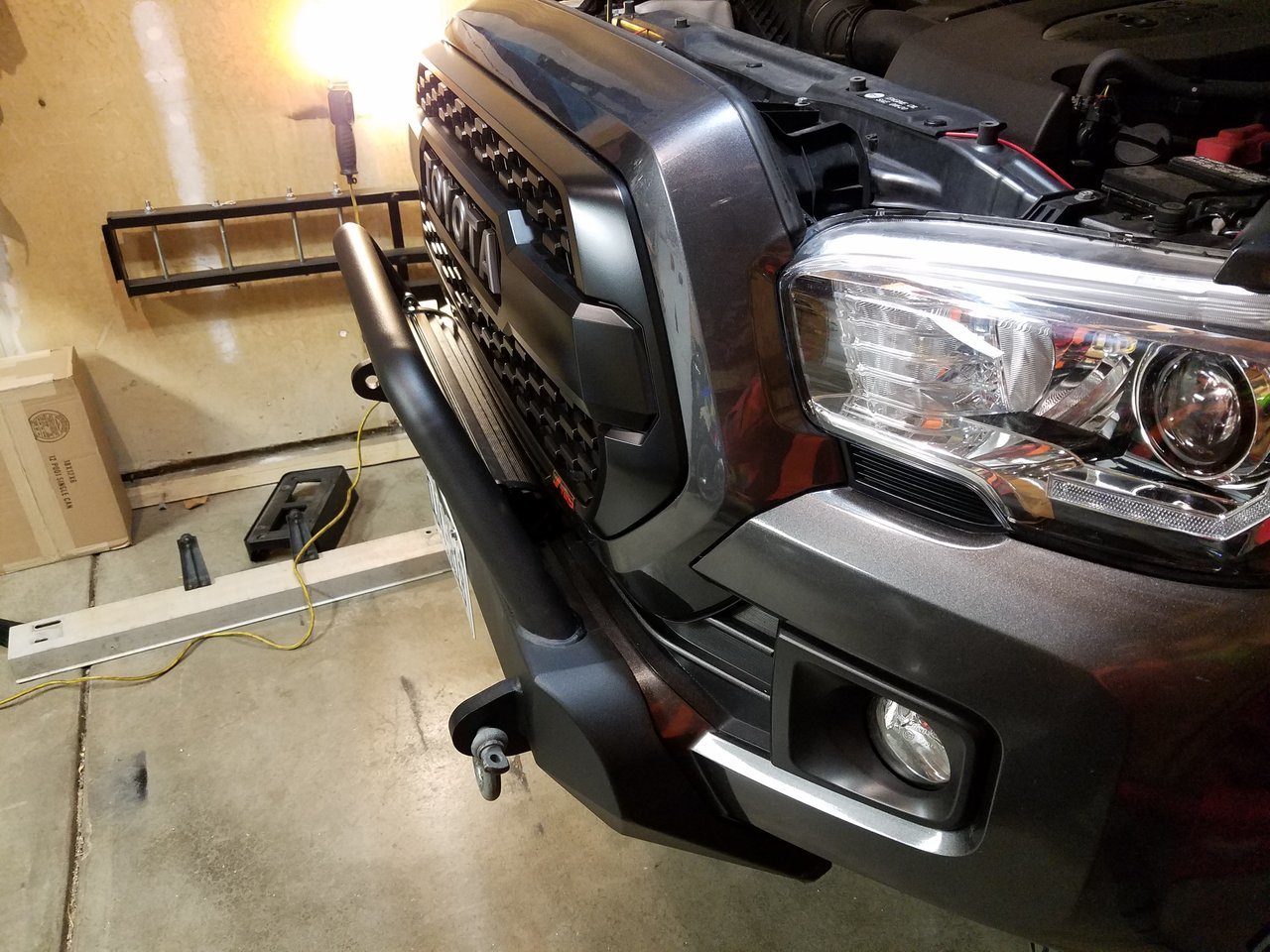

    Received today and installed tonight. Haven't picked out a winch yet still deciding...

    How was the install? Care to share a few details? Did you do it exactly like the instructions say? Looks great.

    Yes just followed the instructions. Took a few more extra steps for me since i relocated my light bar and drilled out the bumper and my brcket to fit it where it is. Still need to cut the bottom plastic to install the 2 brackets on the bottom of the bumper and frame but no big deal. When I pick out a winch I'll have to take off my grille, crossbar and latch apart again to bolt the winch up. I did a test run and moved that bar and latch to the side. It wasn't to bad.

    How much space is there between it and the skid plate? Trying to understand it the pro skid plate will really need to be cut or not

    Ill take some more pics in the mornings when i bolt up the bottom brackets. Ill get y'all some good pics
