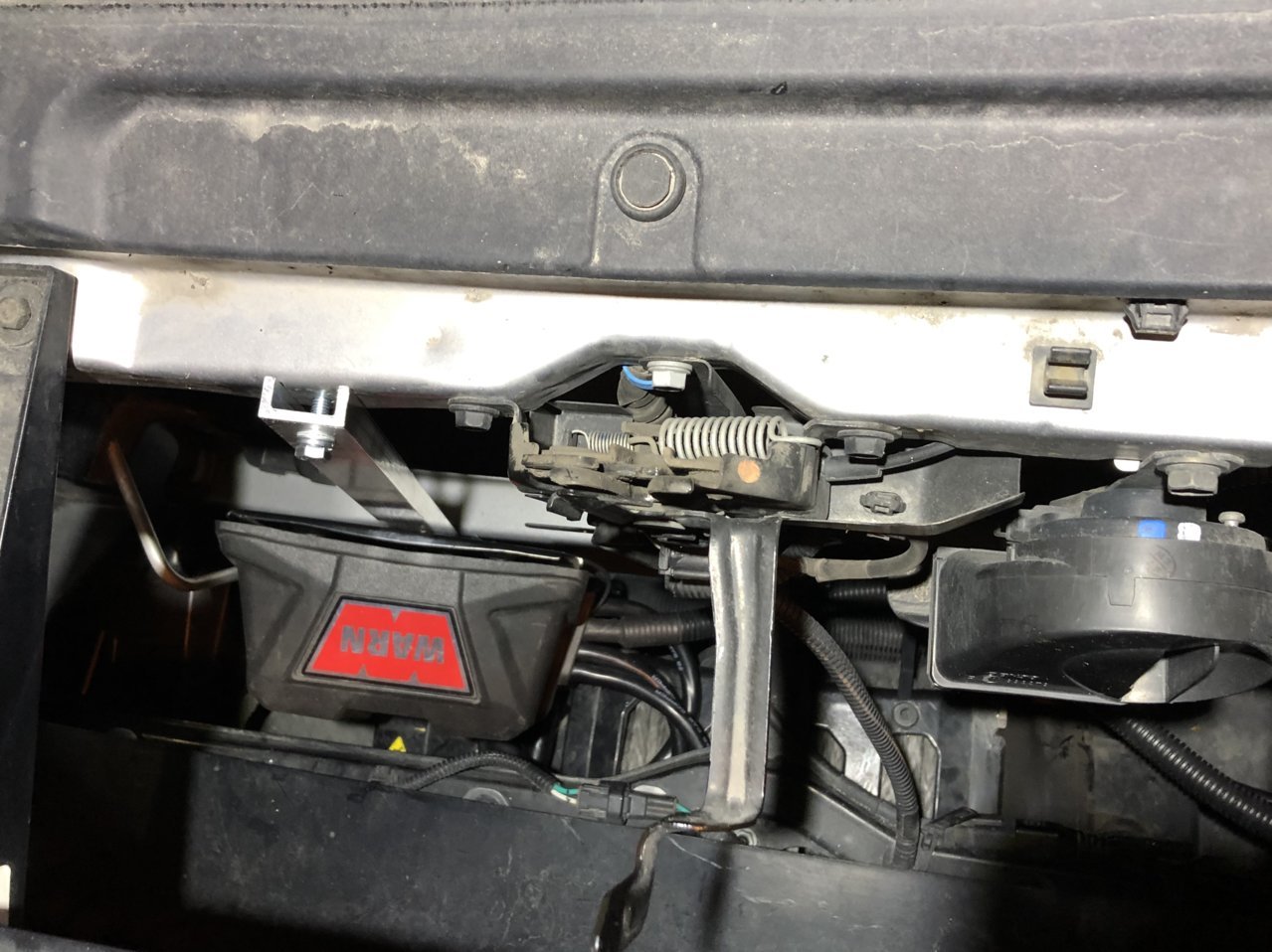

    I used some aluminum C-channel and make a bracket.

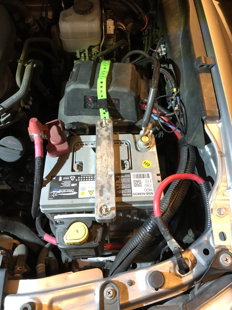

    I mounted mine on the drivers side behind the battery. Fit like a glove, but my truck is a 2014 (not sure about a 3rd gen). Also I bought the non-platinum, so had to run the remote plug into the cabin... mounting in the engine compartment behind battery just got me this much closer for the remote plug mount.

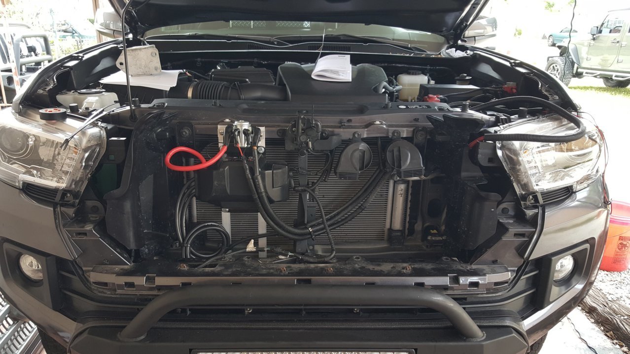

    My temporary solution is looking like this (ignore the power and ground leads zip-tied to the frame, haha). Yes, that is a ski strap wrapped around the fuse and relay enclosure. Winch is Warn VR-10S. I also have an idea for a bracket mount by the power steering fluid reservoir... has anyone else done that?

    Mounted control box on alum hollow bar stock. Does not restrict airflow more than stock because its behind the bumper.

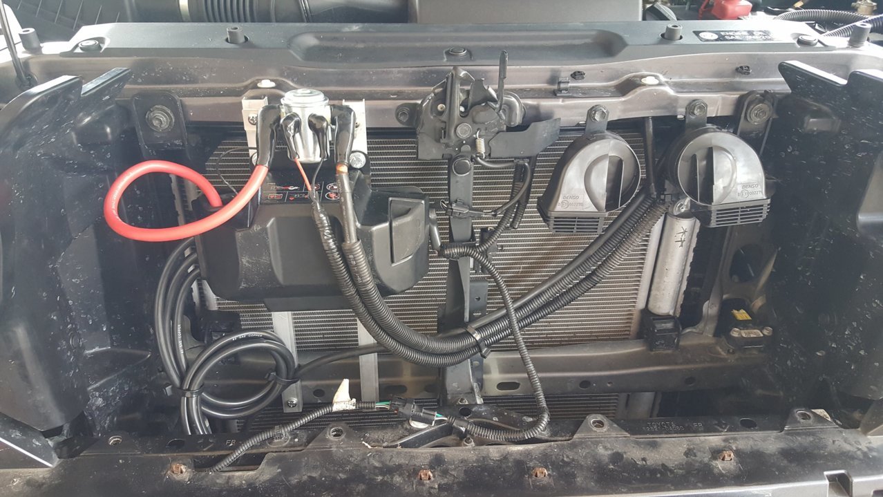

    I built and installed a proper bracket about a year ago and never posted. It's about 18" of aluminum U channel, along with the bracket from WARN for remote mounting.
