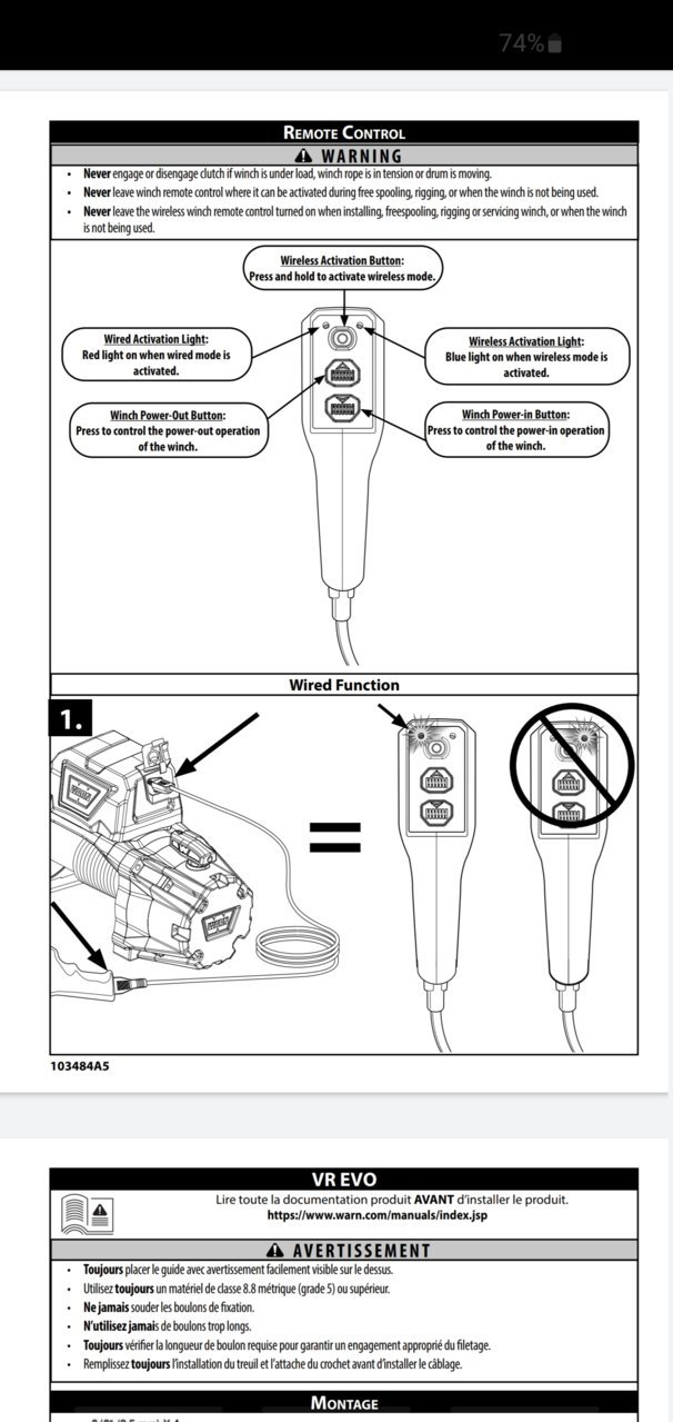

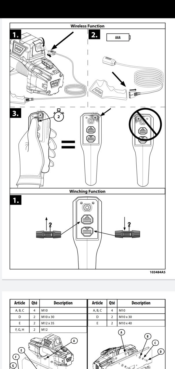

    Your winch controller should have two buttons on the top, the left one is for wired control and the right one button is for using the controller wireless. Just pull the cord out of the hand control and press the right-hand button to use it wireless.

    It's literally in your manual
