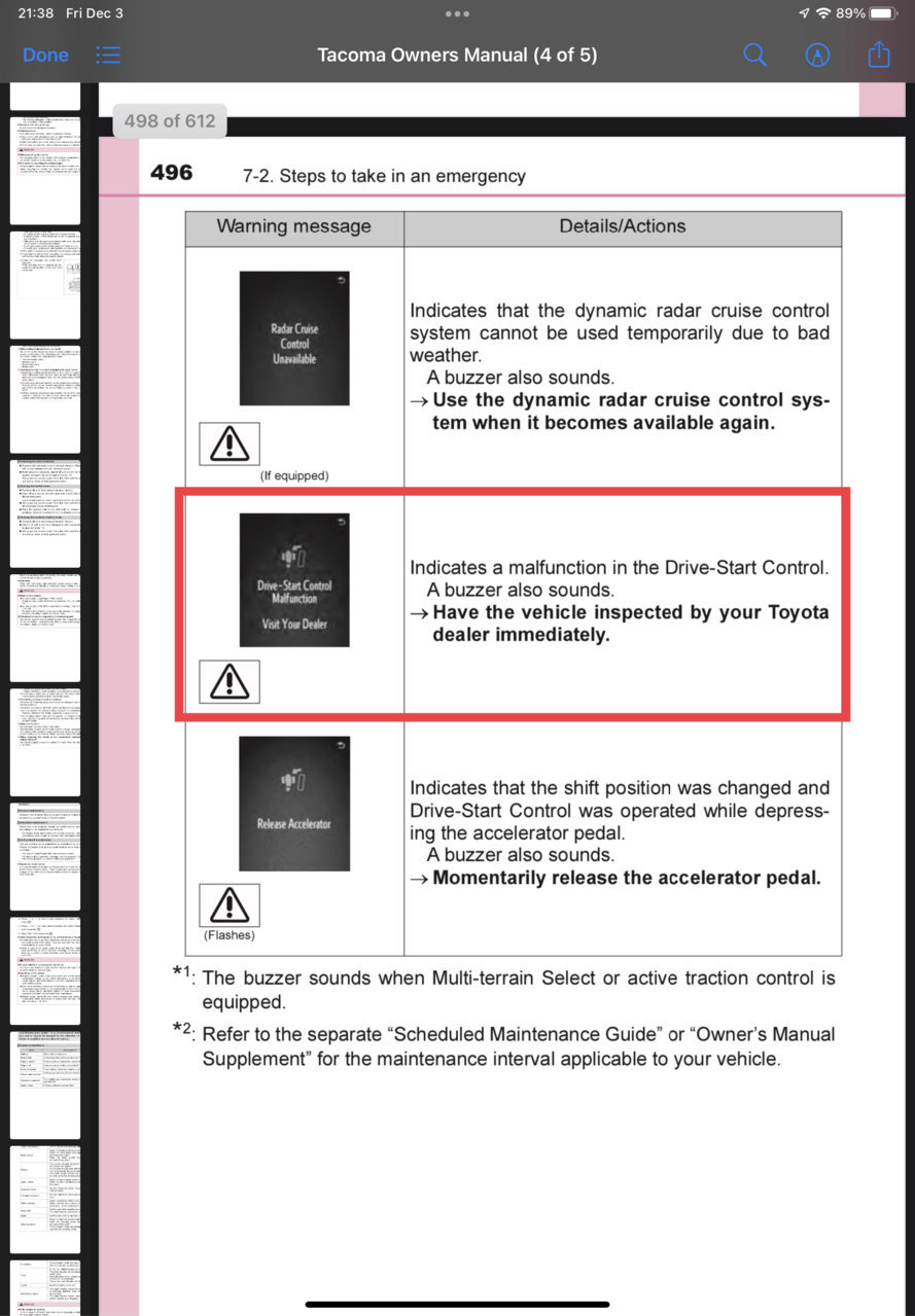

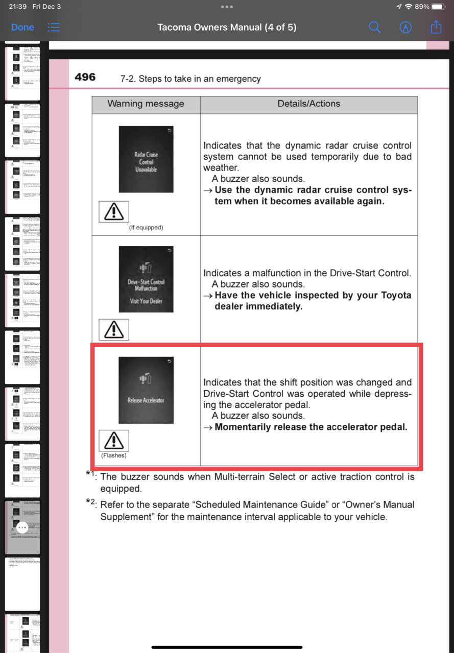

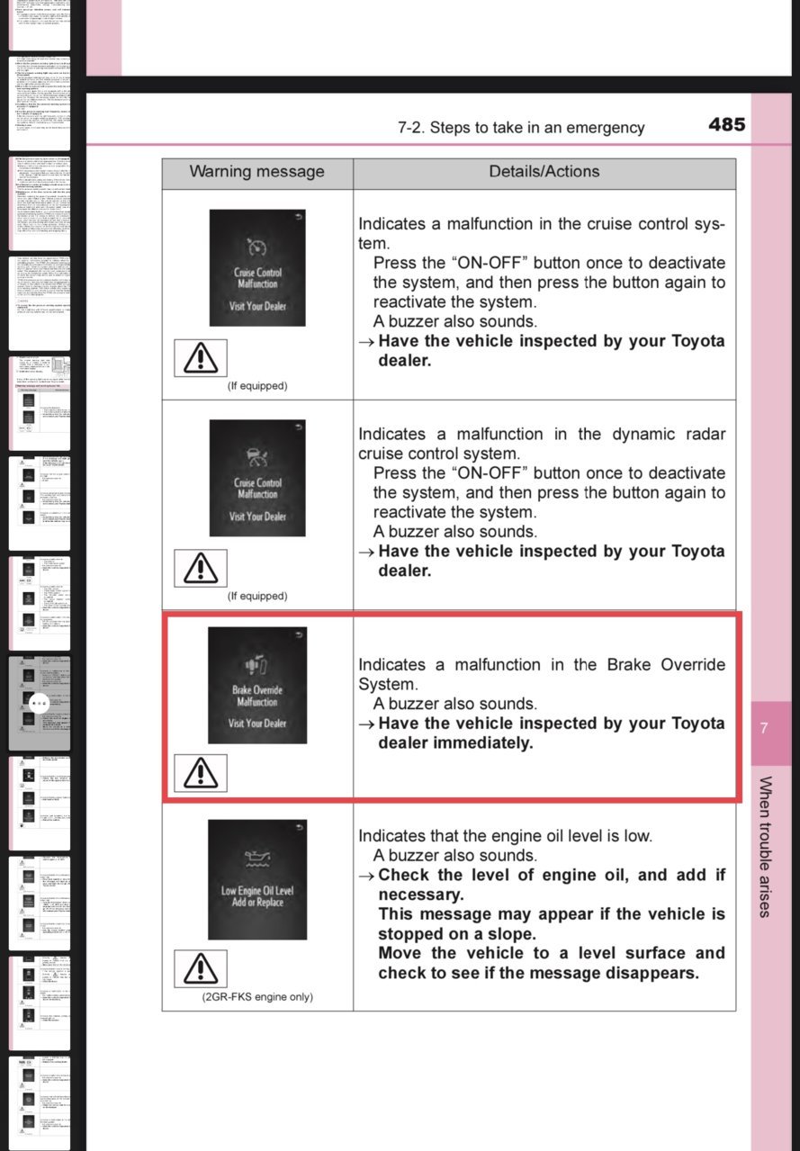

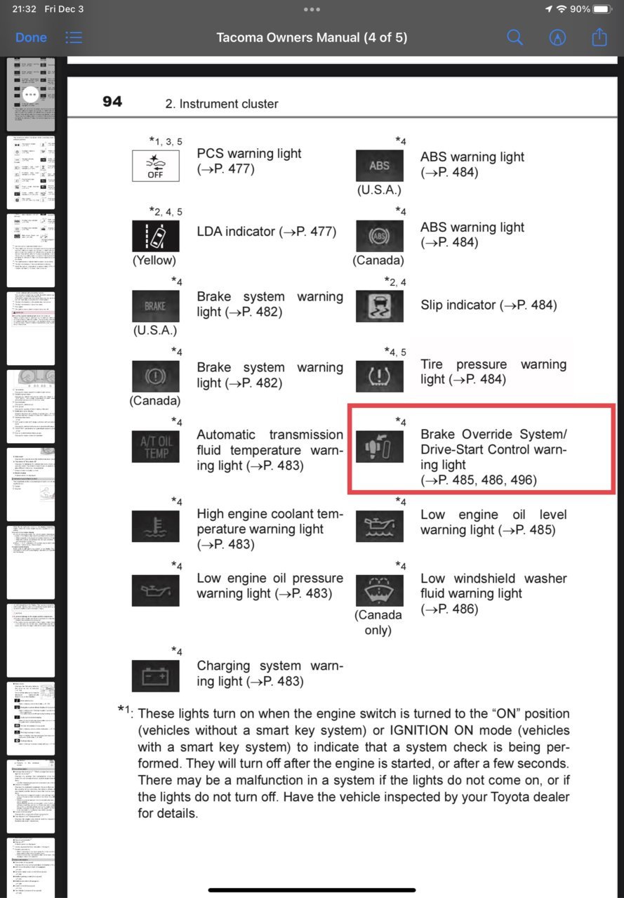

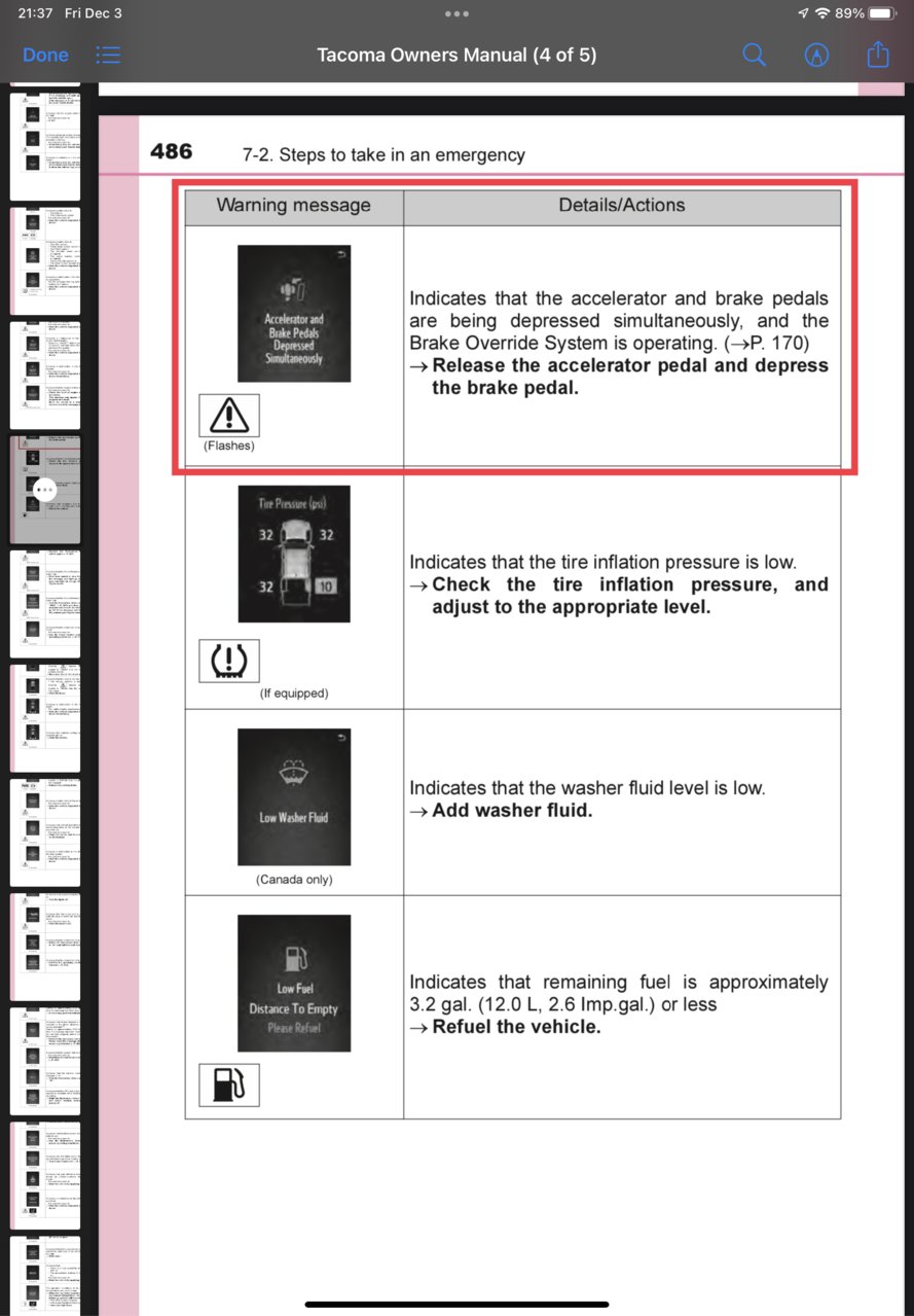

    I have the .pdf manual for my 2020 downloaded to my iPad. Makes it real easy to look things up. Very handy. So if the truck is not pissed at you for being at the mall too long, it’s one of three things according to my 2020 manual. Don’t know which of the 3 you experienced and how serious it may be on your truck. I dunno if a trip to the dealer will help. Hope this helps.

    Generally, when a warning light comes on, the solution is simple. FIRST place to begin is the Owner's Manual. Then work through the steps as outlined by @Canadian Caber from the Owner's Manual. These basics will generally resolve the problem. If not, then need to look at any add-ons or mods. Still no resolution, then off to the dealer.
