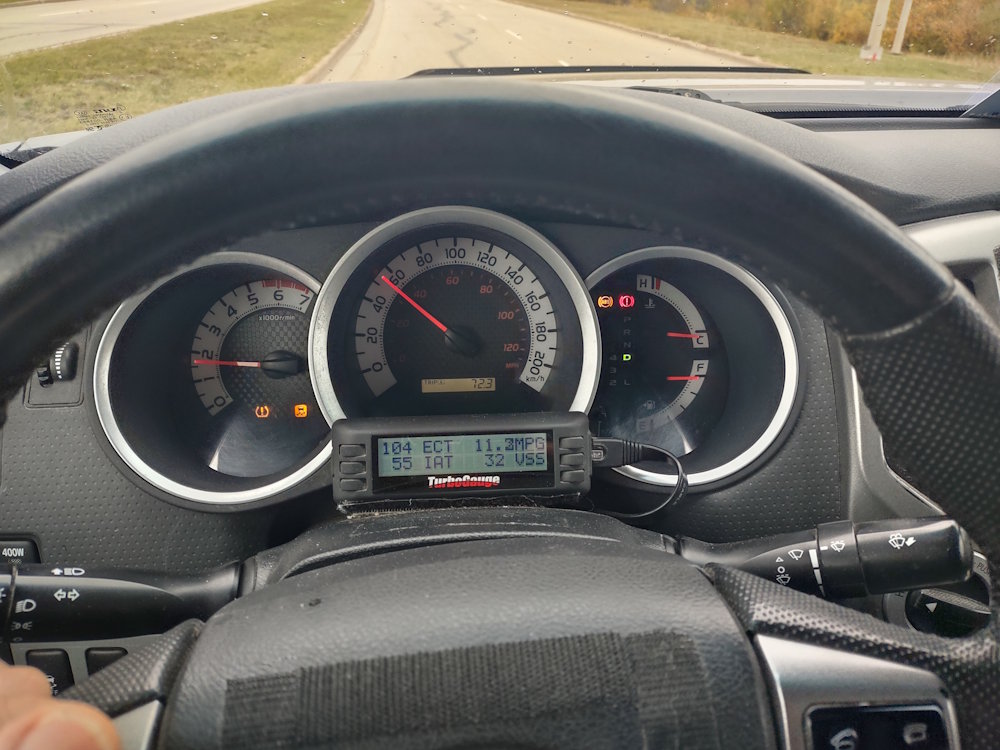

    Head gasket was going on my 2013 Tacoma with 530K km. Also the rear seal was starting to leak, so I sourced a low mileage 1GR-FE engine and had local shop replace it.
    Other than the AC no longer works, all was good. Warning lights after 1 week:
    I am noticing some fluid seepage from right rear wheel, but I was thinking it was diff oil. Replaced rear seal on drivers side about a year ago, I am thinking passenger side needs new seal now as well. However, I am thinking it could be brake fluid too. Will be digging deeper tomorrow.

    ETA: no codes according to my TurboGauge. I also disconnected battery to try and clear warning lights, didn't help. Ignore tire pressure light, one of the sensors is bad.

    Given which 3 lights are on. Id start looking at ABS wheel speeds sensors. You'll probably need a slighty more serious scanner than a standard cheap one that only reads engine DTCs
