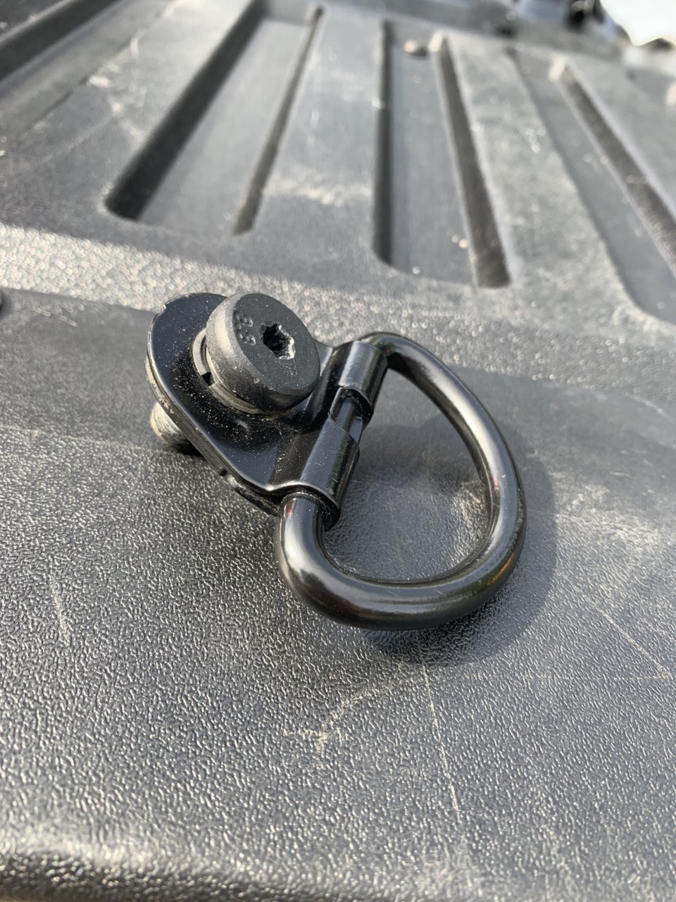

    While everyone’s here, for those of you that have installed the bed stiffeners, have you found any use for these? I would hate to get rid of them. image.jpg
    Dfpftw and boston23 like this.
  17. May 16, 2020 at 1:54 PM
    #17
    Skydvrr
    Skydvrr IG: @kalopsianick
    Sep 13, 2017
    #229889
    12,654
    Nick
    YMH
    Black '17 OR
    Lot of people use em on the bed track
    boston23 likes this.
