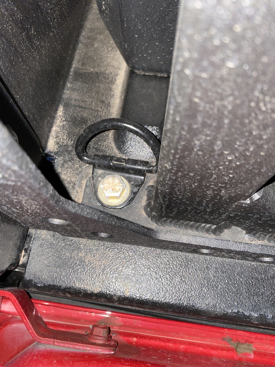

    You can take those D rings off and put them in the middle of the bed or some other location.

    Any reason to not just pick up a 6mm grade 5 or better flange bolt and replace the thing if you are already taking it out?

    Pro-tip for next time: remove the taillight and use vice grips to turn the bolt shaft out from the back. I snapped the head off my bolt too over tightening it during install.

    Snapped mine too and had to drill it out of the factory screw holes. My fault though because I used an impact drill :taco:

    I was able to reuse my tie downs with my bed stiffeners by buying a couple grade 9 bolts of the same diameter but a touch longer from the local hardware store. It kind of became a moot point after I installed my Decked system.

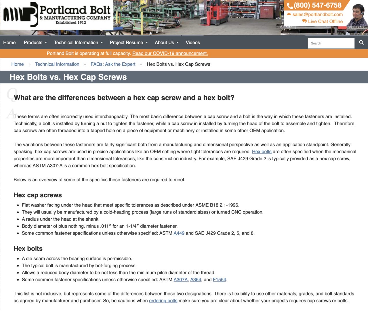

    Well, this is one answer:

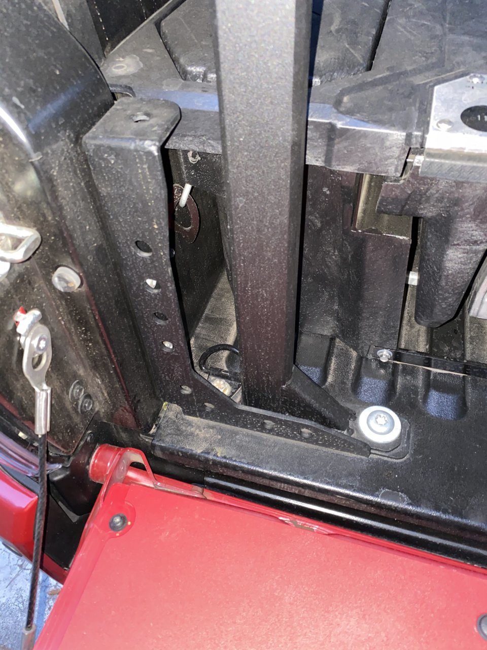

    Obv I broke a bolt, thats why I'm here. But I am noticing that it snapped probably because of the cross tension that was being put on the bolt. After it snapped I noticed that the stiffener bracket and the hole we not aligned. Is this because my bed has already warped?
    I wouldn't think so as the truck is less than 4 months old. And I had a RTT on the rack for no more than a week before these stiffeners came in the mail.
    Whats your take on this and how can I install the stiffeners without needing to muscle them into place lol
