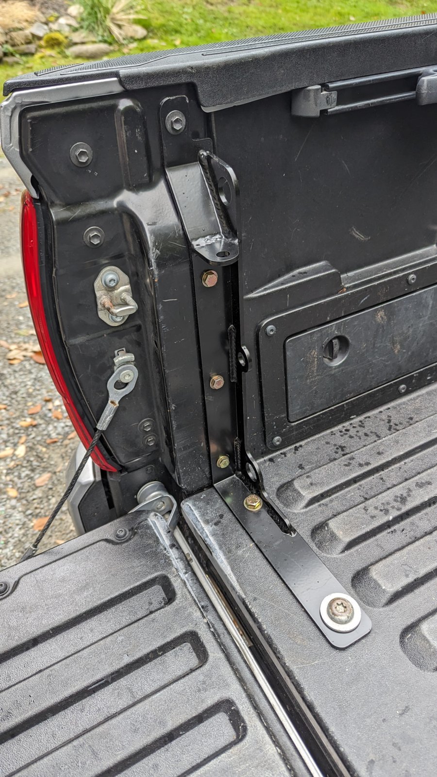

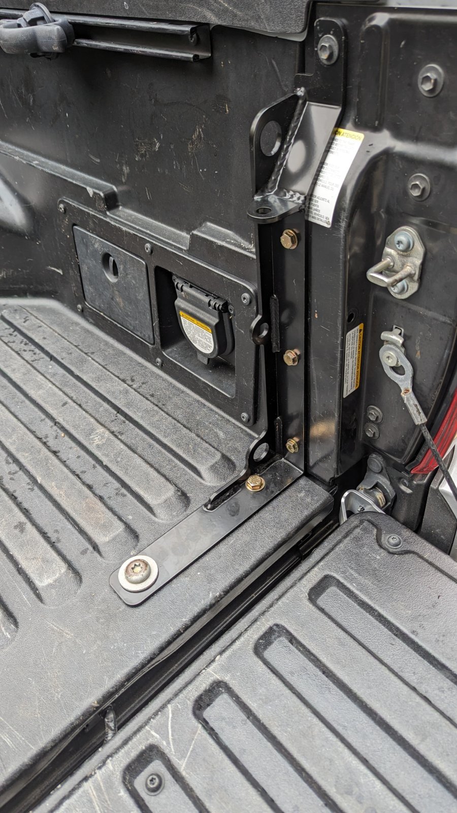

    Did the TC bed stiffeners install today without issue, didn't torque the top bolts, only snugged them as they're not load bearing
    MGMDesertTaco and Koolbreeze7 like this.

    Sounds like a solution that would work without breaking the bolt. Again, this bolt is non load bearing so there's no need to tighten beyond snug. If worried about it backing out, you could throw a drop of locktite on it.
    Skydvrr and soundman98 like this.
