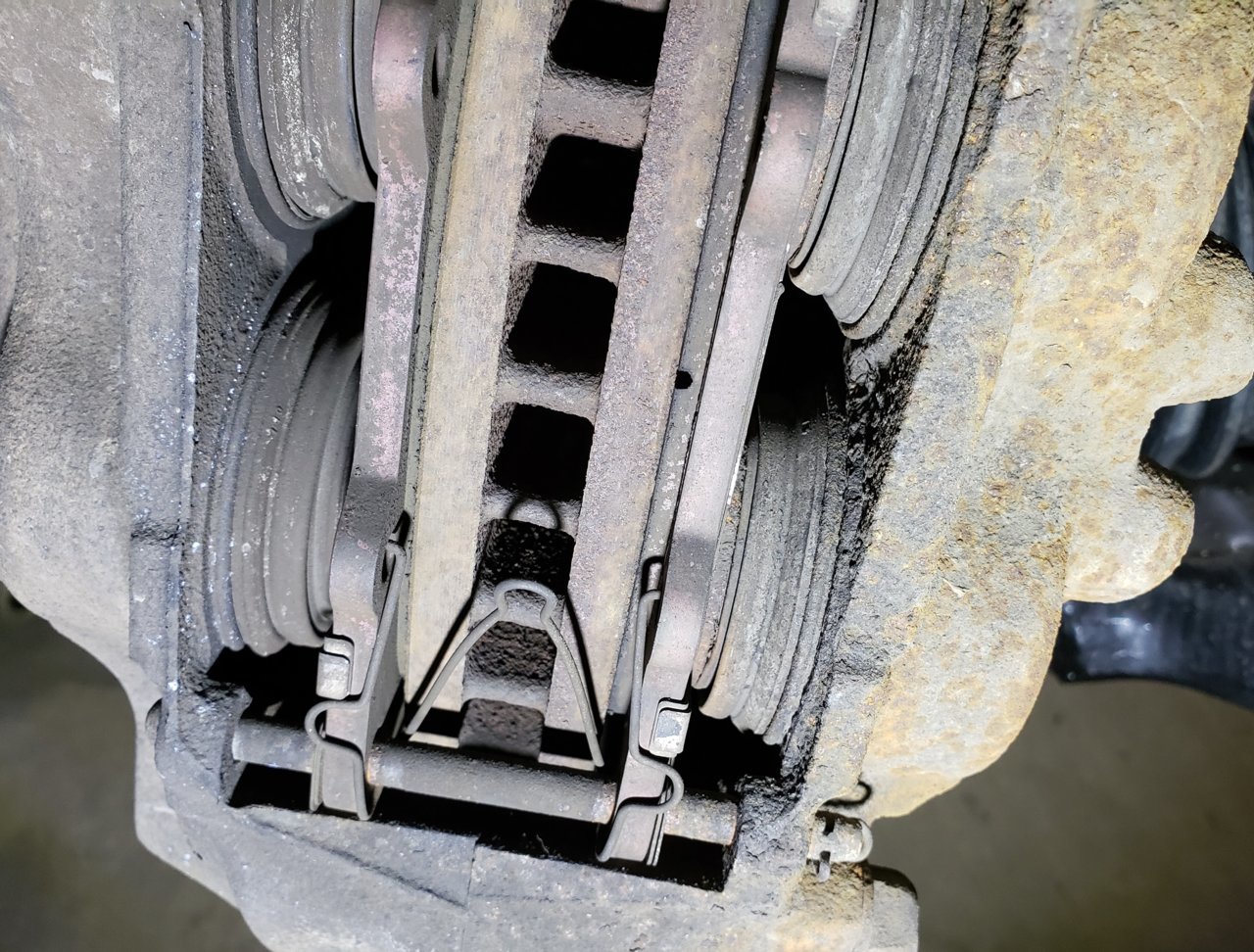

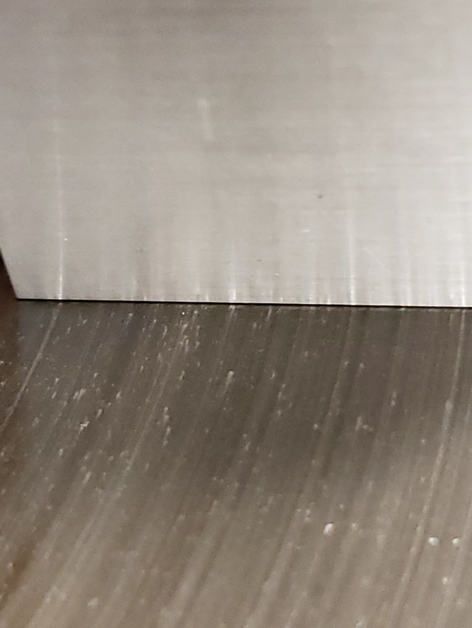

    Here is some pics of my '15 fronts when I changed them .....at 185,000 mi.
    2nd pic show the surface of the rotor with a gauge block on showing the surface (pretty flat). Both rotors measure in at just over 50% left.
    wrightme43 likes this.
