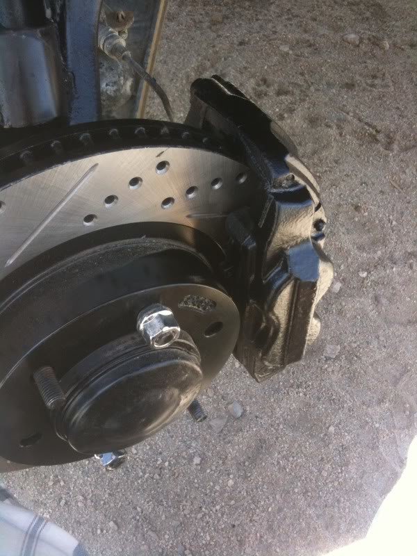

    Oh, now you tell me! I will stop doing that. :D
    On a serious note, wheelers offroad has a great selection of brakes. I like Porterfield carbon kevlar myself. It will squall 37's at highway speed no problem. ad5daeba_e041b05d3d2620246d7f2a220e4dd8c0dd9b37c3.jpg
    Unless you had them cherry red when you hit the water, unlikely. Do a couple of 60-20 mph hard stops, then a couple 45mph to zero stops to burn in the new pads and I bet you will be just fine with this set. If the stutter comes back, burn them in again.
