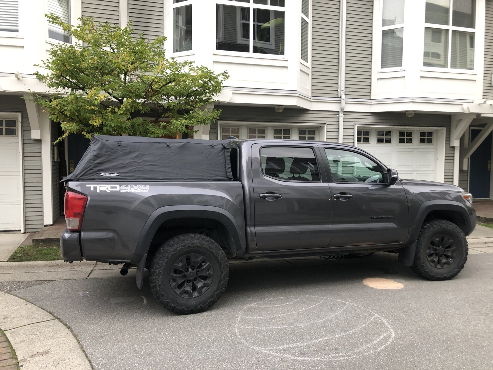

    Pic for attention :)

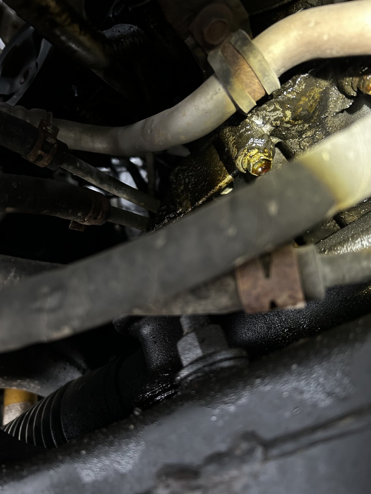

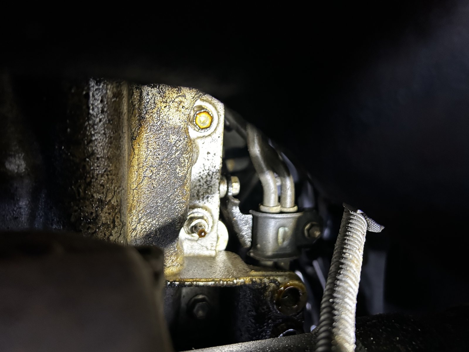

    Managed to take my skid plates off and take a better look underneath. First time doing it, so wasn’t exactly sure what is considered normal but I did notice some oil in a few different spots, as pictured. Any cause for concern?

    Take it to the dealer pay for a full inspection of the vehicle.

    Wow that’s at least 5grand minimum dealer repair

    @Mallcrawler20, I’ve got it booked in for a 160 point inspection and will mention I took the skid plate off and saw this.
    @bulalo, can’t tell if there is sarcasm here or not. I’m not the most mechanically inclined but just trying to cover my basis because I’ve read about the timing cover and rear main seal leaks being common on 3rd gens.

    Not sarcasm but that’s what’s mostly it will cost to repair when out of warranty . Better have it checked before warranty runs out

    Much appreciated. So you’re saying this isn’t normal and there IS cause for concern?
    This thread (https://www.reddit.com/r/Tacomaworld/s/YesVyNVqap) makes it look like it could be the timing cover.
